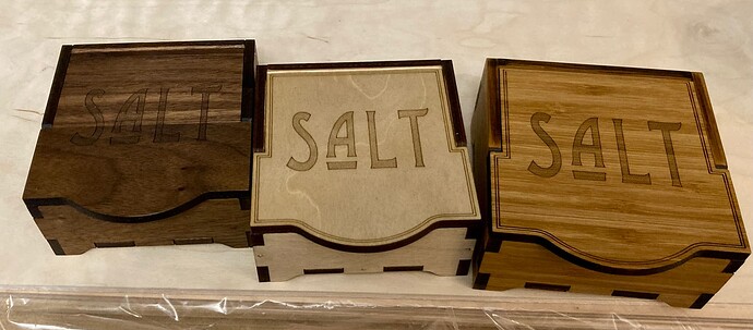

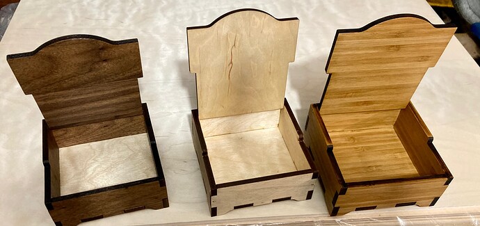

I made 3 boxes in different materials
In connection with a request for salt boxes, I have made 3 boxes in different materials. Everything is made of 5mm, BB-Aeroplay, Bamboo and Walnut. The material price alone for a box is $7.5 for Bamboo, $9.75 for BB-Plywood and $12.10 for the walnut box. For the walnut box, I have “cheated” and used BB-Plywood for the bottom. Now it is up to the customer what he chooses. In addition to the BB-Plywood which is press-fitted and decorated with brass nails, the other 2 are glued. As a hinge, Ø 1.25 metal nails are used. As a finish, I use, as always, a beeswax mixture.

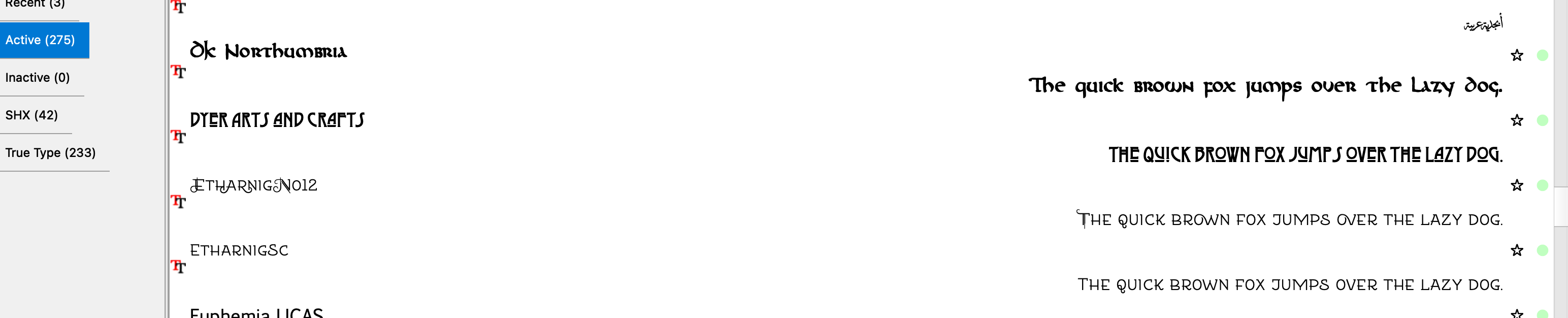

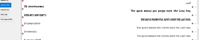

Nice font in the middle row.
“Dyer Arts and Crafts”
Ok, its like art deco..ish, very stylish and easy on the eye..as are the boxes.
Art nouveau, Art Deco, Jugendstil… I love this art genre and it also has many nice fonts. They sometimes cross over into the Bauhaus style/era.
Alphonse Mucha is one of my favorite artists from this time period. He made a lot of poster advertisements and used the finest fonts of this time.

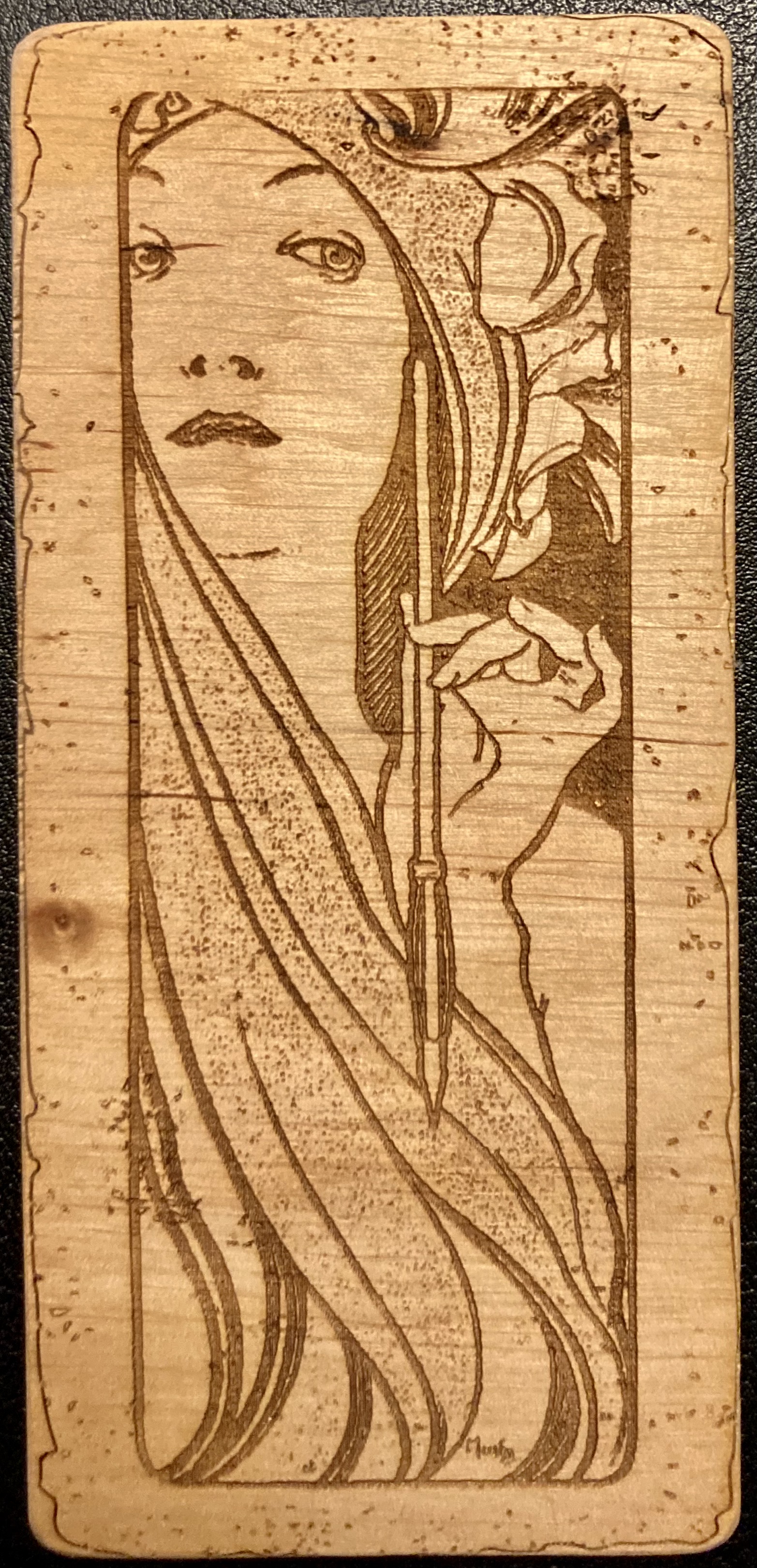

I remember these styles from watching silent movies as a kid and library books. The two pics above would be from different periods though?
No, both pictures (the last one I have "reproduced :wink: ) are from the 1890s.

Really nice! :trophy: Which one do you like the best? All great but I quite like the contrast of the middle one and the extra detail with the brass nails, although I might be a little worried that the nail hinges in the 5mm birch ply might deteriorate/breakout - especially being so close to the back edge?
I bet they smell nice too! :grinning_face:
Thank you for your comments. @Chuckphd and @NicholasL

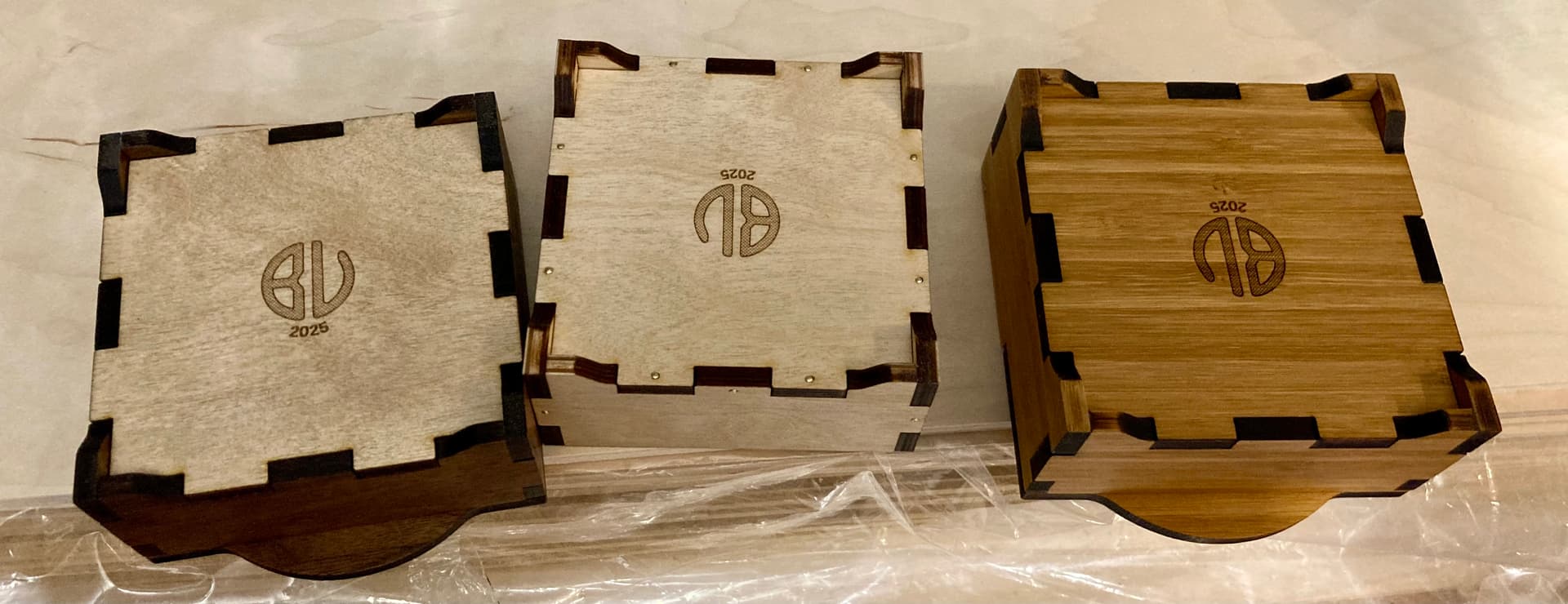

The small brass nails are a bit of a challenge. I have cut 1mm holes for ø1.2mm nails and also cut 0.75mm holes in the edges of the counterpart. With a little patience it can be done. As hinges I use round steel pins, pre-drilled in the lid. But there was a learning curve, 0.1mm kerf, which I used for the boxes, must not be used for 1mm holes…:wink:
They are actually quite robust and yes, they smell nice of burning wood, beewax and LightBurn ;-), but the salt and time will probably take that away soon, unfortunately.
I don’t have a favorite yet, I’m happy with all 3 of them.

Very cool. What are the dimensios?
The bamboo box is 100x100x47, the walnut and BB plywood are 5.566% smaller. I first designed/drawn the bamboo box which has a material thickness of 5.3mm. The other 2 boxes I scaled down in LB so they fit 5.0mm, hence the crooked measurements. That was the easiest in relation to the finger joints, I’m also a bit lazy sometimes ;-).
I’m working on another box in 6.?? mm, here I have to see if the boxes don’t get too bulky. I have made a test box in MDF 6mm, it weighs a ton and seems a bit too heavy.
Very nice. Would you mind sharing your design?
Here is a similar box in 3mm, it has slightly easier hinges, no drilling required…
Note, you have to decide on the Kerf for your machine, I always make the boxes very tight, but if they are to be glued with wood glue they should not be so tight.
LB-SaltBox_backup.lbrn2 (56.5 KB)
