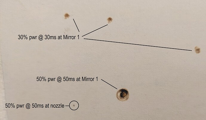

A friend of mine (some 25 years now) bought a new Mishi 150W CO2 laser about 6 months ago. He owns a small sign shop and wanted to add a laser to his “tool kit” of machines. I begged him to call me before he fired it up so I could make sure it was done correctly. It’s now too late, and he’s damaged it, I’m just not sure what’s broken. As the picture shows, the beam pulse at M1 shows an oddly shaped burn, with nothing at the nozzle (30% pwr, 30ms pulse duration). The last pulse was done at 50% pwr and 50ms, and although there was a mark at the nozzle, it didn’t go through. The power supply doesn’t have a current meter (I’ve ordered an analog 30ma meter to bring with me on Monday when I go back to his shop). Also, I realized as I was shutting everything off that the chiller was reading 28 degrees C, he had never set it up. My guess is that the tube is bad, possibly from running it at room temperature (in Florida) at 85% power trying to engrave a 6" square block of text (his logo), multiple times. Is there a test I can do to rule out the power supply? With the ammeter hooked up, what could I expect to see from a bad tube? A bad power supply? I know I’m asking a lot on very little information, but I just want to avoid shotguning parts until it works. I would really appreciate any advice you can offer.
Opinion: The tube is toast and the power supply is fine.
For a 150 W CO₂ laser, a 50% @ 50 ms pulse should punch right through whatever you’re using as a target at M1. The fact that it produces cute little rings says that it’s not operating in TEM00 mode, which means it’s wrecked.

Ed, just wanted to give you an update. I went back to the sign shop a few days later, got the chiller set up correctly, and once it was at temperature, started a basic alignment procedure to show him the tube was bad. It wasn’t. It was way out of alignment. With the tube running at temp, I was getting a pulse that was high and right at M1, but I had a good TEM00 burn. After several hours of adjusting the mirrors (I found out one of his employees had tried his hand at alignment) it came down to getting the beam centered on the very small nozzle opening. I was getting good pulses at all three targets but nothing out the nozzle, turns out it was hitting just inside of the opening. After five hours of “iterations” (as Russ would say) we had a very nice, strong, pinpoint dot on our scrap piece of wood. I bought a milliammeter to bring with me and the current draw was within the range of what I would expect for the small test engraves we were doing. I made some custom-built target holders and targets (based on Russ’ design) and I’ll be giving the laser one final four corner check before washing my hands of it. We’ll see how long it lasts.
Truth: I’m glad to be wrong!
The picture showing the burn at Mirror 1 remains puzzling, because the beam shouldn’t have that ring around it. Perhaps there’s so much power available that even the fringe area’s mojo will char the paper.
What does the beam look like now?
I’ll use this as justification to recommend starting with an alignment, before assuming the tube is toast based on all the evidence so far. :grin:
I’m going back on Monday to recheck all the adjustments we made on the 16th; I’ll make sure to document everything. I have to say I’m just as surprised as you that the tube appears to be okay. The sign shop employee told me that he only ran it for a few minutes each time and only for a couple times before sending up a distress flare. It’s not my machine, but I felt bad that I was going to have to deliver bad news, and so happy when I didn’t.
I’d be interested in seeing a fresh M1 test if you’re able to get one. Curious if the original was an anomaly.
