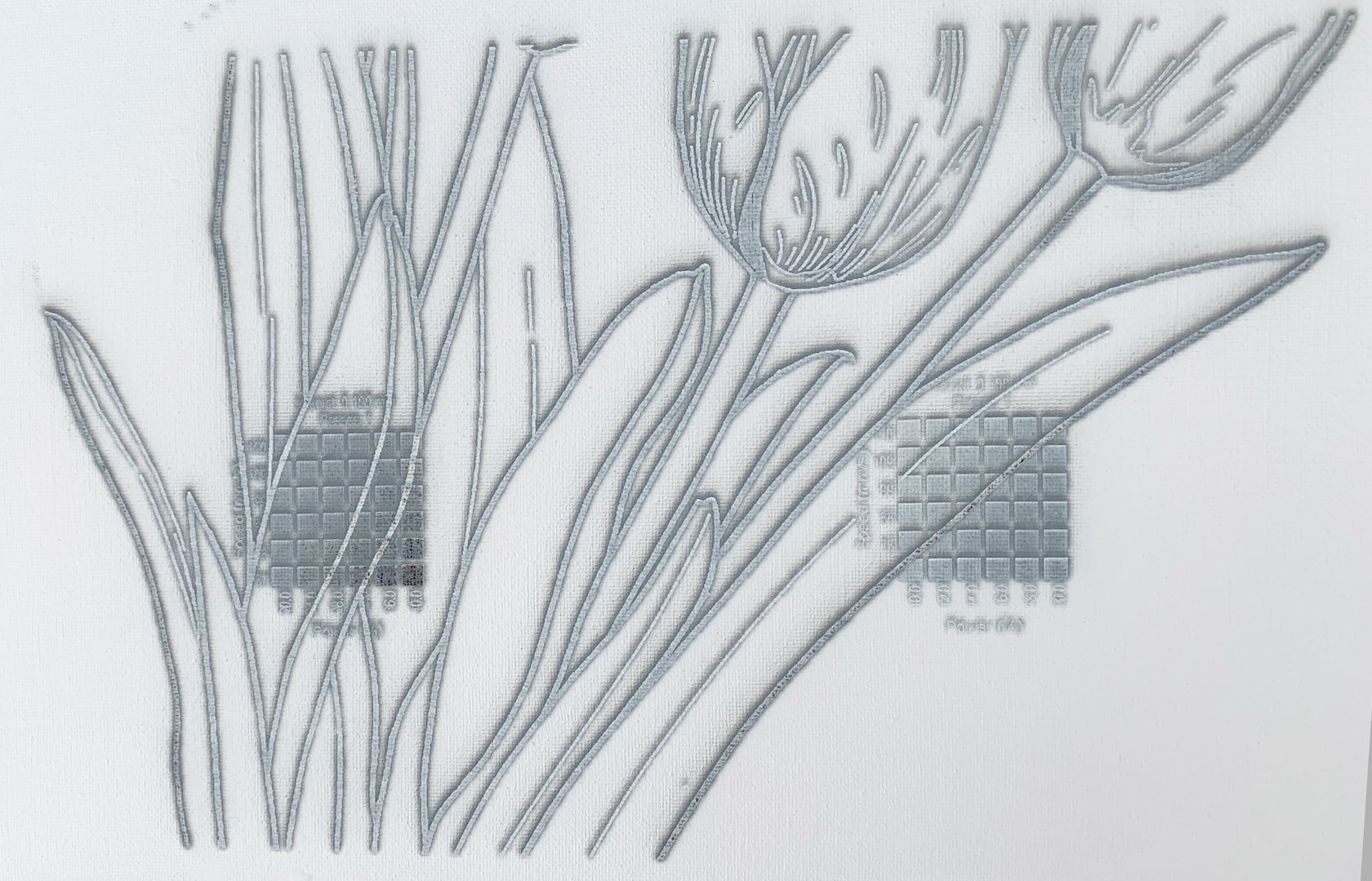

I’ve been trying to engrave a high-res line drawing on a canvas that I primed with acrylic and I can’t seem to get a clean drawing. Equipment is a Xtool D1 frame with a 20W upgrade and a Devil1 GRBL controller from Geeks at Large. This is a test I ran after running a couple of materials tests to get my settings. I also checked the focus and it is set correctly

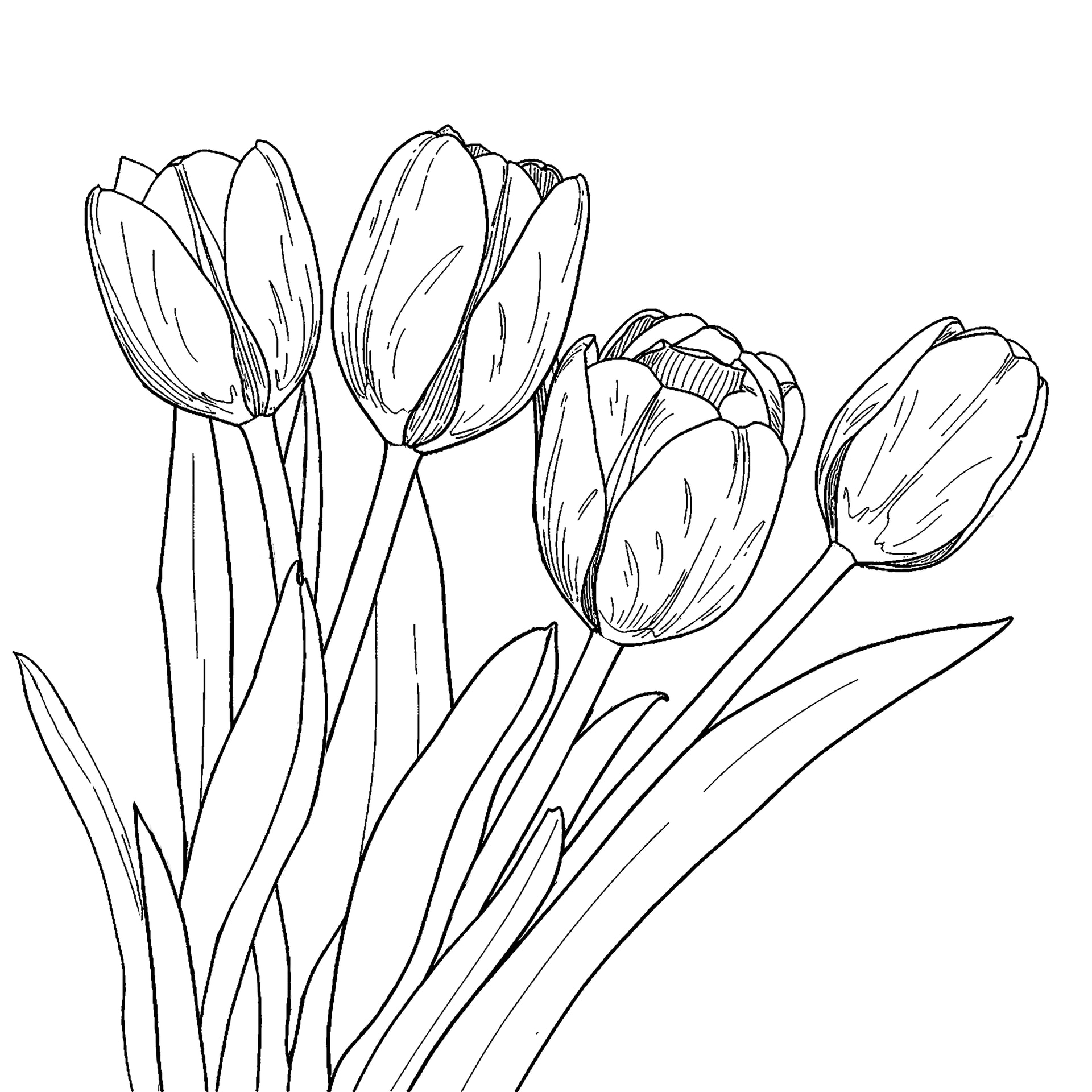

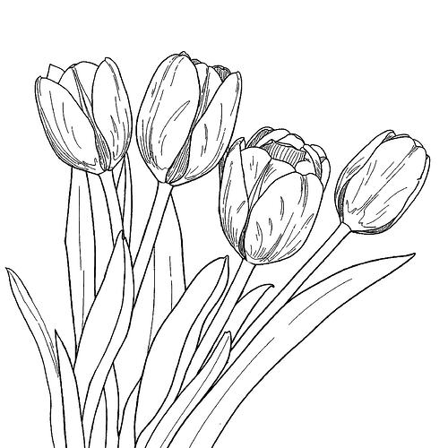

This is the 300 dpi artwork I created using Adobe Firefly Gemini and Photoshop to simplify the drawing and to make sure the lines were pure black and the background was pure white.

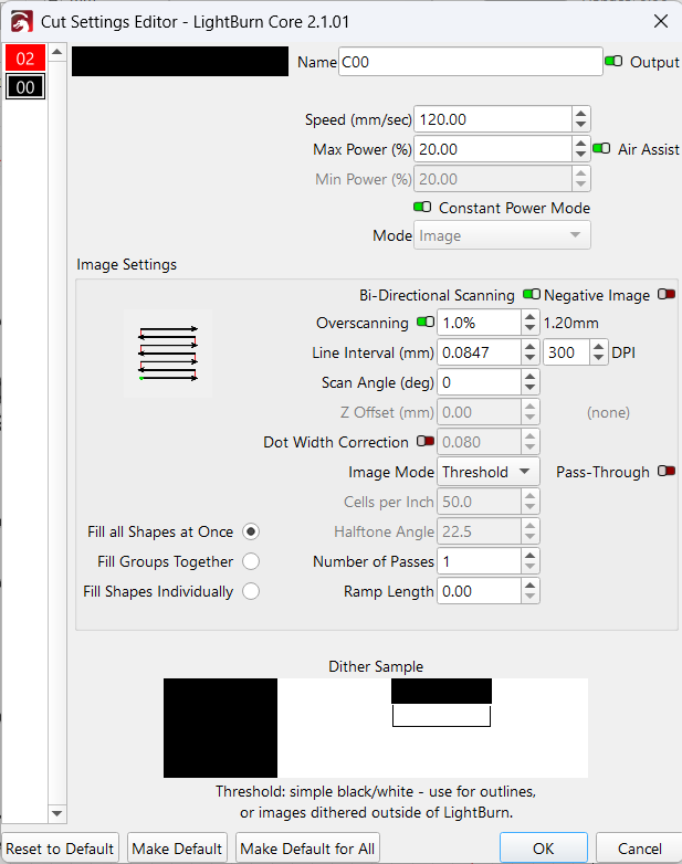

Here are my engrave settings

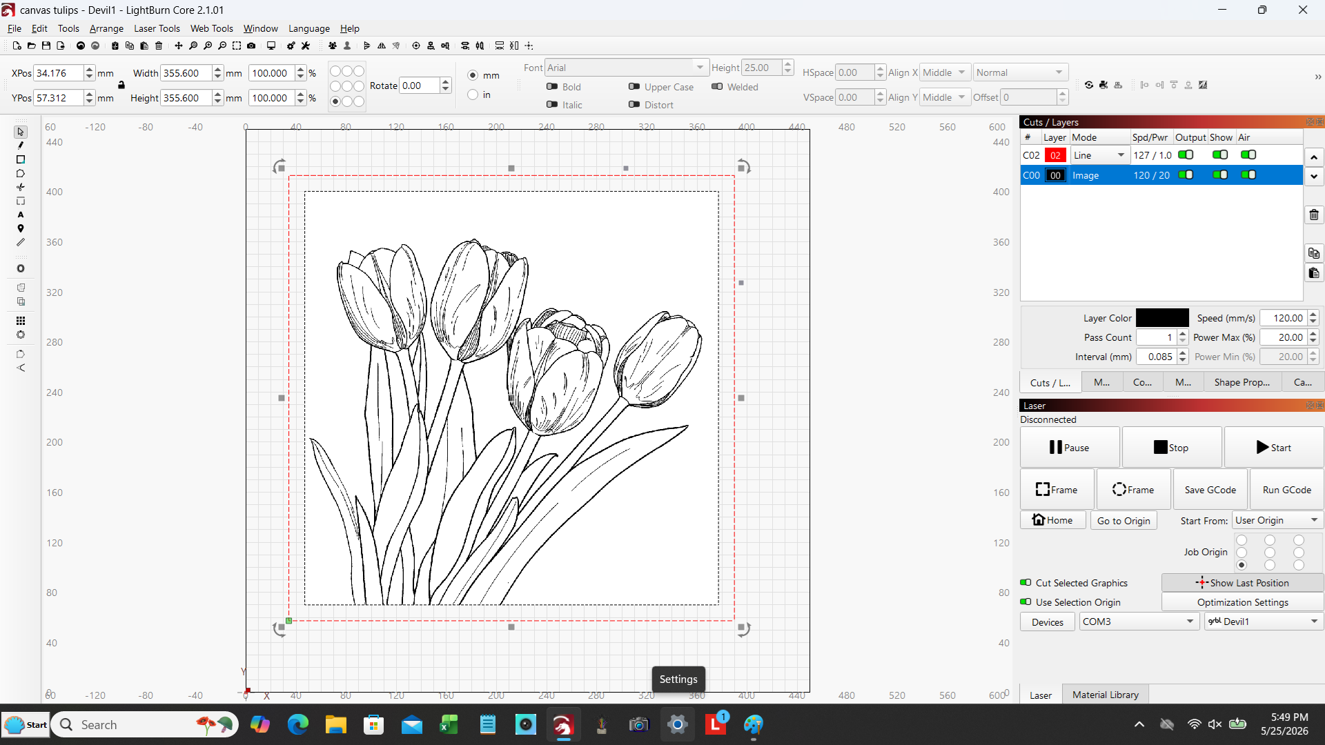

And finally my Lightburn desktop
What do I need to do to get a burned image with a single black line as in the original artwork instead of the two lines on either side of a space where the engraved line should be as seen in the first attachment?
The keyword is “center line trace”, which LightBurn doesn’t have and Inkscape (among others) does.

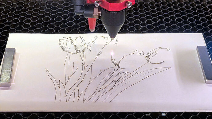

Many thanks. This got me to about 95%. This was cut at 100mm/s at 20%.This drawing was done on a 14 in x 14 in (356mm x 356mm) canvas that was primed with a thin coat of acrylic paint.
I’m preparing some more canvases so I can do a proper materials test. The first try worked but the lines are way too thick for my purposes. These lines are about 2mm wide. I’m hoping with increased speed and/or lower power that I can get finer lines more like a pen and ink drawing than was done with a regular sharpie.

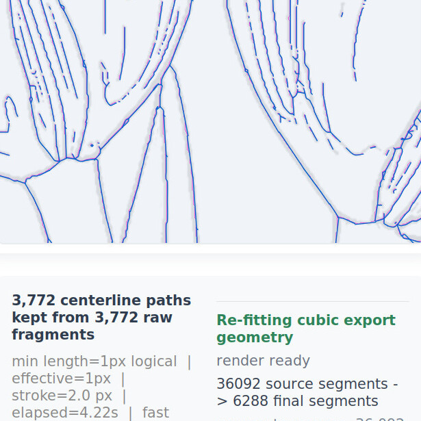

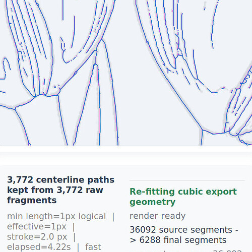

The intent of “tracing” the image is to produce a single vector running down the middle of the somewhat wider line, as shown by the thin blue lines:
That took a bit of fiddling with the settings while looking at the preview to get everything connected.
Download the resulting SVG file:
Import it into LightBurn, put it on a Line layer with suitable speed & power settings, and Fire The Laser:
You can get somewhat smoother results by fiddling with LightBurn’s Optimize Selected Shapes tool, but that’s in the nature of fine tuning.

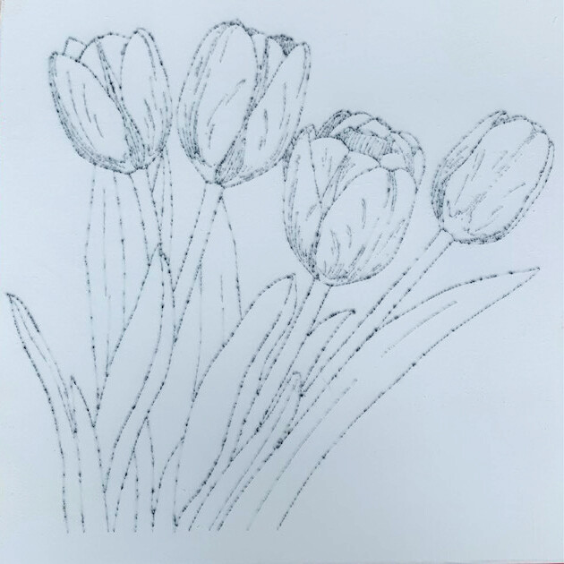

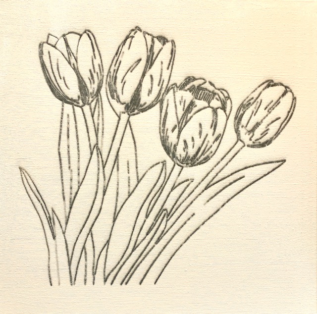

I ran several tests and I’ve decided that the problem is trying to score canvas stretched on a frame. The same tulip svg file worked fine when scoring a piece of birch plywood. I tried two different paints to coat the canvas and both scored 1.5-2mm lines. I tried each of the two svg files uploaded one at 15% and the other at 10%, The lower power at the same speed came out darker and slightly narrower that the higher power.
I did some searches and there was a suggestion that the laser vaporized the paint rather than burning it. I’m going to try again tomorrow but with a piece of plywood flush against the back of the canvas fabric. Maybe it will help trap some of the heat from the laser and burn rather than melt of vaporize the surface.
Thanks for all of the help.
Here is the result of placing a piece of plywood under the stretched canvas fabric on the frame. To ensure good contact the plywood was taller than the internal recess of the frame. That ensured that the top of the fabric was level and slightly stretched. The darker spots occur where the ends of two lines come close but aren’t connected so that area was burned twice. It actually looks a lot better in person. Thanks for the help. The centerline trace was the key to getting this to work.
