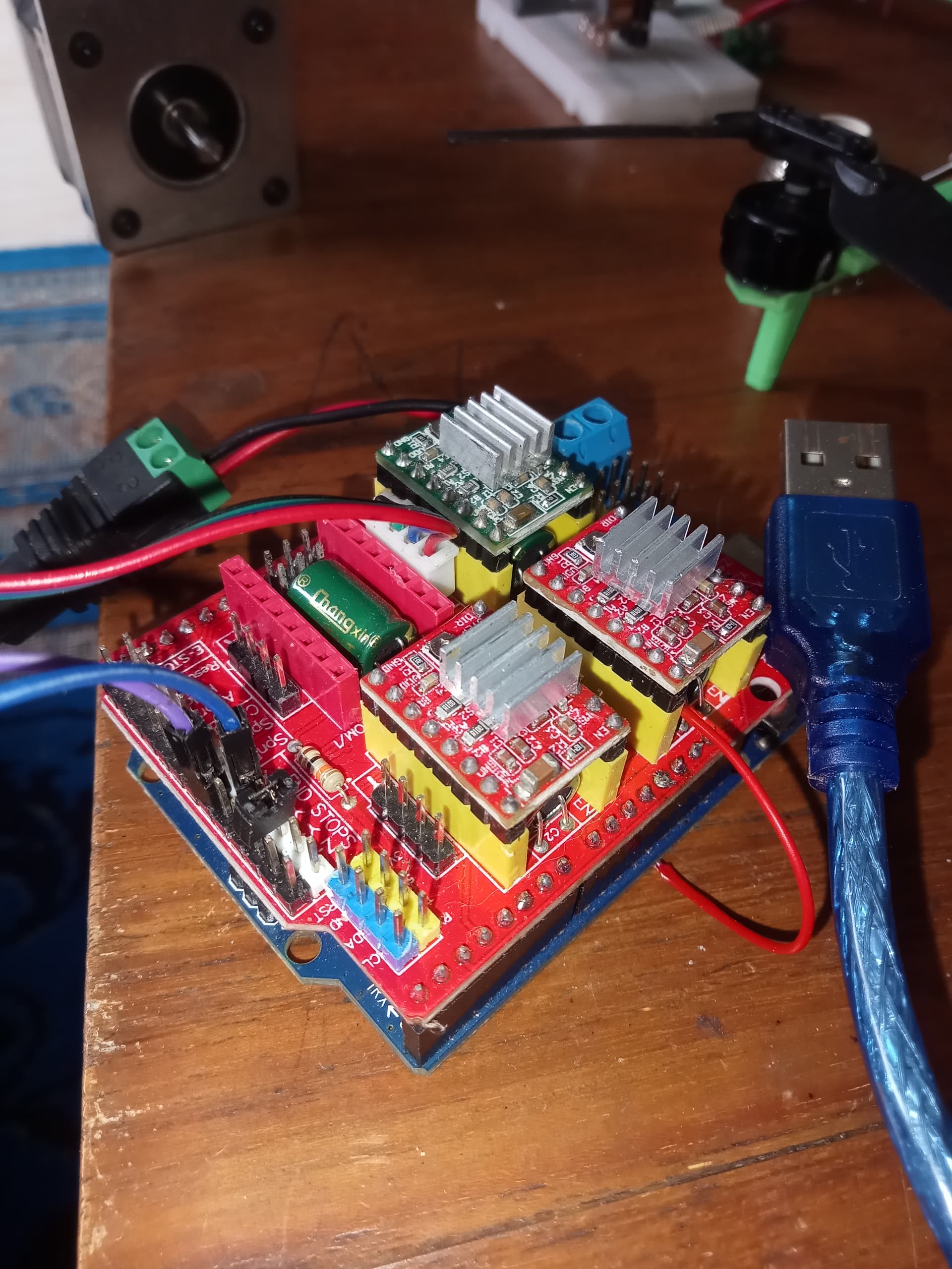

I need help?! I tried GRBL setting $22=1 for Homing (I Enabled it) But for laser only X and Y are needed right?? But… when I activated it, Alarm 9 appeared. It said “No Limit Switch Detected” then I looked for the problem. I opened the “Config.h” file, then I read that the Homing was done from the Z-axis. My GRBL or my laser only needs X and Y. I changed the configuration (I deactivated the Homing Z section in VSCode then I saved it) Then I compiled it in Arduino nothing changed. Can anyone help me? I checked the wiring and everything was fine. I used the NC (Normaly Closed) limit switch and then at $5=1 then I checked the “?” on the console and the comment “PN : X” or “PN : Y” worked Normally when I pressed it. This also applies to $21=1 (Hard Limit) when the stepper motor is running and I press the limit switch. The motor will stop and an alarm will appear. That means the switch is working normally, right?

Previously I had changed the configuration (File "Config.h) in the Homing section, the first was the Homing Z section then followed by Homing X and Y. I’ve actually already flashed the XY Homing Firmware on the GRBL Laser. However… When I tried the PWM setting, the laser couldn’t be adjusted. The laser module could only fire a small amount of power.It was probably only outputting 5% of the power. Then I tried adjusting the potentiometer on top of the laser module, but it didn’t respond. I was sure it was broken, as the laser module was quite old… Lol… Well… For a while I wanted to try doing Homing but it couldn’t work at all. Even when I put the Limit Switch on the Z axis, it managed to do Homing,Then I pressed the limit switch, the Z-axis stepper stopped for a while, then I tried the X-axis (I didn’t have a stepper motor for the X-axis before, when I pressed it… “Homing Fail”)So it looks like I’ve followed your advice. But… I will try again
