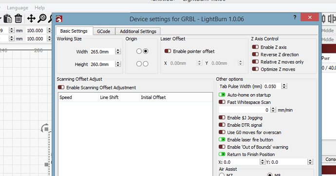

LOL… no wonder 0,0 didn’t make sense to me. Jogging controls work as they should. Left is left, right is right, up and down is correct also. Homing sends laser to top right.
I just burned some text into the top left of some wood. It matched the position I placed the text on in LB.
Device settings has the origin set to top right.

Actually, can you run these commands after homing please:

Did you already run this? If so, it didn’t take. If not, then run this. Then run the $# and ? again please.
berainlb:
G10 L2 P1 X-530 Y-520
If you already did then rezero first and then try it.
G10 L2 P1 X0 Y0
But I’m still wondering why positive numbers would have put you to the front left. Anyhow, try again please.
