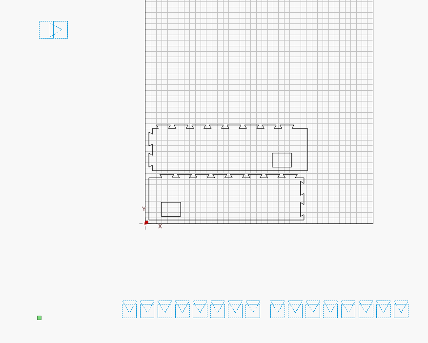

I am using User Origin, bottom left, as usual, but for some reason when I try to frame the laser goes up and right toward the middle of the bed and runs out of range of the laser?
I’m guessing I have a setting screwed up maybe.
I have Set the User Origin to the position wanted as well.
Final Lockdown Tabs.lbrn2 (28.2 KB)
Any help would be appreciated.

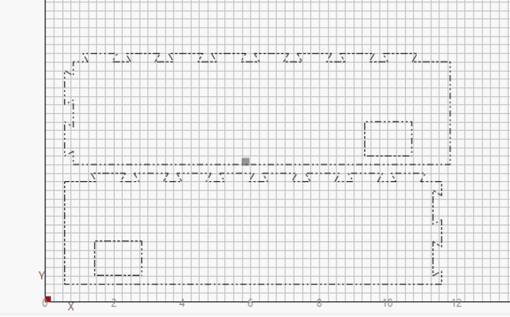

You have other ites on the screen affecting the origin location. Note the green square location.

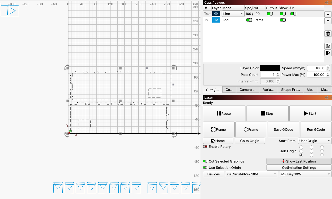

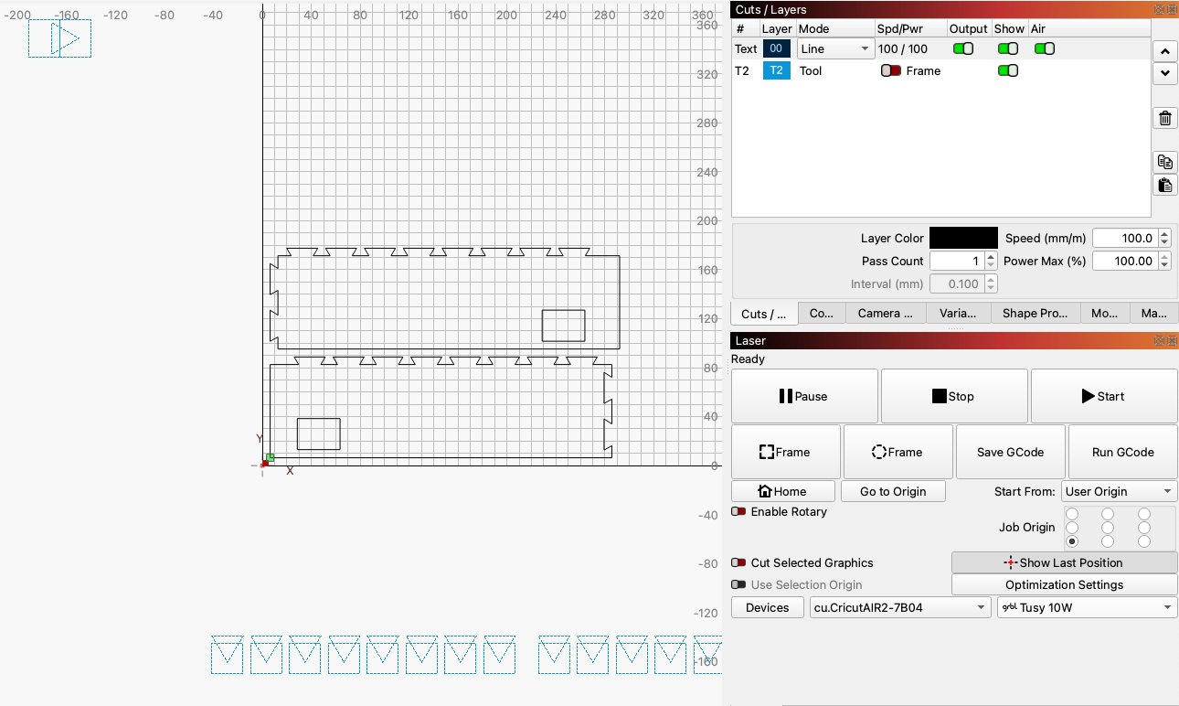

You have a couple choices to make. Either delete the tool layer, uncheck frame on the tool layer or enable cut selected graphics and use selection origin in the Laser panel.
Frame on tool layer unchecked.
Cut Selected Graphics AND Use Selection Origin enabled.
m
Ahhhh.. Now I see.

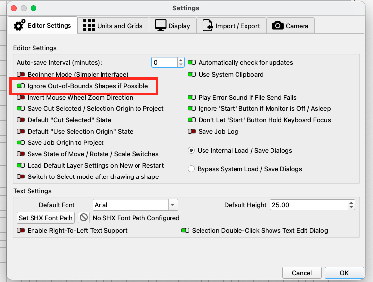

Isn’t there a way to only cut what is in the GRID? If it is off the grid, it’s ignored.
Use Absolute Coordinates and have the ignore out of bounds shapes checked in settings.
thank you, Tim. :+1:
