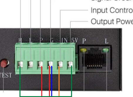

I am the author of this thread asking a wiring question, and then later on discovered a fix by reading up a ton of other articles. I think it worked a few times, but I can’t be entirely sure I connected it exactly as I mentioned, things no longer work right now. With the following connection (that I claimed to work), the laser beam would keep firing even when PWM is idle at 0V (tested with multimeter).
Even when I completely removed all wires from MKS DLC32, the laser beam would kept firing with the above connection (until I disconnect L from P). I am 99% sure that the laser PSU is broken, but I need some expert opinions before I go out to buy a new PSU due to my own stupidity.
Thanks in advance, team. :smile:

Regarding the coolant flow, I do have a sensor in place to monitor it (I’m quite nervous about damaging my first CO2 tube :laughing:). Now that I suspect there might be an issue with my laser PSU, my goal is to simplify the setup to troubleshoot and identify the root cause. That’s why I’ve only connected L to GND (to simulate the laser lid being closed) and P to GND (to simulate the coolant running – I’ve also confirmed my water pump is actually running).
I’ve tested both the “Active Low” (Method A) and “Active High” (Method B) configurations, as shown in the images below. Even with the MKS controller board completely disconnected, the laser continues to fire with just these connections. I’ve reached out to the Cloudray team as well, and it seems likely that my PSU may be faulty (or I could have misconnected something). I’m still waiting for Cloudray’s response.
What do you think? Are there other connection methods I should try? (Yes the fact that it did work before and nothing external has changed, made me think that the PSU is busted)

In your photos, unplug the signal connector to the lps.
If it still lases when the connector is removed, you have an lps issue.

Since I’m using “Active Low” approach (safer some say), we only need to focus on four ports: L, P, G and IN. Bottom right is my wiring, all without the controller board.
The Half-dead PSU
  1. I started with connecting L-to-G and P-to-G, this is to ensure the laser is enabled, and also “water protection” is enabled (this is to trick the PSU into thinking that all the safety precautions are taken, just as a test. In real world use, these must be connected to water-coolant for safety).
  2. Then I placed 20K ohm resistor at R, my intention was to pull-down the IN to 0V, removing the possibility of floating voltage triggering the laser firing.
  3. I turned on the AC to this PSU, immediately it fired the laser, there was no controller board connected at the time. So I thought to myself, this is now gone, I have to buy a new PSU :cry:
  4. Since my PSU is spoiled, I thought to myself, heck, I might as well measure the voltage between IN and G, just for fun.
  5. It turned out that IN measured to be 0.97V!! I was expecting it to be 0V because of the pull-down resistor, but that is not the case! (I’m a software engineer so I know next to nothing about electronics)
  6. So I swapped R out for a much lower resistance one, maybe even less than 10K ohm (my multimeter isn’t good enough to measure that one). Then I turned on the AC, it no longer fires!
  7. Then I connect my controller board back to G and IN (PWM), then things started working as expected! :star_struck:

It should work driving IN with pwm.
With pwm wired to the laser enable, you wouldn’t know what IN has voltage wise. With the need to pull IN low, indicates a faulty lps. It should not lase with no connection to the IN terminal.
