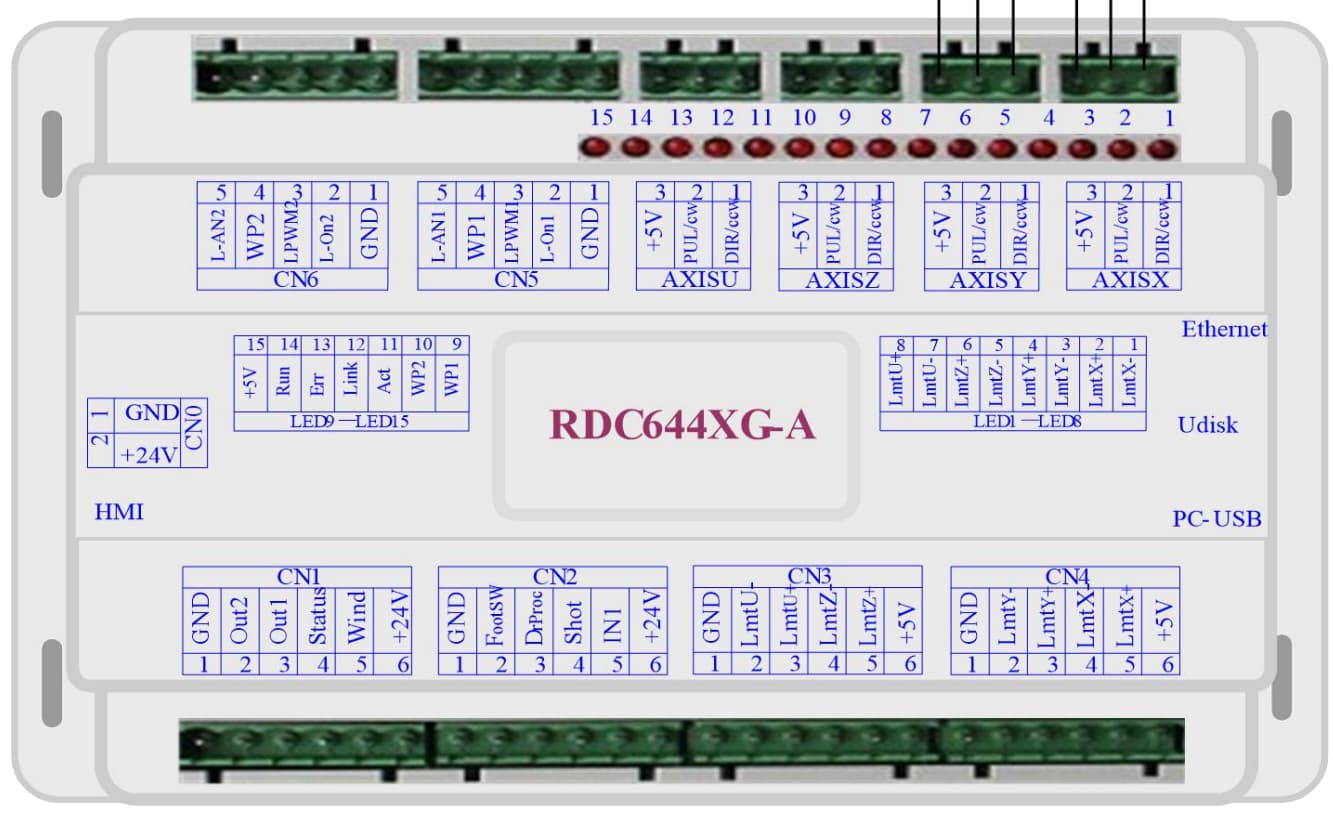

I wanna change my AWC 7813 board to a Ruida board
I’ve recently burned my AWC7813 board and would like to replace it to a Ruida board. Is this possible? Or is there any other board that can replace the AWC 7813?
I’m not familiar with the AWC 7813 but after taking a look at pictures of the connectors they seem very comparable to what would be found in a Ruida. Seems to me this would be very doable.
Do you have anything exotic on your laser that you would need to make sure is supported?
Which Ruida board you have compared it to?
I had 6442 and 6445 in mind but most Ruidas are fairly comparable from what I’ve seen.
You can compare the markings between the AWC 7813 and Ruida 6445.
Trocen:
Ruida:
Did it tell you what the in’s and out’s are? Seems to me I read about it but can’t remember…
I would think it would be a relatively easy swap… if the console and holes fit that would be great…
The Trocen manual has separate breakouts for each connector and its purpose.
