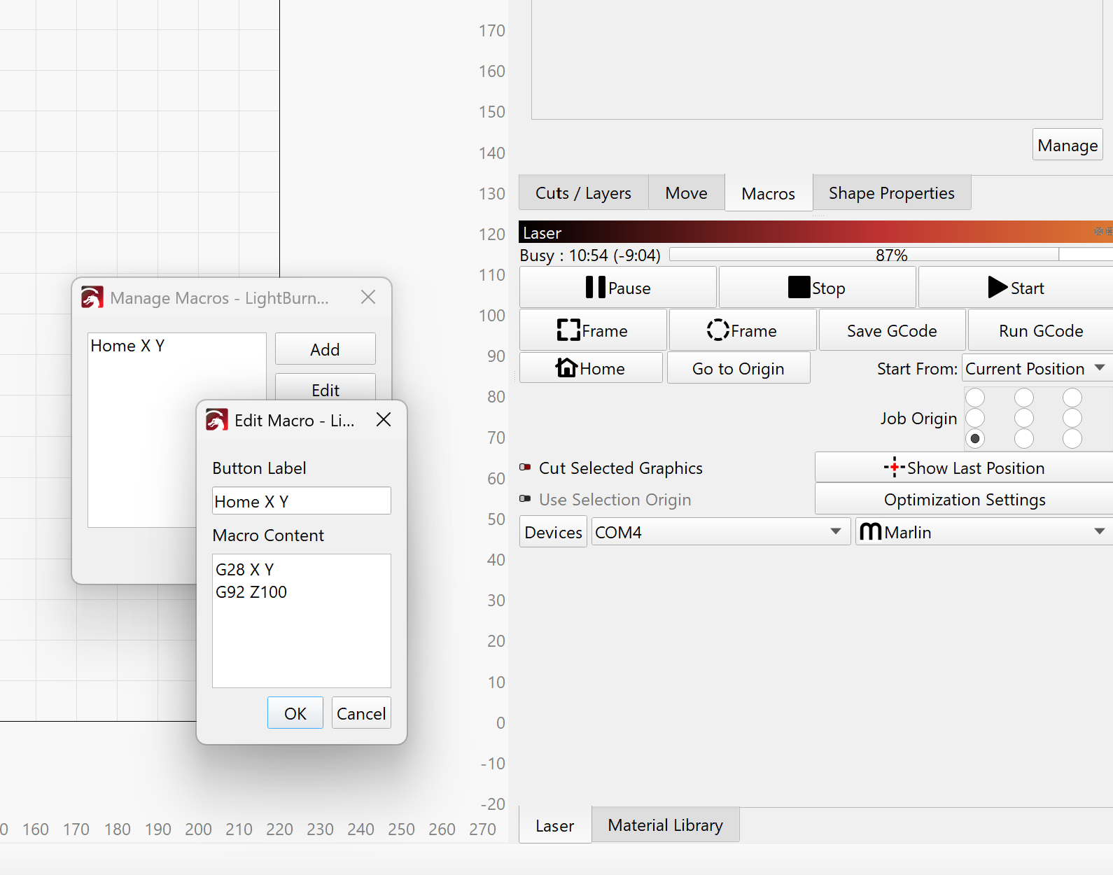

I just used the console window and sent G28 X Y and then it ignores Z.

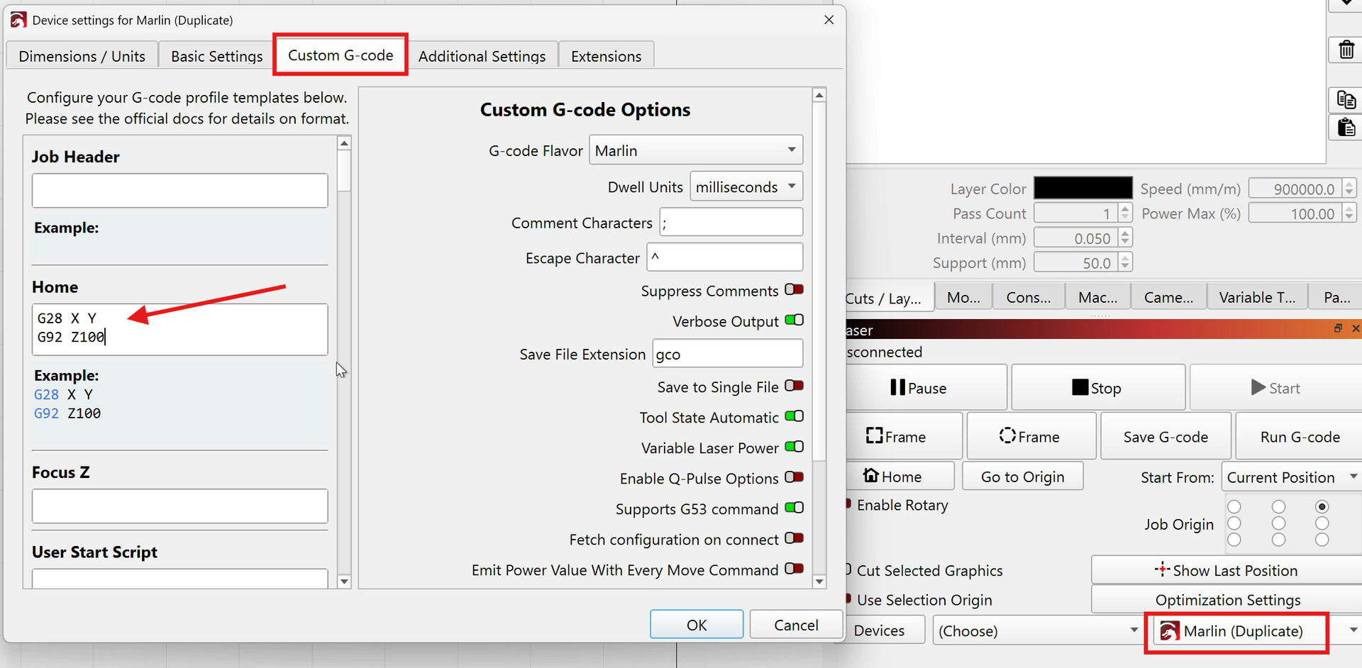

Like this i hope, will test it this evening.
Did your macro G28 X Y work to home only X and Y?

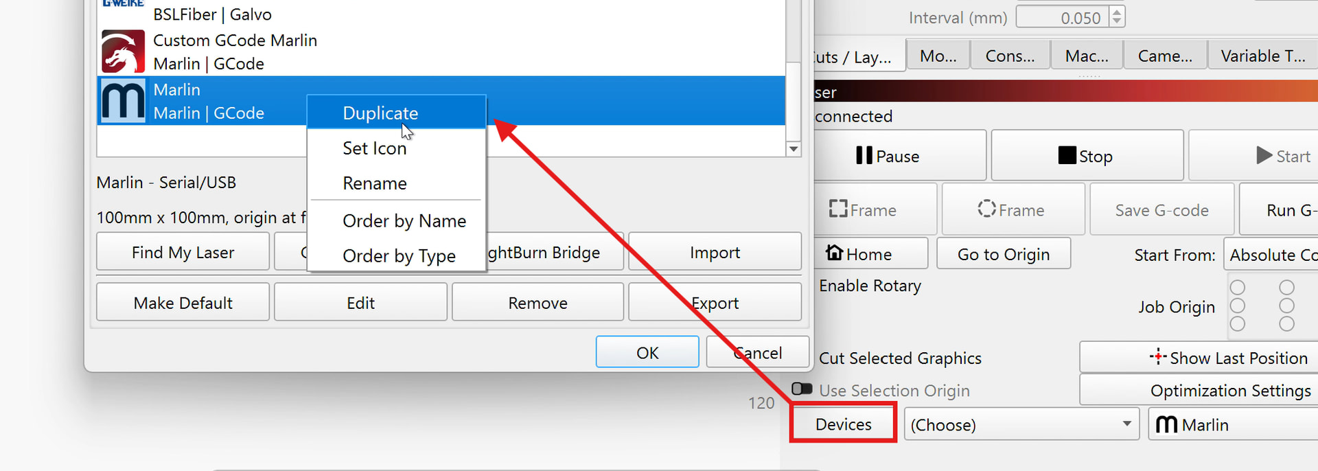

Here are the steps to convert your device profile to use the Custom GCode device type @ednisley mentioned:
Open the Devices menu, and right-click your Marlin device. Select Duplicate:

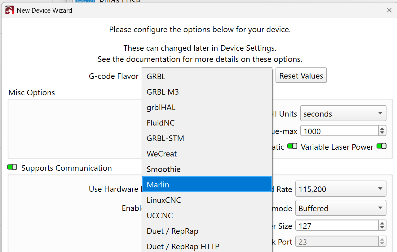

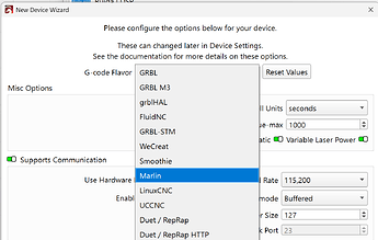

Change it to “Custom GCode” and click next a couple times.
Change the G-Code Flavor to Marlin here:
You now have full control over which commands LightBurn sends to the controller.

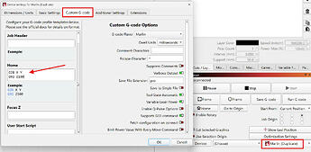

Select the newly created device and open Device Settings (F3)
Change to the “Custom GCode” tab and enter your macro code here:
That should also work for “Auto-Home on startup”.

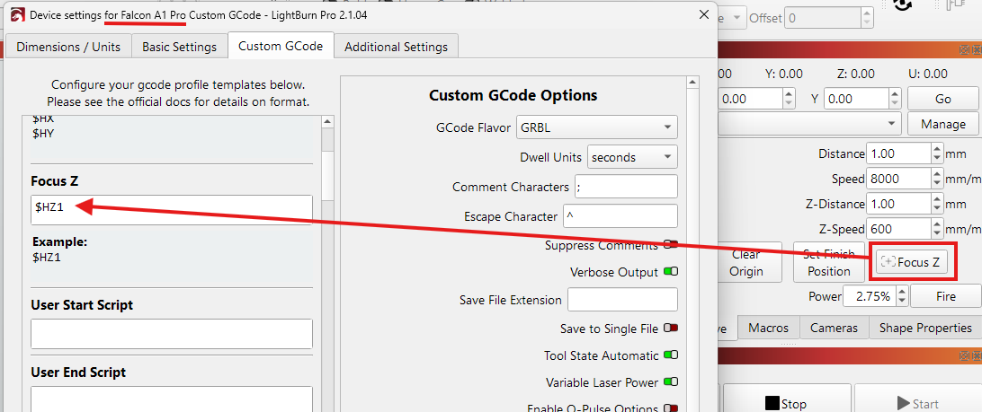

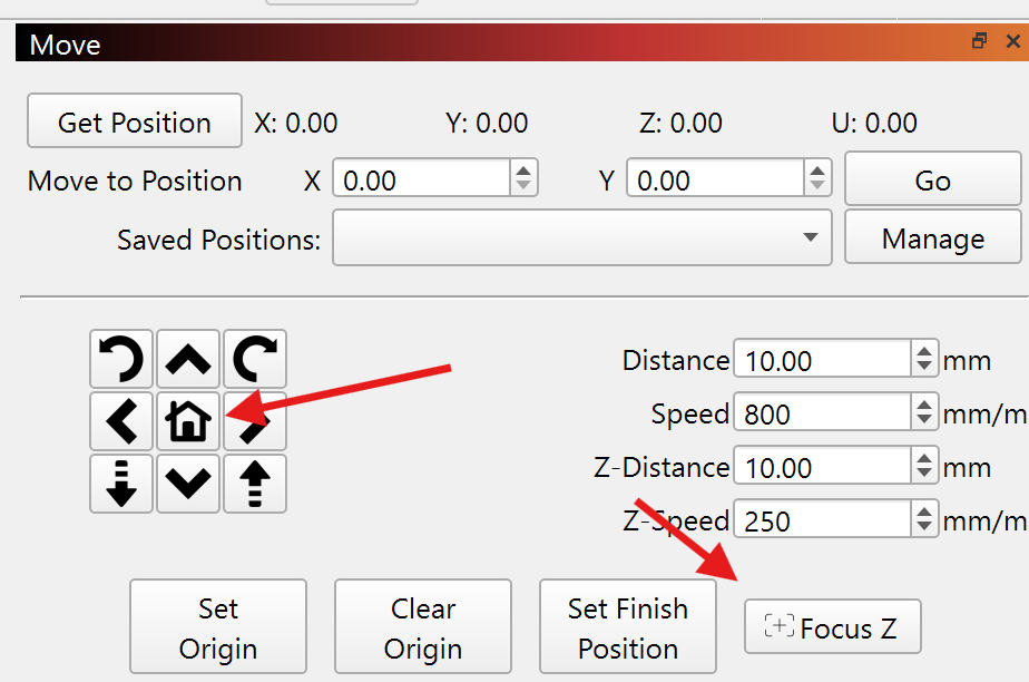

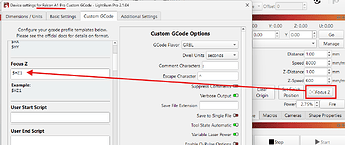

You could also enter G28 Z under “Focus Z” in the Device Settings, so you can use the “Focus-Z” button in the Move window to home only Z.
OK, back now just going to see if the macro works. The laser machine is an old 3D printer chasis, so we flashed the Marlin code to drive it. The only thing we had to do was chang the PWM for chosen output which was the fan from about 16 to 2000 to 4000 so the laser would fire.
Just connected the machine and it works as expected, x y home and z assumes the value given. If you do run home again and z has moved then it returns to what ever that 100 is, but as it has no ref it is where you last put it… So for me this is what i need. I will try the other options but for now thanks to all!!!

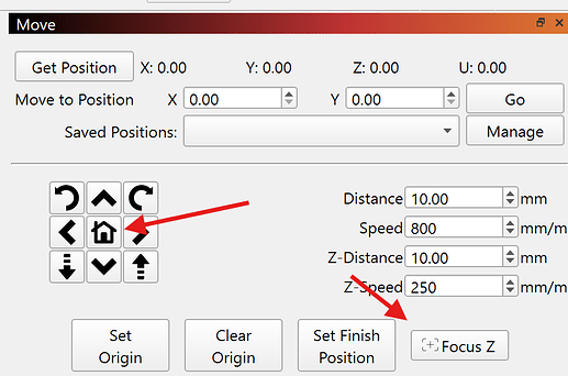

Hi, sorry, what does focus Z do? i am guessing you would use when you have a camera? Is it literally to set and focus? I have never noticed this button..
The “Focus Z” button in the Move panel sends the machine whichever command you add in the Device Settings here:
The feature is normally used to set the laser’s focus on the material surface (has nothing to do with camera focus)
I suggested (mis) using this function in your case, so you would have a quick way to home the Z axis. The G28 Z on your Marlin firmware will move the axis towards its limit switch to reference the zero point of the axis.
