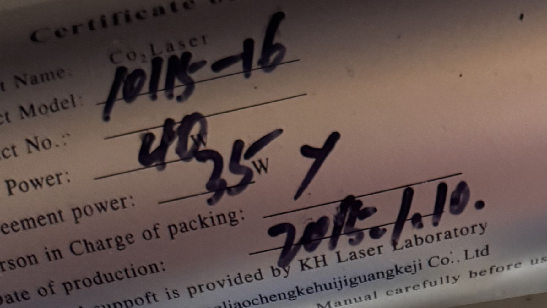

From my initial research, it looks like it’s a modified K40 with a modified controller (LightObject LO-X7 and AWC708C controller). All in all, I don’t know what am I looking at here. Is there anything that I should know about this particular lasers? Is it worth putting some effort into to get it to work?
As for its condition, I’ve ran a really quick test from an internal model and the tube seems to be working. It’s missing the extraction outlet at the back, there’s no extraction fan, no water pump and the cooling tubes seem to have been cut so there’s no passive cooling. My questions are:

First up: Do not fire the laser without cooling water flow, not even for a little bit just to see what it’s like. The mirrors at the ends of the tube require active cooling to prevent damage.
If I’m interpreting this correctly, the tube dates back to 2015:
Or it might date to 2020, which is better, but still long in the tooth.
IMO, it’s reasonable to expect the poor thing may not be lasing in the proper TEM00 mode and probably isn’t long for this world. You should certainly use the tube as-is while you get the rest of the machine working, but expect to replace it in the near future.
