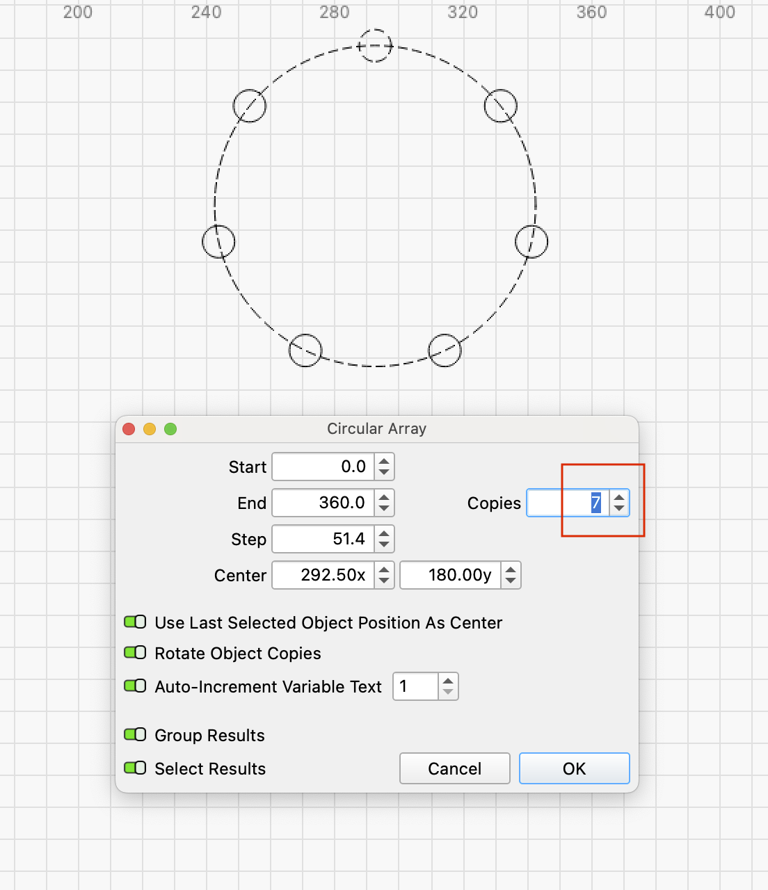

Well, we already have this nice feature in LightBurn. :wink:
(If that’s what you mean)
The first replies seem to have missed the important part of your post (which is only in the topic, not the body): in material tests.

No, I did not miss that detail. I just question whether or not expressions would work in the material test.

That’s completely correct, it’s always an advantage to be able to read :wink:
Apologies. I seem to have still been half asleep (or perhaps a bit more than half).
