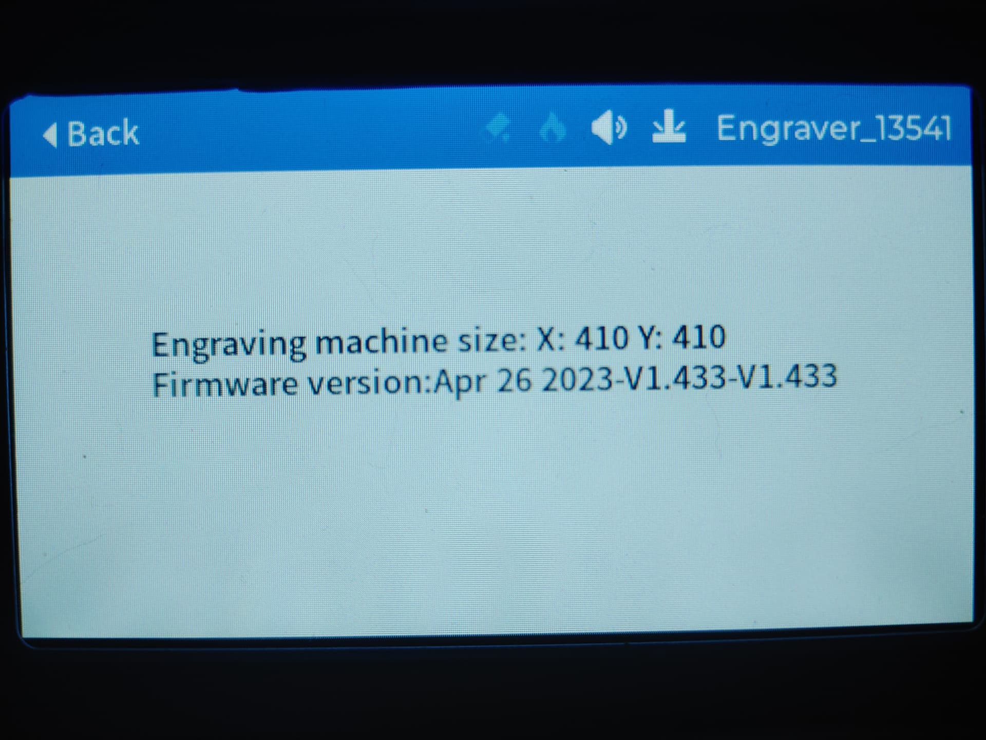

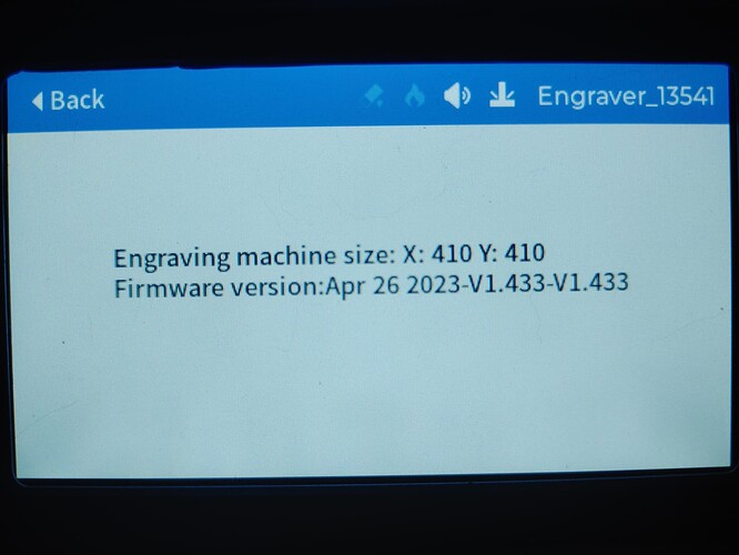

In another topic, I was encouraged to share my firmware version. This topic seemed more appropriate for it, so here it is…
Controller touchscreen reports:
LB Console reports:
