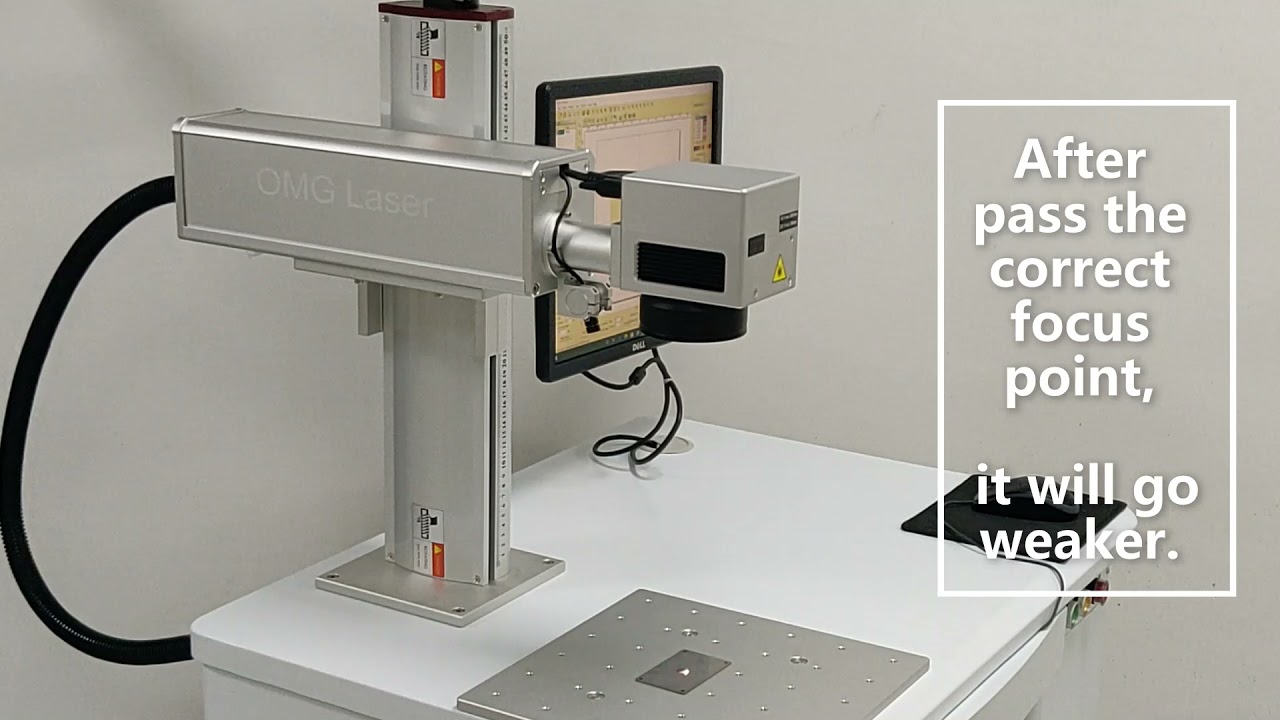

Just received my fiber laser, I have the 36watt diode unit, but cannot get my fiber to burn any designs, where and what do I need to change to get it to work. I just left the setting the same as the diode machine. manual is really screechy on the setup?
It’s likely not focused. Fiber lasers drop off power quickly because of focus…
If you’d give us some clue as to what fiber you have, this is about all I can suggest.
ikier 20w fiber, LightBurn software, cant seem to get engraving to do very well.
anodized plate, set at 100ipm, hz30 power @100% 3-4 passes before its visible
is there a $code I need to change somewhere in the configuration? my $35 blue is to “0”
Are you using the converging red lasers to determine proper focus?
There are several documented owners here with that laser who noted the focusing lasers are set wrong from the factory.
Ramp test or iterative Z offset test to confirm proper focus distance.
This usually occurs when it’s out of focus.
I’d suggest a ramp test with a gantry laser. This video is the same thing, but note you can hear the beam focus and do more damage. It’s just moving the beam with mirrors of almost no mass.
If you know the lens length, you can compute the dof (depth of focus).
If I go by spot size only, assuming lots of other things… I can produce a 31micron dot with a 110mm lens. Yours is specified as 0.03 x 0.06. If yours is a similar 110mm lens, it has a dof of about 0.894mm or less than a mm to remain in focus.
These are guesses based on a galvo fiber machine, so I could be way off base.
I have no idea what $35 is… googled it and got one hit for spindle (I doubt) and another for a $35 part.
The lower the frequency the more power… it gives the fiber more time to be pumped up, delivering more energy when it lases.
What kind of interval are you using?
Try and check the focus, I think that’s likely the issue…
Good luck
The fiber laser module should have come with a new controller as well. You will want to swap the control box with the new one. See page 12 of the manual.
Next, move the laser module up or down until the two red dots converge on your target.
The manual discusses setting the PWM min value ($35) to 0 for the fiber laser, and to 1 for a blue diode module.
I would not start with 100% either :slight_smile:
Cheers
Anjin
Also be sure to clean the lens :). The focal length is between 96.1mm & 94.1mm
