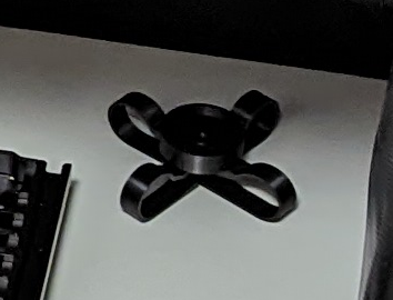

The laser is sitting in dampening feet i got from thingiverse (and adapted a bit to fit the k1 feet)
k1Feet
It sits super solid and feels very good “seated” or sitting on the table - no leg in the air :slight_smile:
When it was so loud, i also touched all the parts and it hardly became any better (except for when really hard pressing the X-axis cover, but then the laser cannot move freely anymore ;D - so thats a nono)
