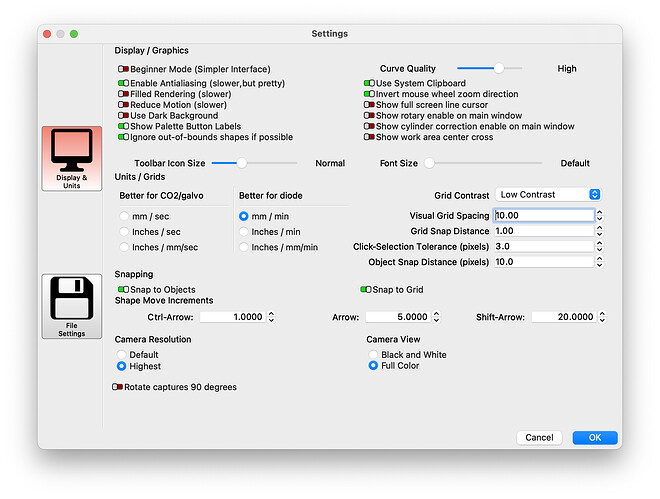

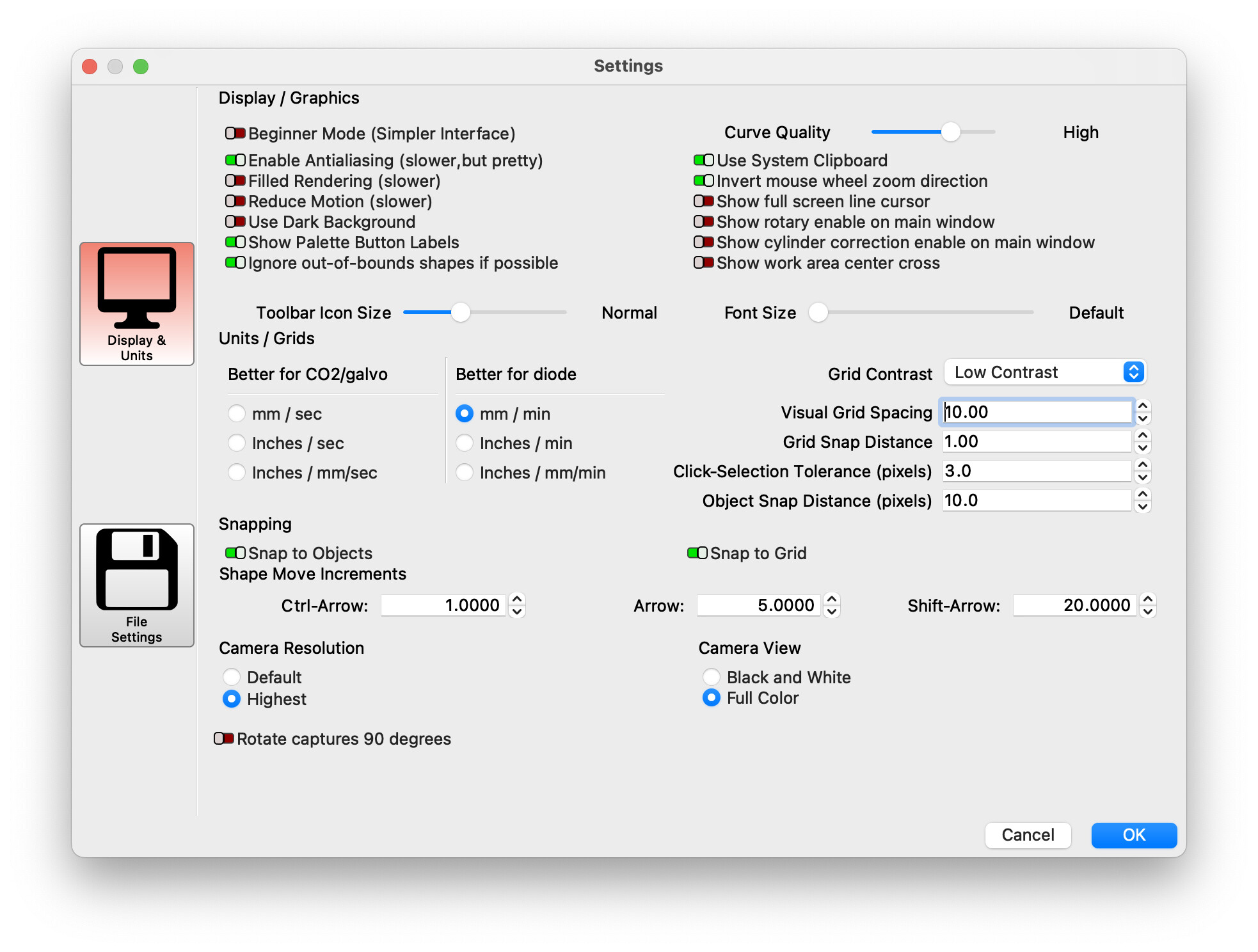

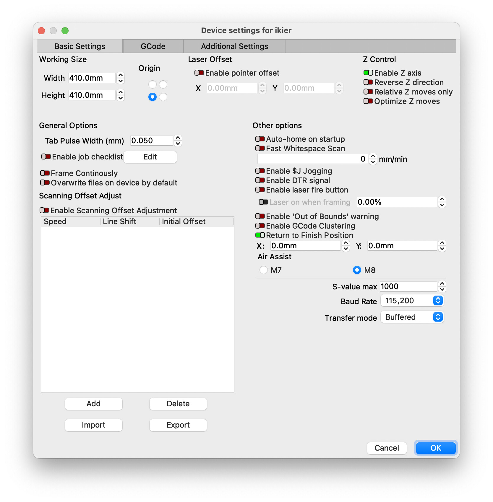

Could you please post the following
a) Edit → settings take screenshot
b) Edit → device settings. take screenshot

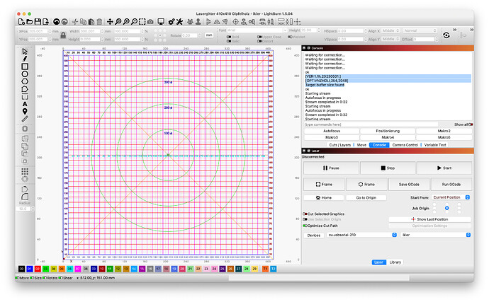

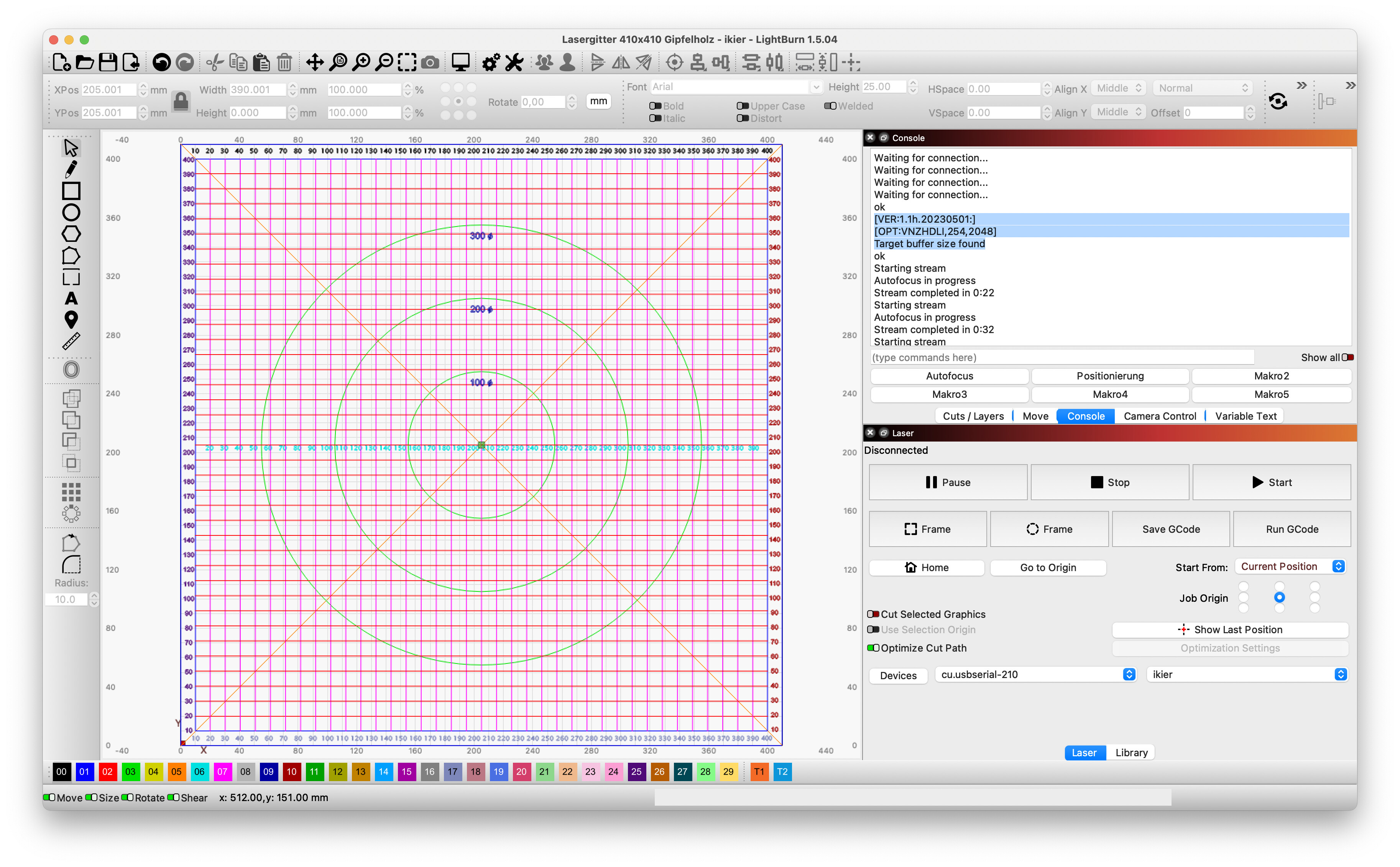

c) Full screenshot of your lightubrn with the design open please
@gilaraujo sure. here yu go:
one issue you have is you are printing a grid but using current position center. you should use abosolute coordenates so you can replicate in future
Current position has no binding to machine coordinates
The error is peculiar though, do you have configured your ikier manually, top GRBL controller yes?
yes, i configured it manually.
I changed it already yesterday to absolute but the error came up aswell. It comes up immeditaely right the second when i fire up the job.
