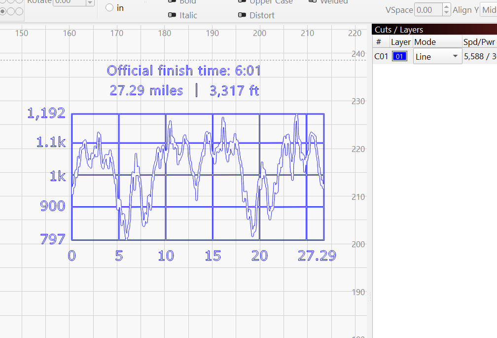

Paste copied vector elements from clipboard somehow mess up the little details in Lightburn. Imported Ai file has no issue.
LightBurn Pro 2.0.05
Created by LightBurn Software, LLC
Built on: 2025-12-03 @ 20:06:05 UTC
Adobe Illutrator 30.8.1 (64-bit)
Ai file https://drive.google.com/file/d/1GJu2W0uogpDR3tcYpyNzwvf2KtjKR52P/view?usp=drive_link
Google Docs link not open to the public.

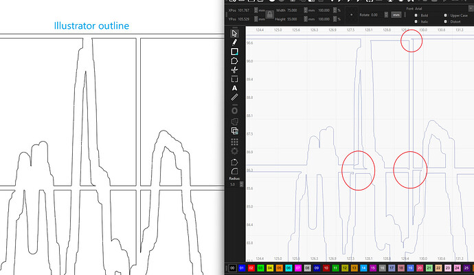

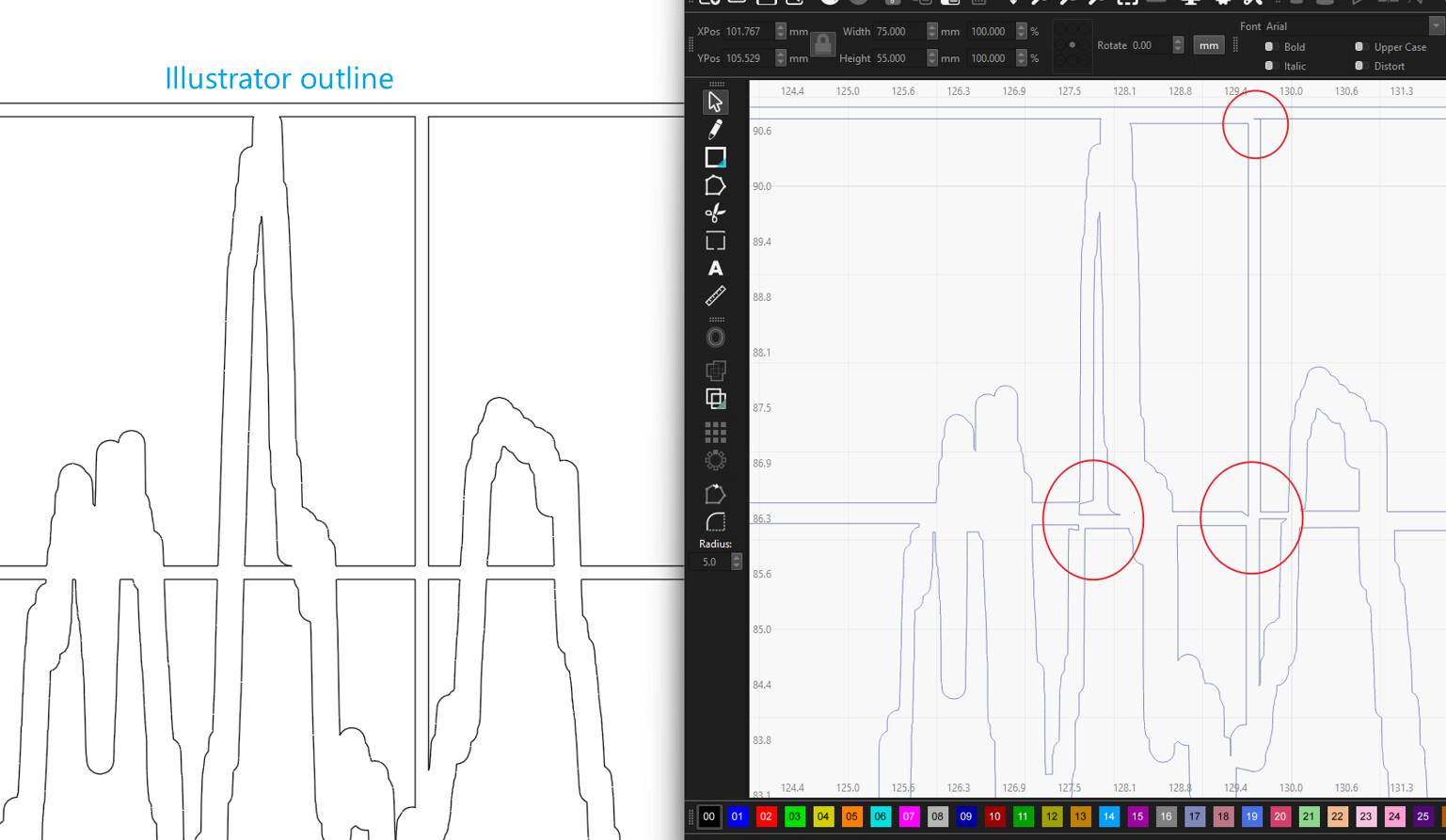

Screenshot below shows three areas, but the errors are all over the entire pasted vector element.
Vector elements are exchangeable within all vector programs, even through clipboard as long as the copied elements are pure vector. I’ve been using this method for a while and haven’t had issue until this one. Perhaps it has too many points for Lightburn? I’ve tested it with Affinity Designer, no issue there.
When working with multiple artboards in Ai, paste through clipboard is way faster than importing.

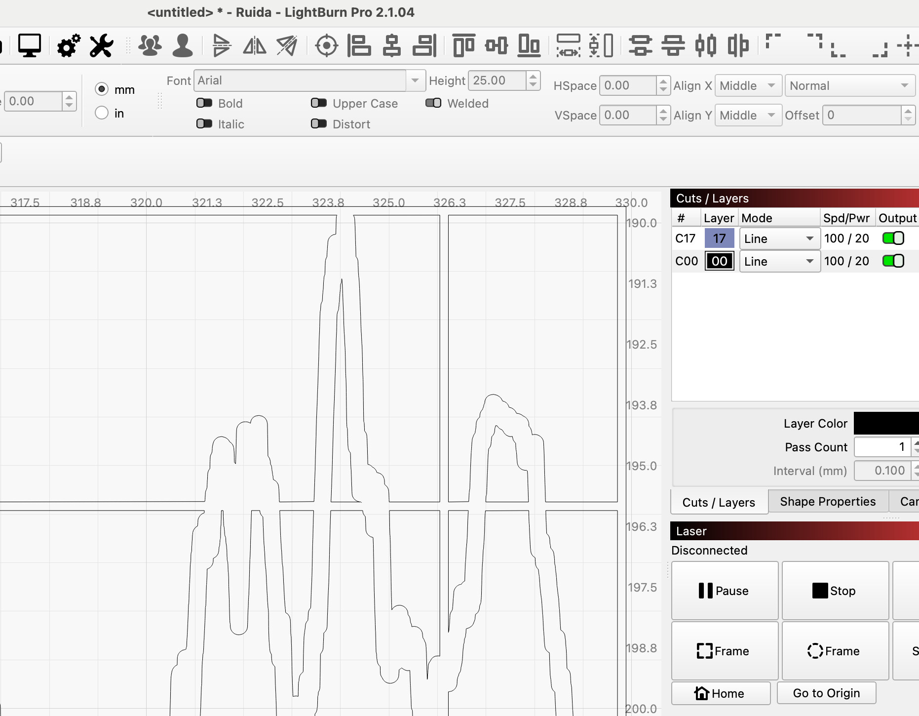

I downloaded your file. It saved in my download folder as Clipboard paste bug.ai. I then did a drag and drop onto the Lightburn grid. Below is a screen capture of the result. I am not seeing the fractured design you describe.
I tried “normal” import, there are no visible errors here either.

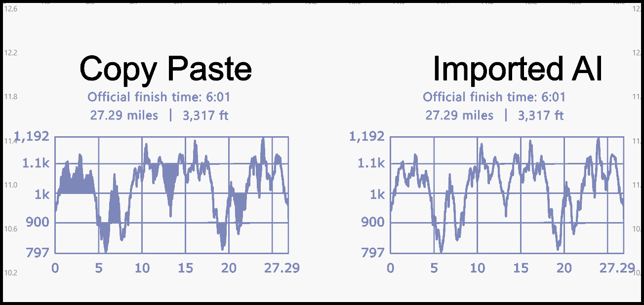

Thank you for helping out. Normal import method works fine as I’ve stated, the issue is copy and paste through clipboard. Vector elements without too many points paste correctly through clipboard. It seems Lightbourn can’t handle vector elements with a lot of points. I hope the dev team can fix it.

It fills incorrectly when you copy and paste, which uses SVG code. It looks fine in “line” mode.
My fill looked okay too, and not like yours on the Copy side.
I think what we have is the inability to copy/paste here like you are doing. I do not have Adobe so I can not start with “copy”. I just did a “copy” on the Clipboard paste bug*.ai*** file and used CTRL-V on the Lightburn grid, and I still get an accurate version. You did not send a clipboard dump, you sent an Adobe file.
I still suggest that COPY from the Adobe screen is why you are getting strange results. Windows can only copy what it sees in the graphics engine buffer, and that likely does not have the complete node information to accurately reproduce the design.
I have no explanation for why you succeeded in the past. Could be a Windows patch or an Adobe update.broke it.
