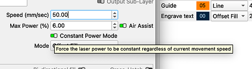

I'm confused about Constant Power Mode
To me, the message “Force the laser power to be constant regardless of current movement speed” could mean:
  1. If you enable this option I will adjust the laser output dynamically so that a constant energy hits different bits of the target, in other words when I speed up I will increase the laser power to compensate for moving faster, and when I slow down I will lower the laser power to prevent over-burning.
  2. If you enable this option I will supply the laser with a constant amount of power, regardless of my speed, so when I slow down, the target will receive more energy per unit length, and when I speed up it will receive less.
Which is it, please?
And, whichever mode it is that adjusts the laser power, does it do it according to the SET speed, or the ACTUAL speed of the laser head?
Which do people use? In theory there shouldn’t ever need to be a reason to use the mode that doesn’t change dynamically, no? It makes the most logical sense, although maybe only if it uses the actual speed, and not the set speed.
Hope this makes sense :roll_eyes:
With constant power mode on the laser power remains the same regardless of the speed the head is traveling. This is the power setting you chose in Cuts/Layers panel. Because the laser MUST slow down to make direction changes, I.e. corners, this causes excessive burning in those locations.
With constant power mode off the laser reduces the power when changing direction helping to prevent over burn in corners. This is the preferred mode of operation in my opinion.
There may be specific reasons why you would want constant power mode enabled, but I haven’t found any in my laser use.

It more or less uses actual speed. Here is the in-depth description of the firmware functionality behind it: Grbl v1.1 Laser Mode · gnea/grbl Wiki · GitHub
So if you set a speed that is much higher than your laser is capable of, the engraving will be lighter, since it never reaches the desired speed and therefore the power also stays below the desired power.

Which is exactly what Ruida controllers on CO₂ machines do. They work from the configuration values for the maximum speed & acceleration for the X axis , figure the overscan distance required to get up to the layer speed, set the power according to the layer power, and away they go.
Presumably, the axis configuration takes into account all the physical factors, but from what we see around here that is … sometimes not the case. :slightly_smiling_face:
G-Code controllers don’t have that function built in, so making it happen requires some trickery.
Yes, that’s true, but those mechanics don’t have a closed loop motor control. You never know how fast the steppers are turning in reality. That’s also why the laser never knows its real position until you do homing, loses its position very often etc.
Yes, but the firmware is very, very basic. It’s been written for tiny Arduino microcontrollers with 8bit and 16MHz computing speed. So it’s a real simple design. I think the developer would never have imagined that this piece of software will get a standard in millions of DIY devices :slight_smile: We now have newer and faster controllers, but the basic firmware has not changed (there are new firmwares out there that might support this someday, like FluidNC).
As mentioned above, that would require a closed loop system, which is not available in all of these consumer type devices. I have never seen one yet.
