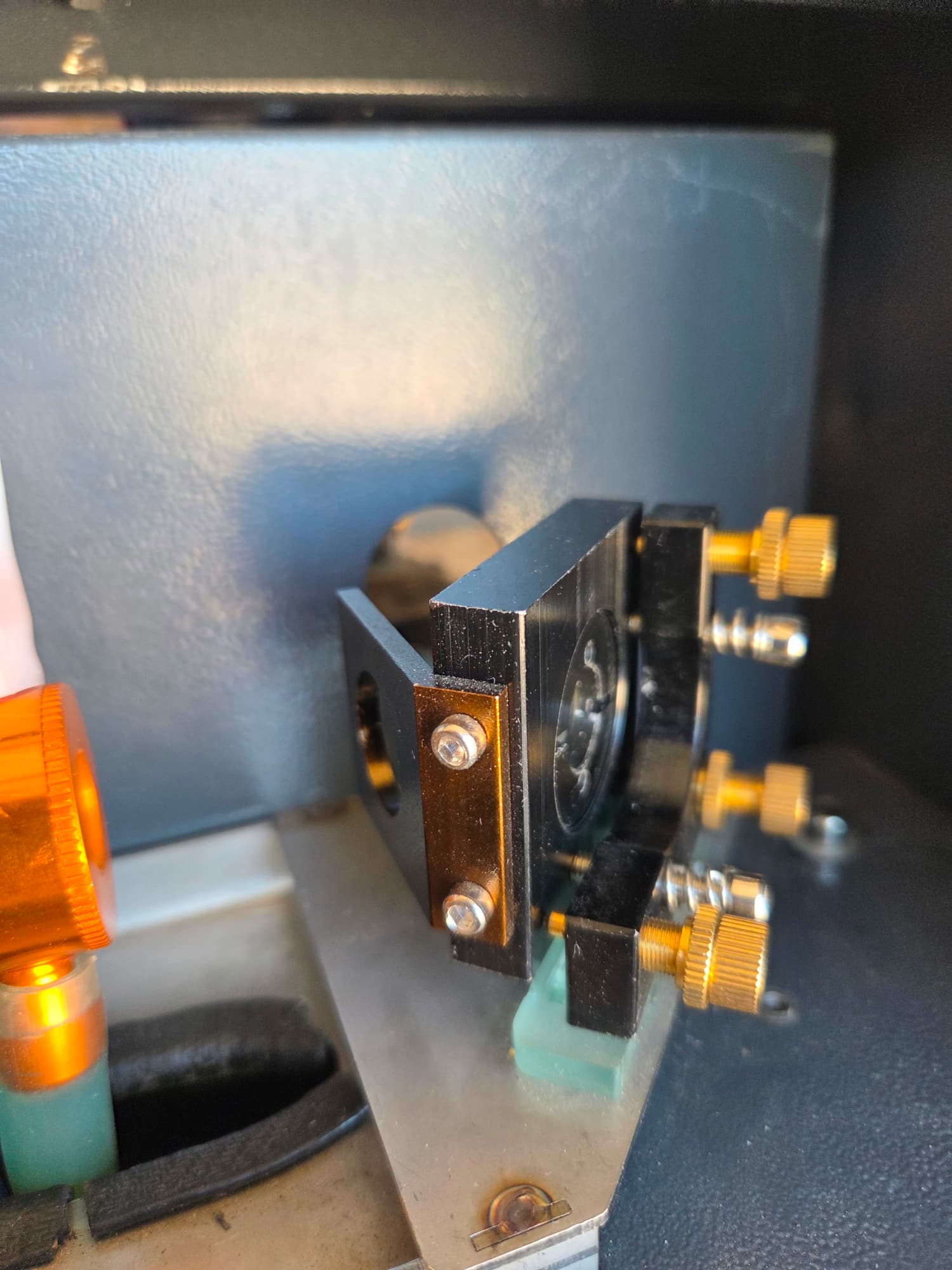

The locking nuts on all of my mirrors are not used, they are screwed up against the knurled finger end. I never use the center one, so it’s locked. You can’t possibly lock these down without screwing up your alignment. High spring pressure on a fine thread means they won’t move. I’ve run mine at 40in/s and they don’t come loose.

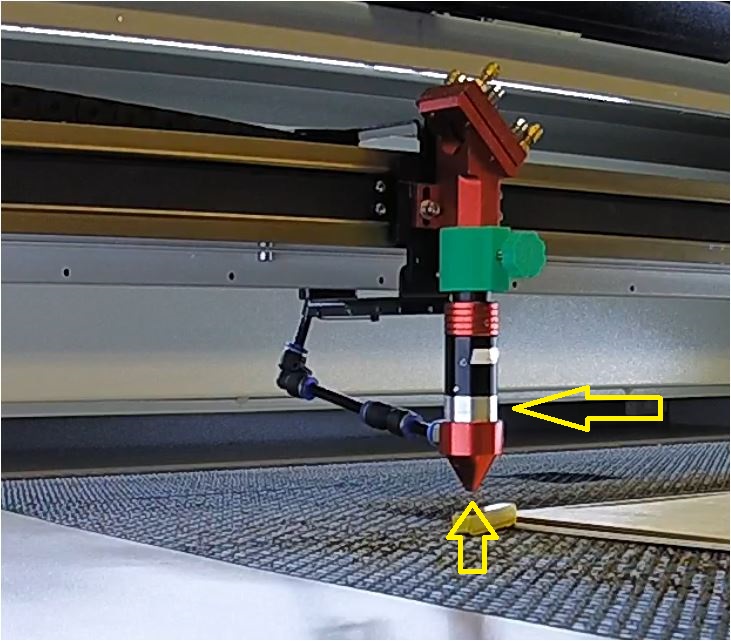

Just a last comment on my setup that I follow..
I try to keep all my Lens nozzles 10-13mm off the surface, if I need an extension pieces I drop it in…
see picture…
I also use a small oriface nozzle that helps focus the air flow some nozzles have the larger I only use this
when I have a 1" lens for cutting paper
this combination, of about 11mm off the surface (FP) and about 15psi is perfect for cutting acrylic and wood
it keeps the wood burn marks down and the acrylic keeps from flaming up for the thicker pieces that require
a slow cut…
Like when I cut 16mm Acrylic It is about 4mm/s 65% power (about 70 wts)
If found that if the nozzle is too close … well we all know things get in the way as you can see in my picture
I use 10mm square magnets and keep my nozzle at 11.5mm so it clears them just fine…
and if you are too high >13mm the air flow pressure is not as effective…
again…just my setup… but it is from many hours of experimentation and finding the sweet spot…
