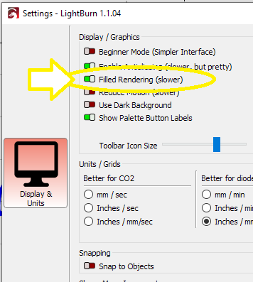

I suddenly had the same problem where my fonts weren’t filling.
I knew it was something I did in the settings. Sure nuff…
I turned this off and caused the problem
Note that “Filled Rendering” only affects how the designs are viewed. It doesn’t actually change the nature of the design. Meaning that if a shape is set to a filled cut layer but “Filled Rendering” is disabled, the shape will appear as just an outline.
The “Filled Rendering” setting in Edit->Settings is the same function that is available from choosing a View Style in the Windows menu options.
