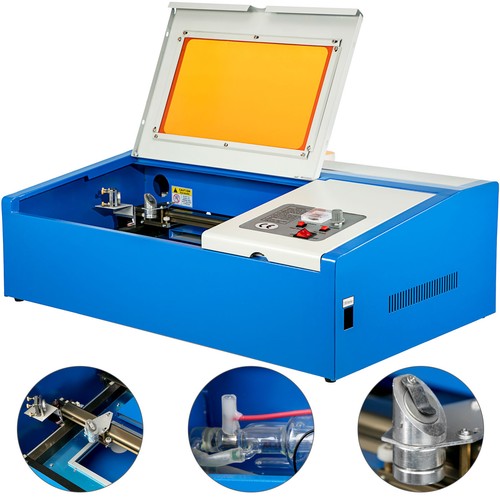

hey to alle. i want to add a 40w co2 to my fun rum :slight_smile:
and can see that lightburn is the program to go for. as it is only for fun i dont want to spendt 1000+usd on a laser. i found 1 for 500 usd but cant see or fint any info about if it is a okay starter laser. and if it can run lightburn.
Or others who might have an idea for what kind of so2 laser i should go for under 1000usd
requirements. must be usable with lightburn. and I must be able to add a camera to it
There are many variants of the K40 engraver.
If it has a 32-bit grbl type controller, LightBurn will work with the least expensive Licence option.
It’s quite possible that the engraver is equipped with a Lihuiyu M2 Nano
which will be incompatible with LightBurn.

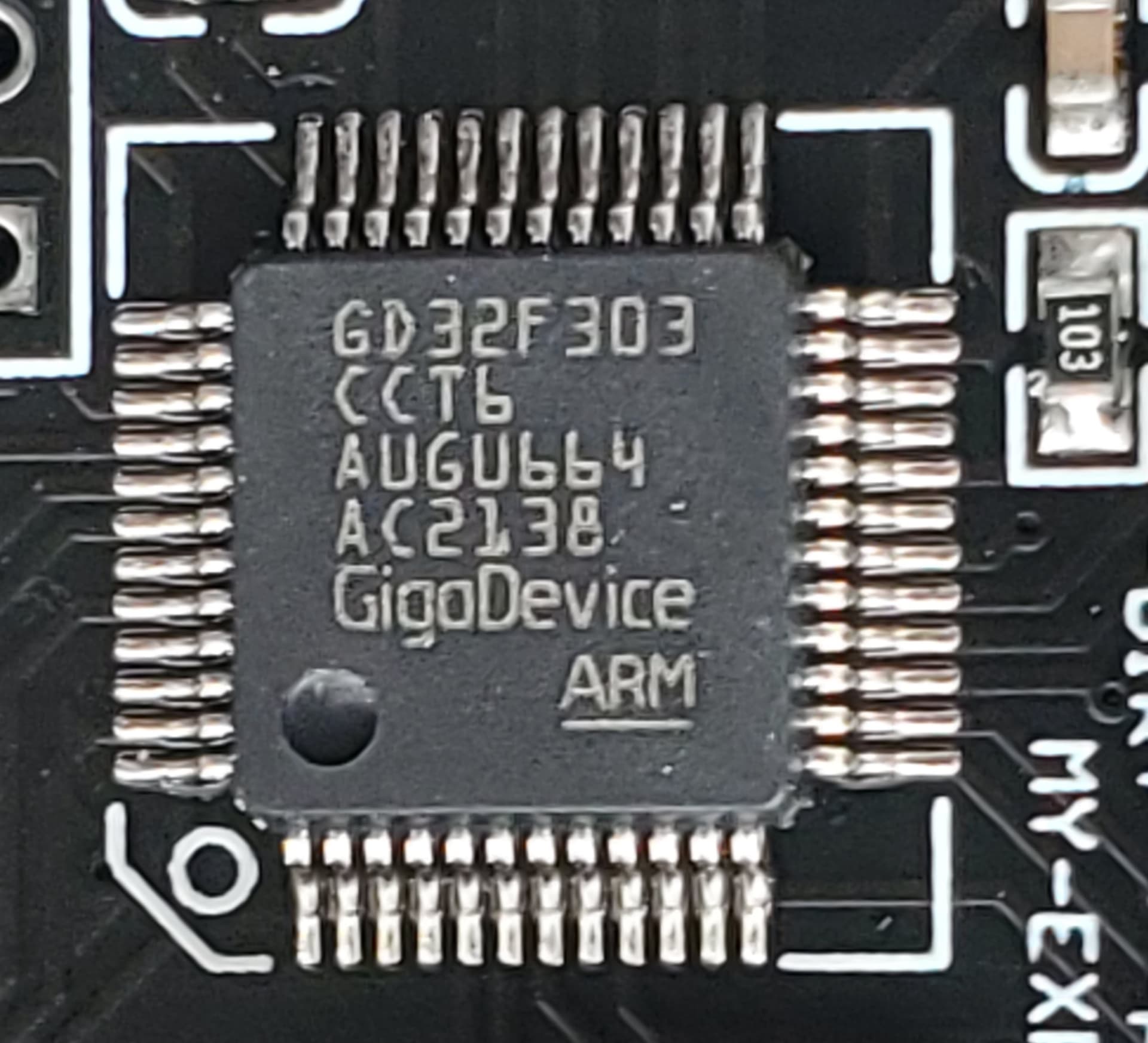

Here’s a control board that may be a good candidate for your project.
Although the manual says that the processor is an ATMega328 or an Arduino they seem to be shipping with a GD32F303 CCT6 Arm M4 chip.
