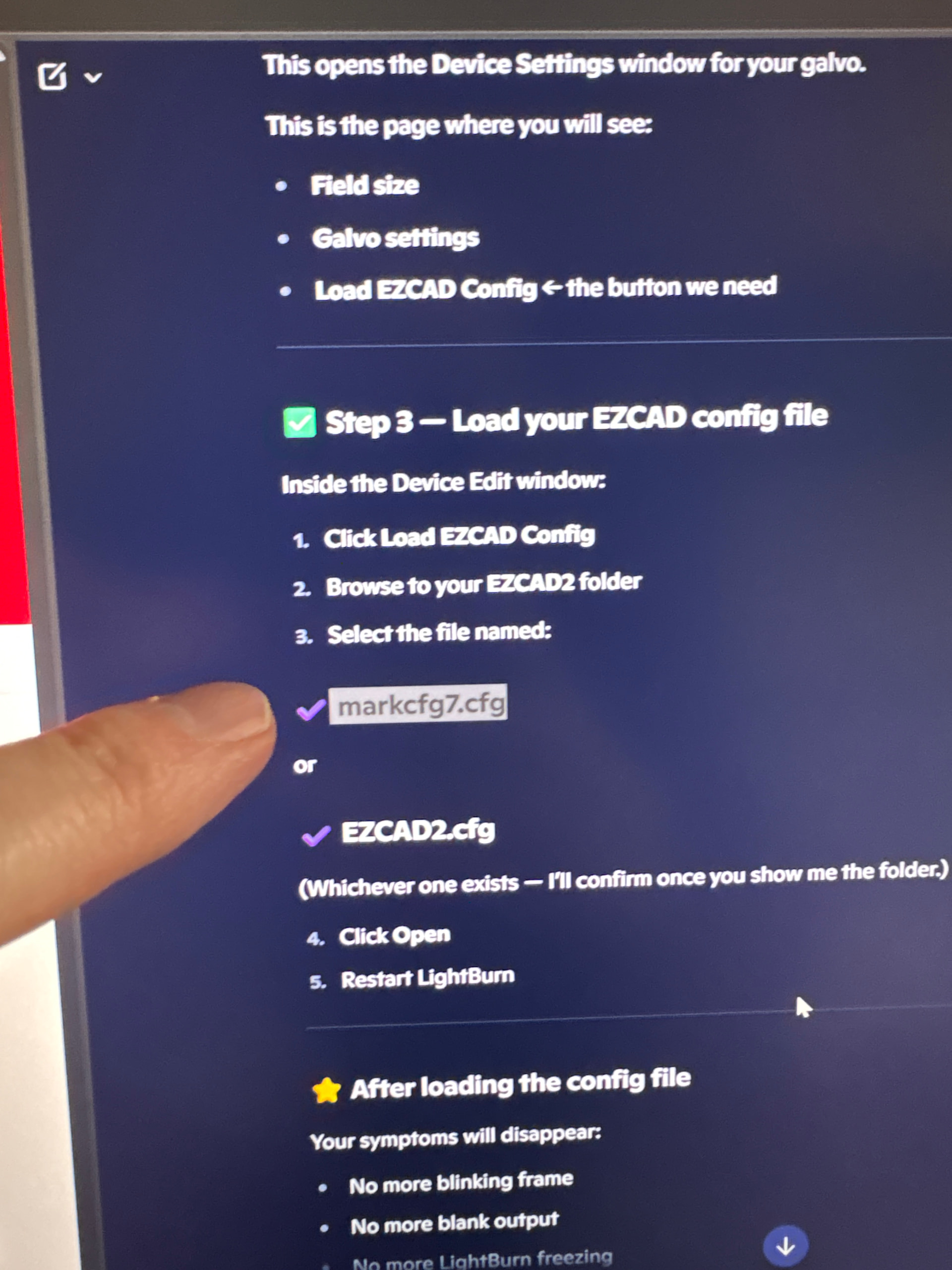

I'm trying to install my uv5w. laser to computer but missing file, markcfg7.cfg my stick usb that came with machine is caropt what do I do now?
this file is missing cant get my uv5w laser to work

I had a USB stick that was reported corrupt before. It was the ZIP file. If I remember correctly I saved it to a folder on my computer then unzipped it there. The zip still shows corrupt but the extracted files were OK.
Don’t know about your system, but my shipped usb stick was copied to my hd. Here’s a listing.. There is no filename.cfg file that I can see… although a partial list.

Try hunting it down without and extension.
If you can’t solve it, you need to ask for more help, from your vendor. Keep us in mind also.
