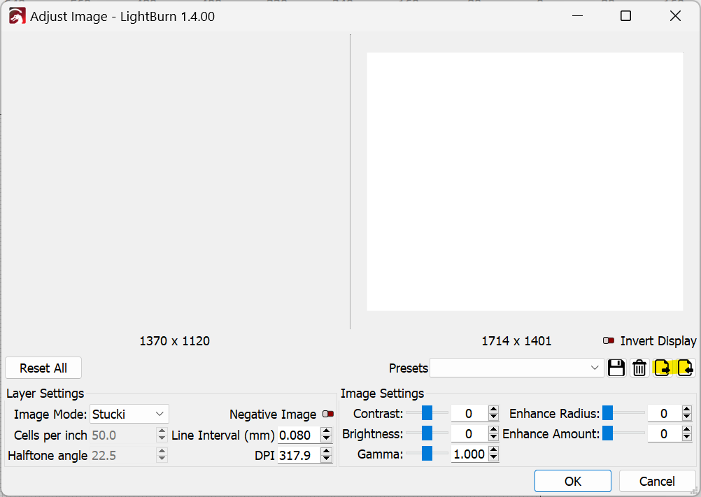

my bigger rig I use to set everything out, import and adjust images in various software etc and my laptop, I use to control the laser and make minor adjusments.
I have used the adjust image function on my laptop, and saved the preset. However unlike the library files et al, the presets are not available on my other computer unless i went through a laborious way of mimicing al the settings and saving them again.
Is there a config file somewhere on my laptop that i can transfer to my big rig to save me all this grief or am I just destined to copy all this over by hand?
Cheers
In the Image Adjust window you can export/import your presets. So export from one computer and import into the other.
Thanks perfect
