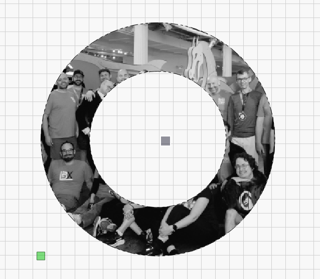

Masking in LightBurn can behave a little differently depending on how the shapes are set up.
If you group two circles into a doughnut and use that as the mask, the image will appear in the band of the doughnut (like this).
If you only select the inner circle as the mask, the image will appear in the hole instead (like this).

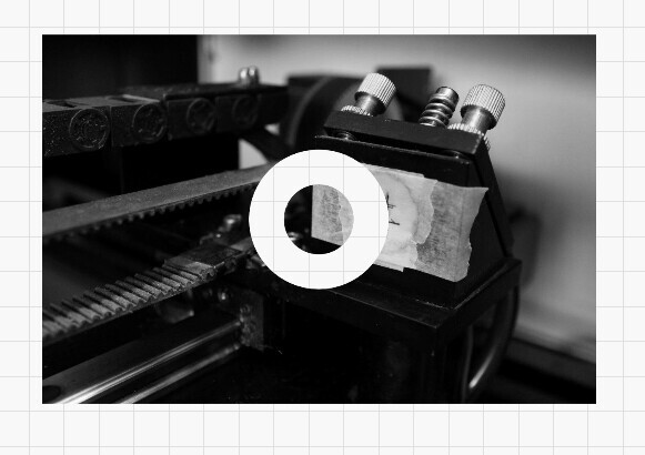

I might not be fully catching your question, but is this the effect you mean?
That’s done by drawing a rectangle the size of the photo, then drawing your doughnut shape on top. Select all vectors to use as “frame” that’s everything, square and the 2 rings. Put that shape over the photo and do Tools → Apply Mask to Image.
That leaves the image showing outside the doughnut (and in the hole), with the ring itself blank.

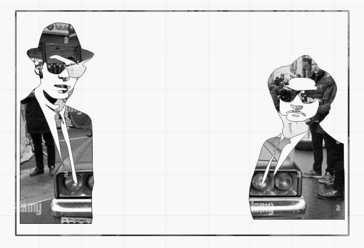

Is this closer to what you’re aiming for?
In this example I traced a silhouette of Jake & Elwood (Tools → Trace Image), then drew a rectangle to cover the background photo. I grouped the rectangle and the traced vectors, placed them on top of the image, and used Tools → Apply Mask to Image.
That way the photo only shows through the background, while the traced shapes themselves stay blank (ready to be filled however you like).

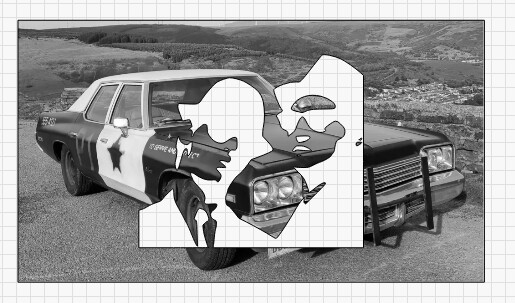

before i go into the labour of explaining all the things I needed to change on your project file… is this what you are going for?
Using my image and explaining carefully (sorry I’m British) tell me specifically what needs to change to get to where you are trying to get to?
Or the above… I get the feeling it’s neither of those things.

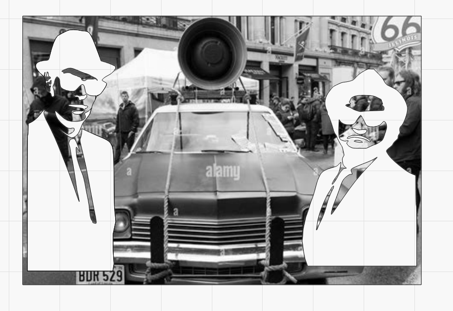

..alright as soon as I posted (which I’ll leave up to show my working out) I thought I’d probably got it wrong what you are after… is it more like this?
Yes in deed, As you can see we now have their black suits, hats and glasses which will be black and the shirts and facial area will be white (Silhouette) and the image background can be whatever looks most Arty!
Well done.
I shall elucidate the method! The key point is to separate out the operations. Think of it like making a cookie-cutter — we want a Jake & Elwood shaped cutter with a frame around them.
- Separate out the Jake & Elwood vectors.
- Run Offset Shapes outward a small amount (this closes any little gaps in the trace — which you’ve already tried).
- Group those offset outlines together.
- Draw a rectangle the size of your photo and group it with the offsets.
- Place that group over your photo → Tools → Apply Mask to Image.
That way the photo only shows in the background, and the silhouettes stay blank. You can then drop your original Jake & Elwood vectors back in and give them whatever fills or engraving you want.
