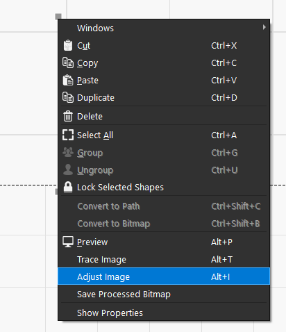

You can also do the image editing right in LightBurn - Right click the image and select ‘Adjust Image’
Indeed; but curves adjustment pre desaturation can help with challenging images, or stacking multiple desaturated channels isn’t possible with the adjust image tool
Fair enough! We aim to get most use cases satisfied with that tool - it isn’t going to compete with high end image adjustment software.

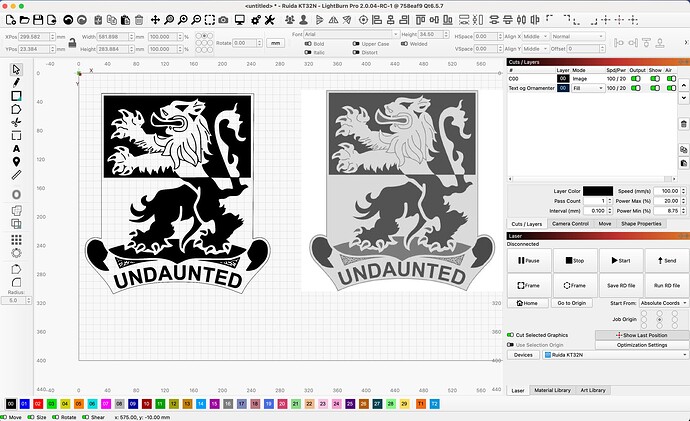

I’m not sure how fine (precisely) you expect or need this file conversion as you describe it in your first post. But as Colin says, the tracing function in LB is not comparable to those of some of the major graphics programs, but… I use LightBurn for pretty much everything because I feel best with this workflow. That’s why I gave your image a try. If black and white is not good enough, I will simply engrave it as a graphic, then you will get the most “original” image reproduced.
On the other hand, I think that my tracing is fine enough for most…

I did find a feature in LightBurn that somewhat worked…open the Cut Settings Editor, and on Image Mode, Enable PASS-Through. Apparently that enables LB to allow the image to work as an image and seems to work pretty good.

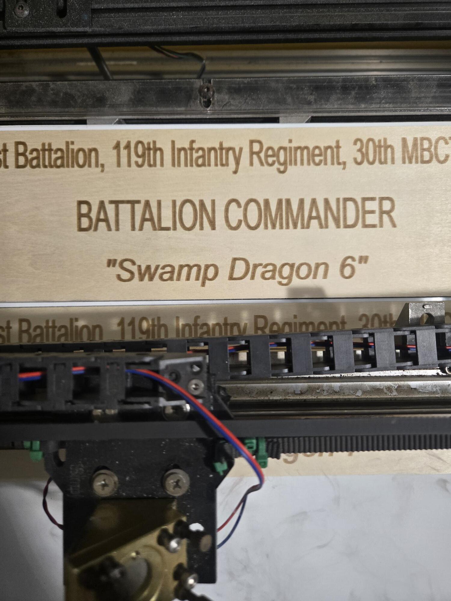

New issue…I had to do some adjustments, and monthly maintenance ont the Laser…now I am getting a new issue. I think it is a Focus issue, but I want to verify with the community before I work that troublesome issue. Enclosed is a snapshot of the issue…as you may be able to see it looks like double letters, and it should only be 1, easy look at the QUOTES and COMMAS, it is definitely visible
there.
What are your parameters for this engraving?
If the machine behaves differently than before the maintenance, go back and find the change you made.
Do you have scanning offset enabled?, too high speed…?
After you follow @bernd.dk’s suggestion to figure out what just changed, because it may be something slightly loose in the laser head, consider re-measuring the Scanning Offset Adjustment.
