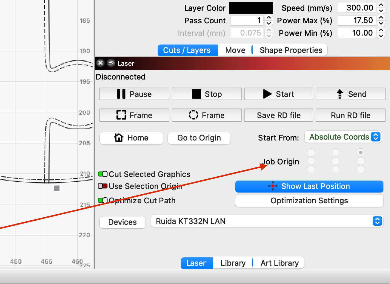

…is a bit in doubt, do you mean the machine’s origin?, they should be the same and are set here - see picture
…the other option is job origin, if it is in user origin, you can put it where you want with the 9 points

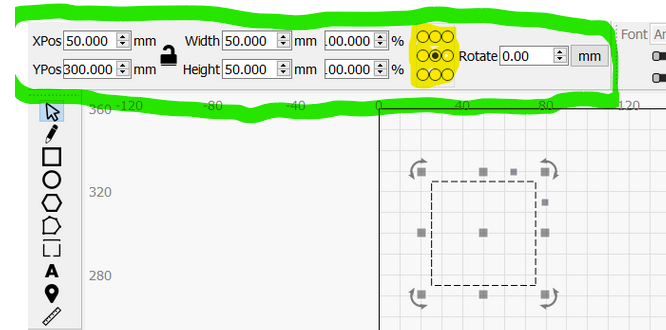

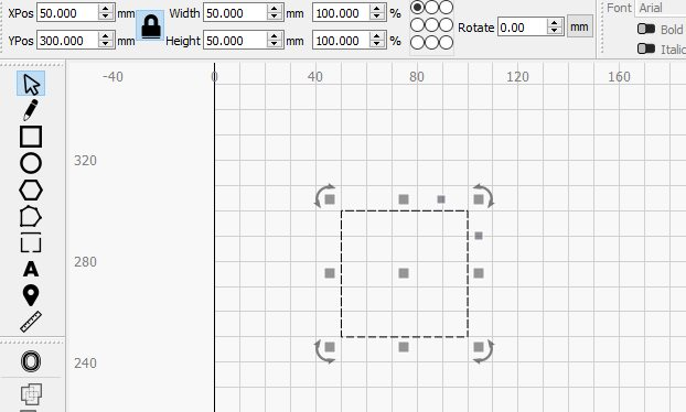

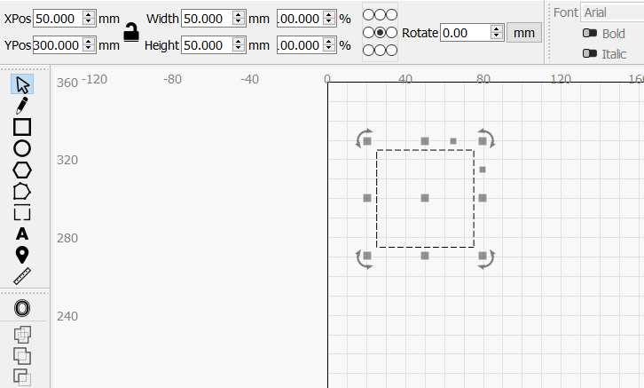

If you are talking about the ones highlighted in yellow, they pretty much just set the base point when using the options circled in green. Just click to change to what you want.
Dooh!!! That it, right there in yellow, hiding right out in front of me - Thanks - I do want to point out I prefaced this as a “stupid question”.
