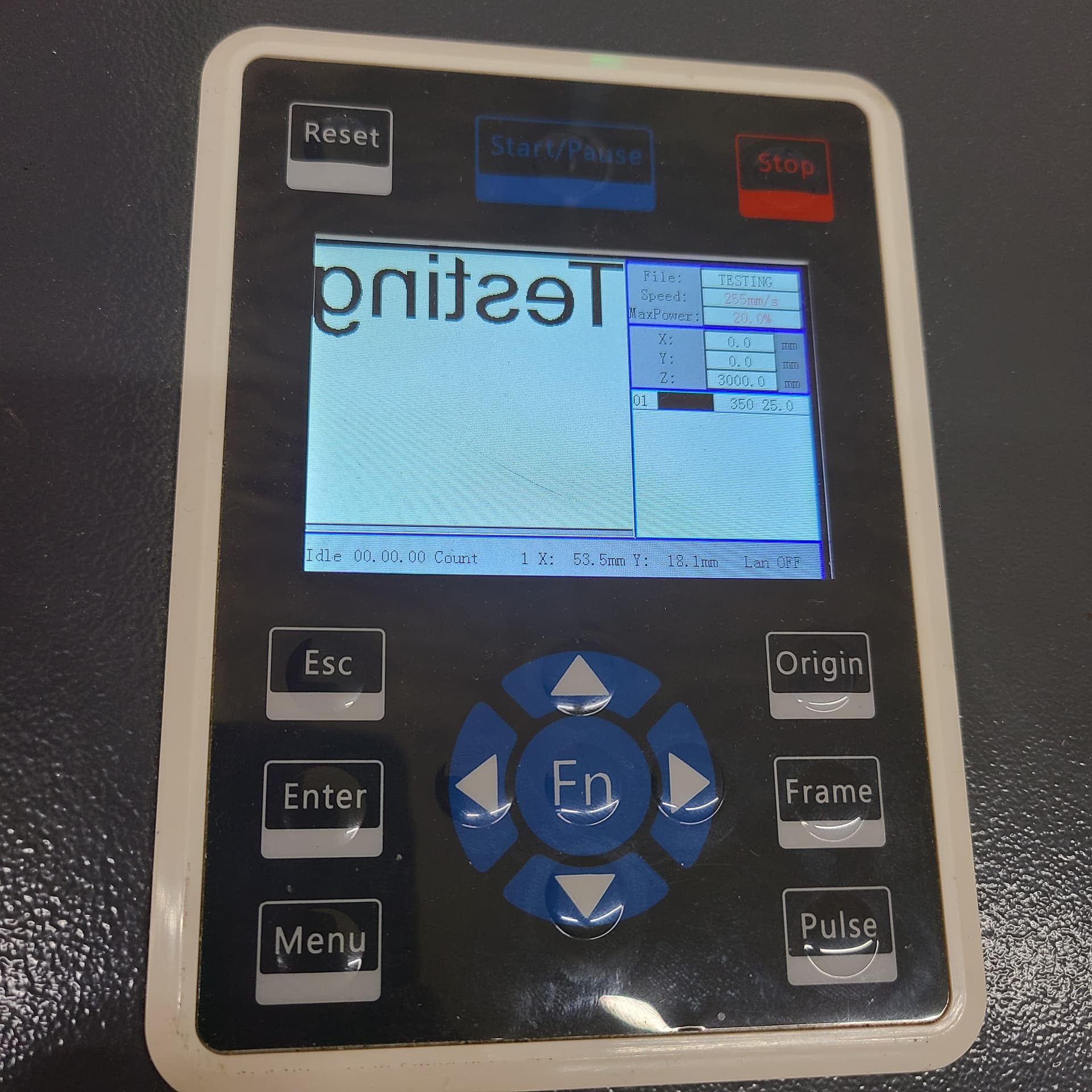

Image engraves correctly but is reversed on keypad
I’m setting up a second laser. It’s an Omtech 2440 that homes to the back right corner when powered up. I have added the laser and chose back right origin. The issue I’m having is the image is backwards on the keypad but engraves normally like it should. How do I correct the backwards image on the keypad?
Are you certain your Origin is TOP right on your machine?
Where is X0 Y0 ?
Back right… Yes I’m certain
I am not familiar with your machine so i cant be certain
However what you are seeing is often the case when the origin is not correct
You could try just as experiment to change origin to top /left and see if screen would see the same
of course engrave a test to confirm if wha tyou see is what you get too

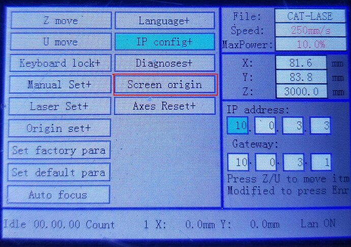

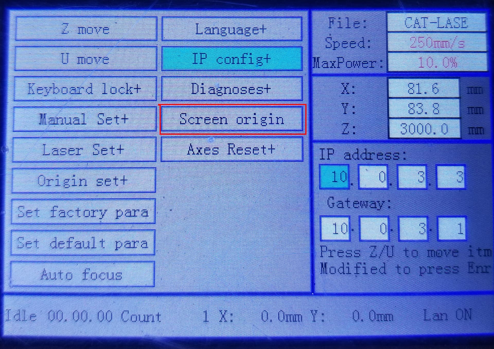

Your console looks nothing like mine, I also have a 6442… Did you change out the controller?
On mine, you press Z/U (I’d guess it’s the same as Fn?) then there is an option for screen origin
If you get into the machines configuration from the console it should be there…
You are da man!.. That was it… Thanks so much!
