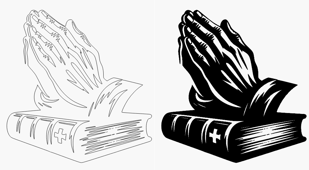

Image issues can anyone give some advice?
On the left is the vector, right is just a change from line to fill.

I found out what is happening when I am measuring the images. My question is what am I missing here? Has something changed or is there something I am just not understanding here. There is a difference between the Image size and the selection box that is around the image when I select the image. Is it the file type I am choosing when I removed the background? What is the best file type for this specific type of design image I am working with right now because I have close to 20 more to do. Thank you for the help.

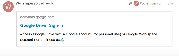

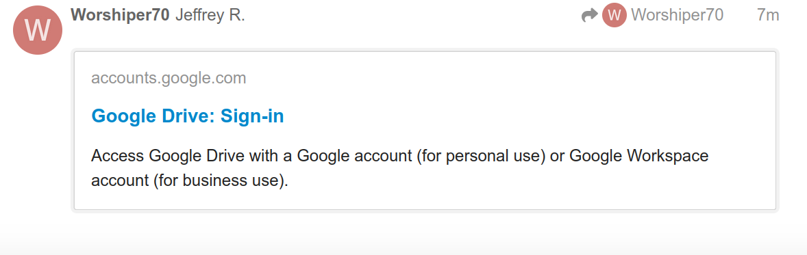

I signed in and checked and it says that there are no restrictions on this file. I am nor sure that it is anything on my end.
This is a link to one of my video files. It shows the file name…
Yours shows the google drive sign in.
If it’s in a sub directory, all the directories to the file has to have permissions also.
I give up. I opened the video and went into the settings and turned off the lock/restrictions and shared that link and it still is showing the sign in. I will look for another way. Thank you for the help. At this point I am spending to much time trying to share the link. Thanks again.

If I have an image that’s 10x10 and I remove part of the back ground… this background is only bytes the specify the picture content. There is really no way to have a file like you have and part of it be non-existent. This is life with computers.
Suggest you watch this video on masking and I think it’ll solve your problem.
If you have issues, sing out.
Thank you for sharing that with me. I didn’t use any of that. I didn’t know about using mask. The image I had to begin with had a background like paneling that I did not want so I ran it through a background remover. The issue is that when I brought it in to LB it has a selection box that is a lot wider and taller than the image. Maybe since they added these new tools it changes the way it used to be. I was away from it for a couple of years. I drew the box around the image and put it on a tool layer so it would just be in the background. I used that to get the true size and it actually made it so that I could do the engraving. Hopefully I will not encounter it again but if I do I at least came up with a way to get around the problem. I appreciate all your help in trying to come up with a solution. I will just click solved.
You have to remember that image files contain an arrangement of pixels. If the pixels donate no background, the data is still there and Lightburn sees it as part of the image.
