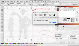

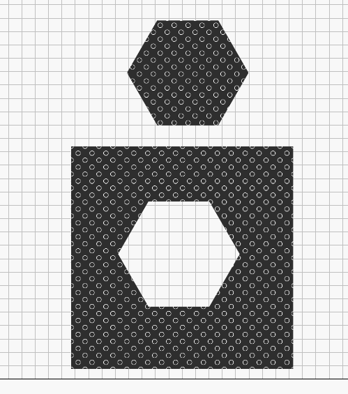

Show us an example of what you’d like to accomplish, and we may have a workflow or two that could help. I am interested in your usage of the term ‘flood fill’ in this context. If you are mean using a repeating pattern to fill a shape, yes. LightBurn provides an Array tool that assists in creating a grid of the item selected, in this case, your repeating pattern. You could then clip, or mask to produce this fill pattern into any desired shape used to mask. If your art is a raster image, use the ‘Image Mask’. If the art is vector-based, you could use the Boolean Tools to clip the fill to the shape.

Is this what you’re trying to accomplish?
Mask with a simple image?
