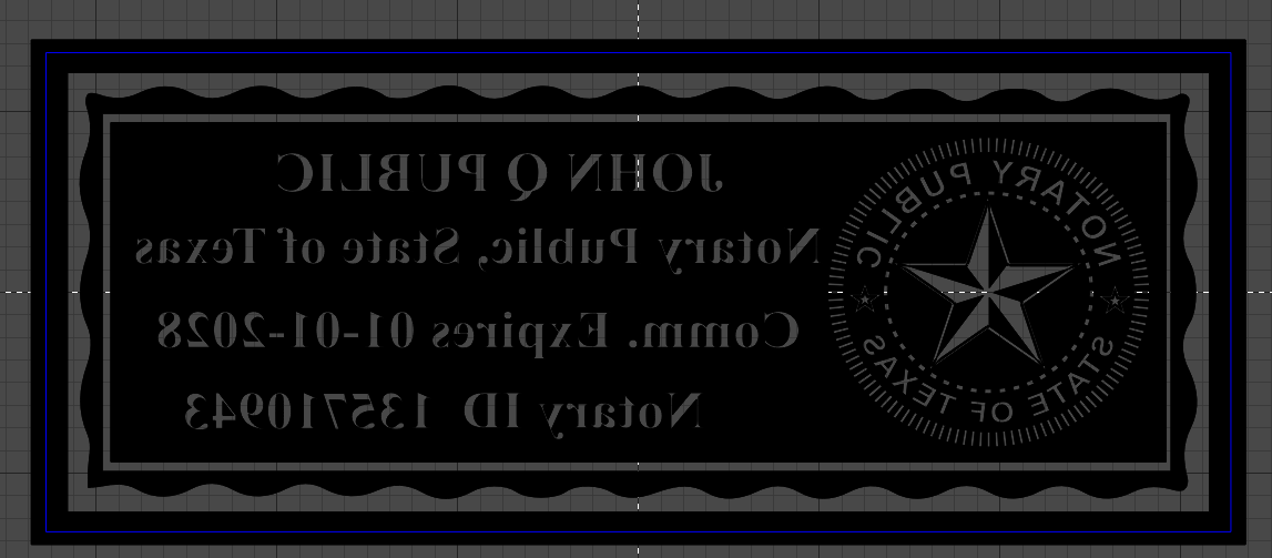

Yes sir! But the circle with the star looks a little stretched. but yes that is it as long as it engraves in reverse. lol Thanks
tx star.lbrn2 (26.2 KB)
Ok, on my machine I had to flip the graphic to get it to look like thar. I uploaded the work in progress file for you. also added a file with an improved star. you are welcome to use that.
to get the effect you were looking for, I used the text layer to punch a hole through the black layer (boolean subtract) - otherwise you were trying to burn on top of a burn, which does not work like it seems. You need to cookie cutter a place where the black layer won’t burn.
I also found a duplicate rectangle in the circle around the star (i removed it) - when you have two exact shapes stacked, it won’t burn either one.

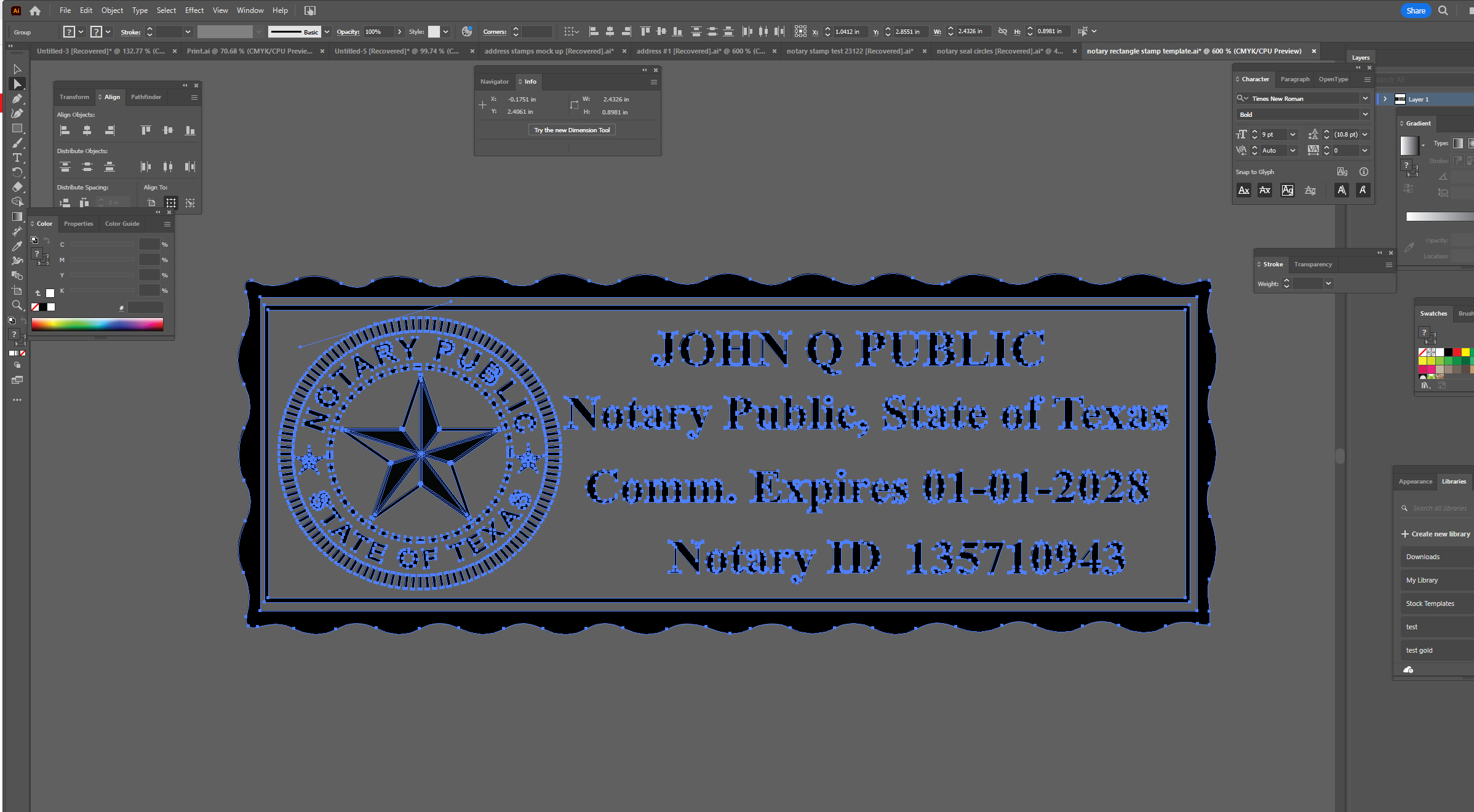

Jim, Here is a screen shot of my work in illustrator. I hand made this file from scratch there are not any images used here. I converted all of the fonts and shapes to outlines before importing into LB. I am not sure really what the problem is as you can see everything is knocked out.
Illustrator handles the job different. Not trying to downplay your work. For a new user, you did a lot of cool stuff.
The layers in LB are like a stack of cards. Most of the time you are adding stuff to the stack. There are times when you want to leave a hole (not burn anything). In my file you can see the background grid through the no-burn area. In your file, you kept adding stuff on top of other stuff. Laser engraving is a subtractive process, coloring with paint is additive. My file is fewer layers that your imported.

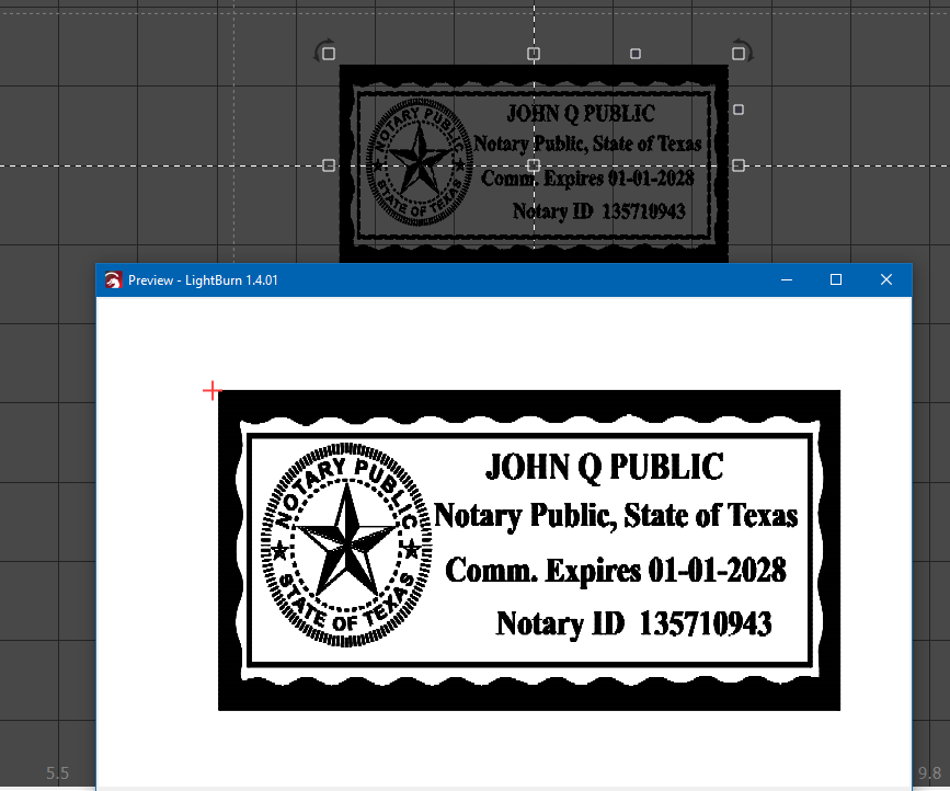

Aha! For a rubber stamp, you want the letters to be proud (standing tall over the background), so the letters will pick up the ink. Ok, I need to make a change to make the letters see through and the background needs to be burned away. Dagum! I am away from my project laptop, but I will upload again with the corrected perspective .
Jim, Take a look at this file.
notary test template 2.lbrn2 (283.1 KB)
I made 1 small change and saved the file. On my file, the white letters will stand proud over the background. The white letters will pickup the ink from your ink pad. The black areas will not transfer ink and the paper color will show through.
Use preview to watch how the project will play out.

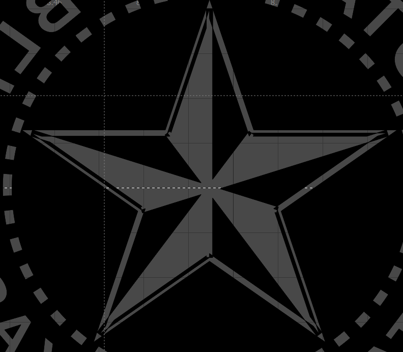

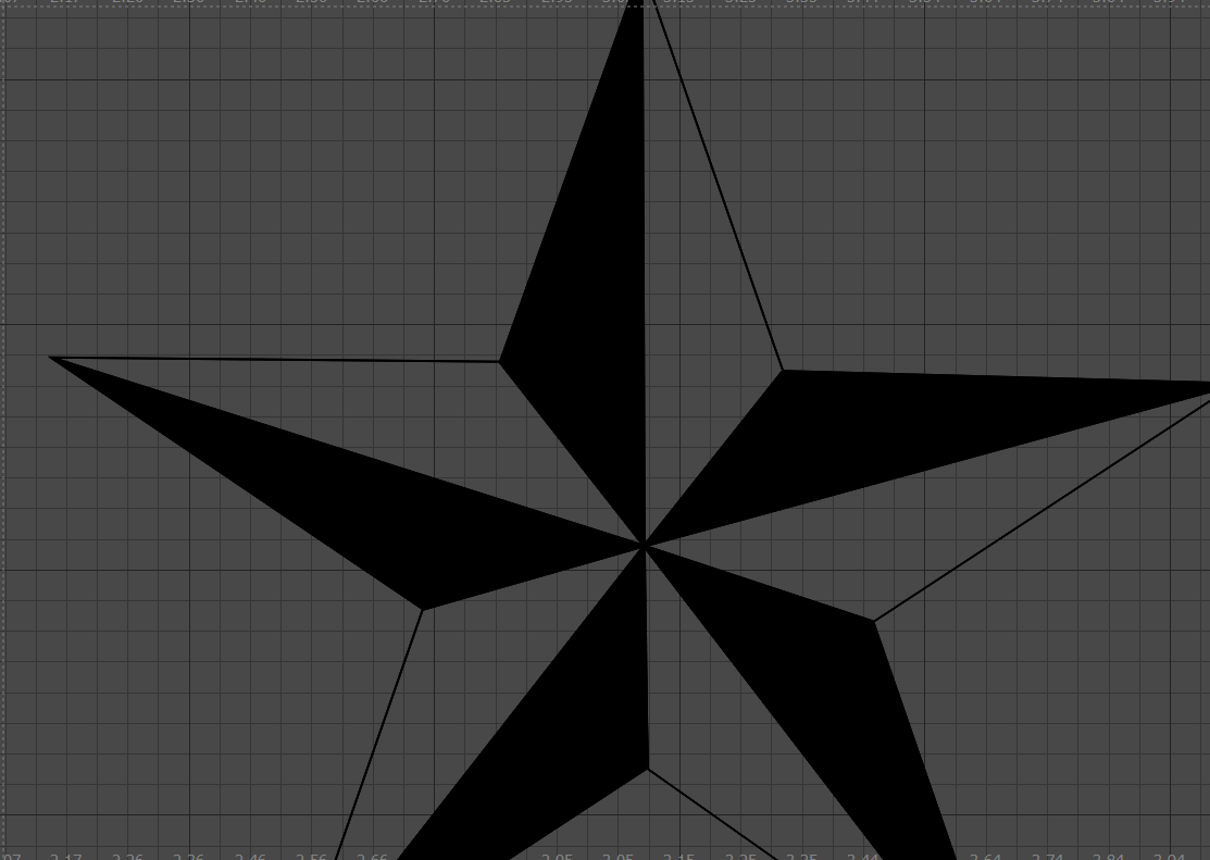

Here is your star, zoomed in close
Here is the one I attached… Take a look at the star file I attached. You will see the differences.

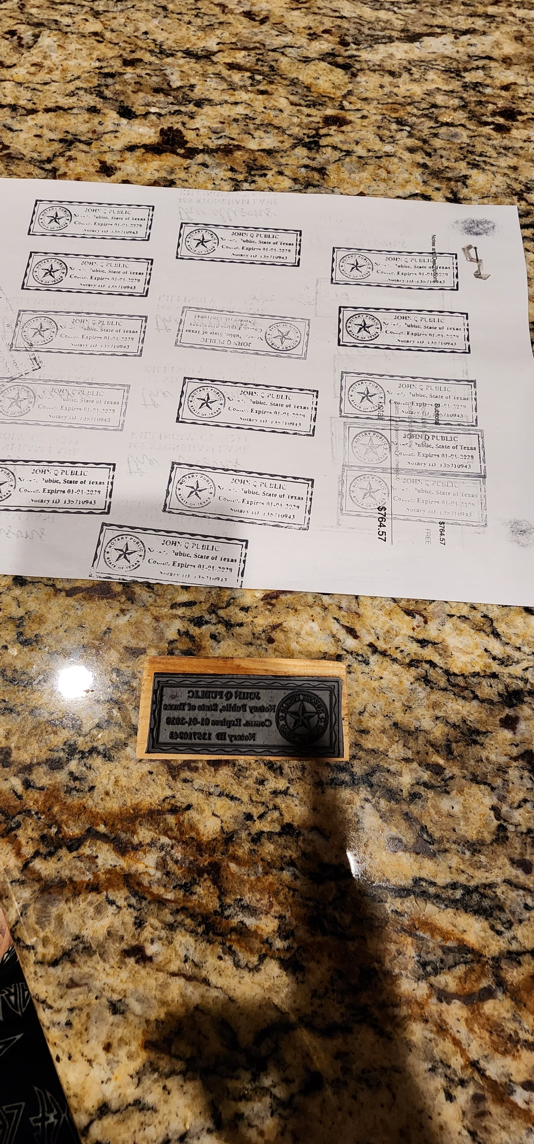

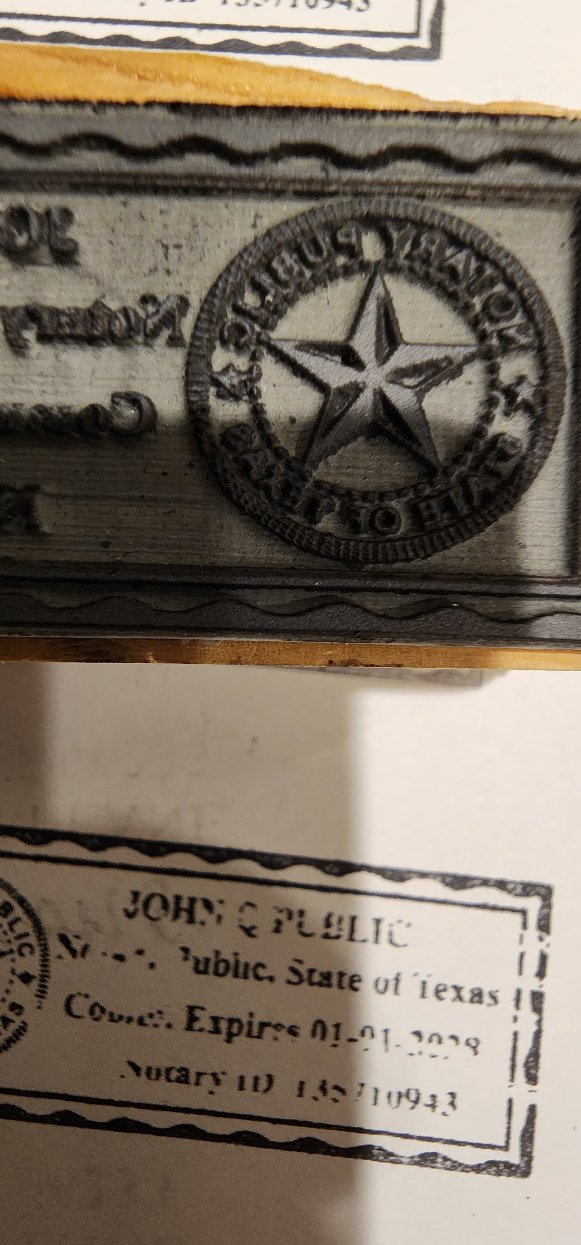

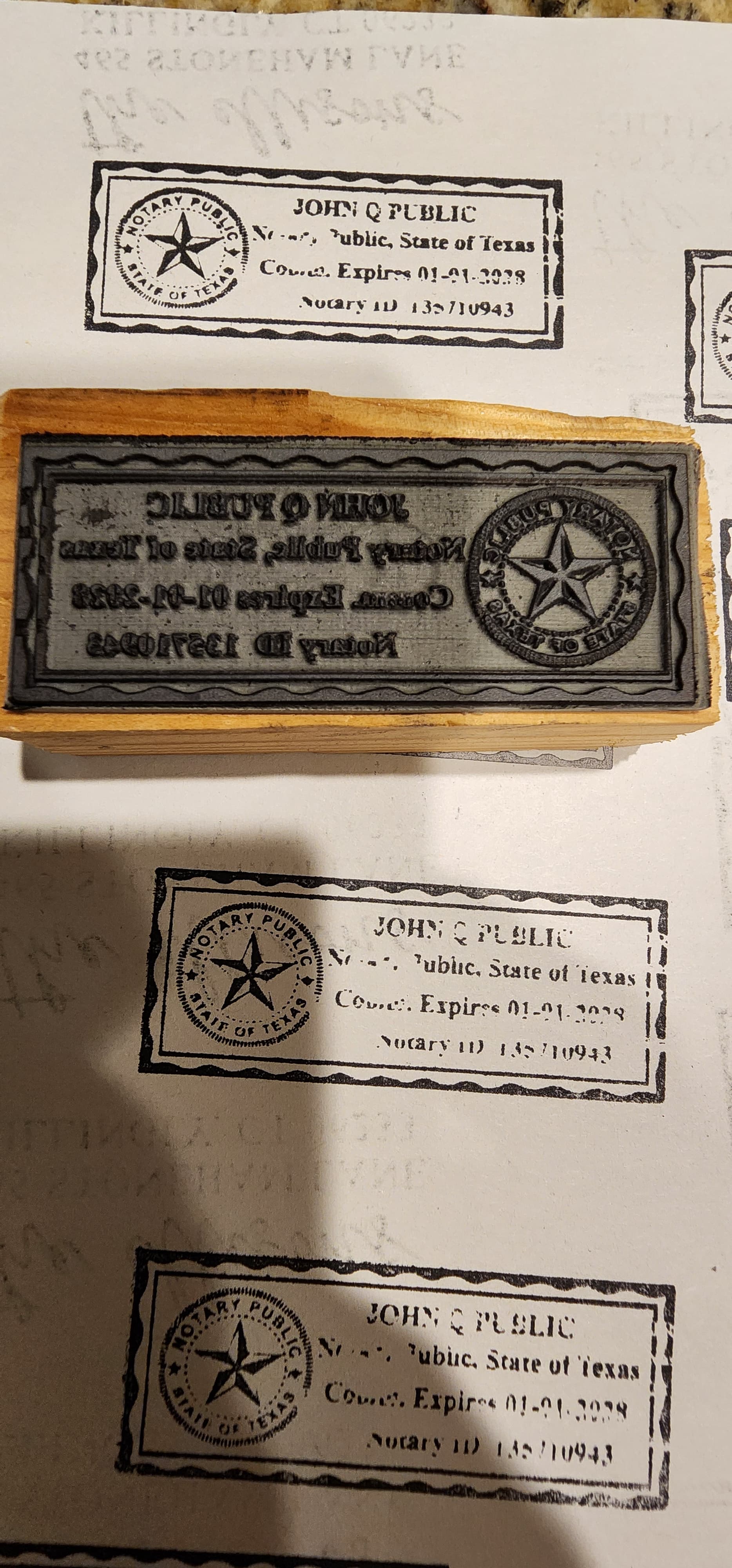

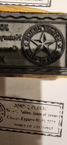

Thanks, Jim for your help this was a tricky design with so many layers. I found that my ramp settings were too high and that it was for lager texts and shapes hence the large outlines on the these small detailed shapes lol. Anyways thanks again for all of your help. here is the finished sample stamp.
Great to see you have some success. Every time I try something new, I learn. Keep up the progress and keep having fun with it.
