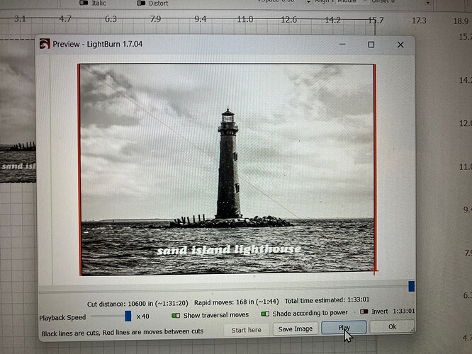

Hello. I’m fairly new to Lightburn and engraving so I’m guessing this is just me…I have the Falcon 2 Pro 22W. I imported an image to LB, adjusted settings, framed and did preview. Everything looked good so I started engraving (a 5x7 photo). I shut it off about 1/3 way up because its just engraving lines, no image at all. I’m guessing I must have some setting off but it’s the same settings I’ve used for other photo engraving. Any suggestions will be greatly appreciated.

Here’s a screenshot of my preview
Just uploaded a screenshot of the lightburn preview. is that okay?
Also, just changed all settings back to the ones used in the 2nd photo (middle bay lighthouse), and tried again. Still getting same result…just lines going back and forth, no image at all. The lines are going back and forth inside the 5x7 frame size but just no image.

Just closed completely out of LB. Reopened, selected a new image, selected settings…same thing. Just a 5x7 rectangle of lines. Image preview shows just right. I don’t know what to do.

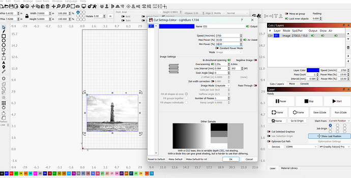

Can you take a screenshot of your settings so folk can have a better idea of whats going on.

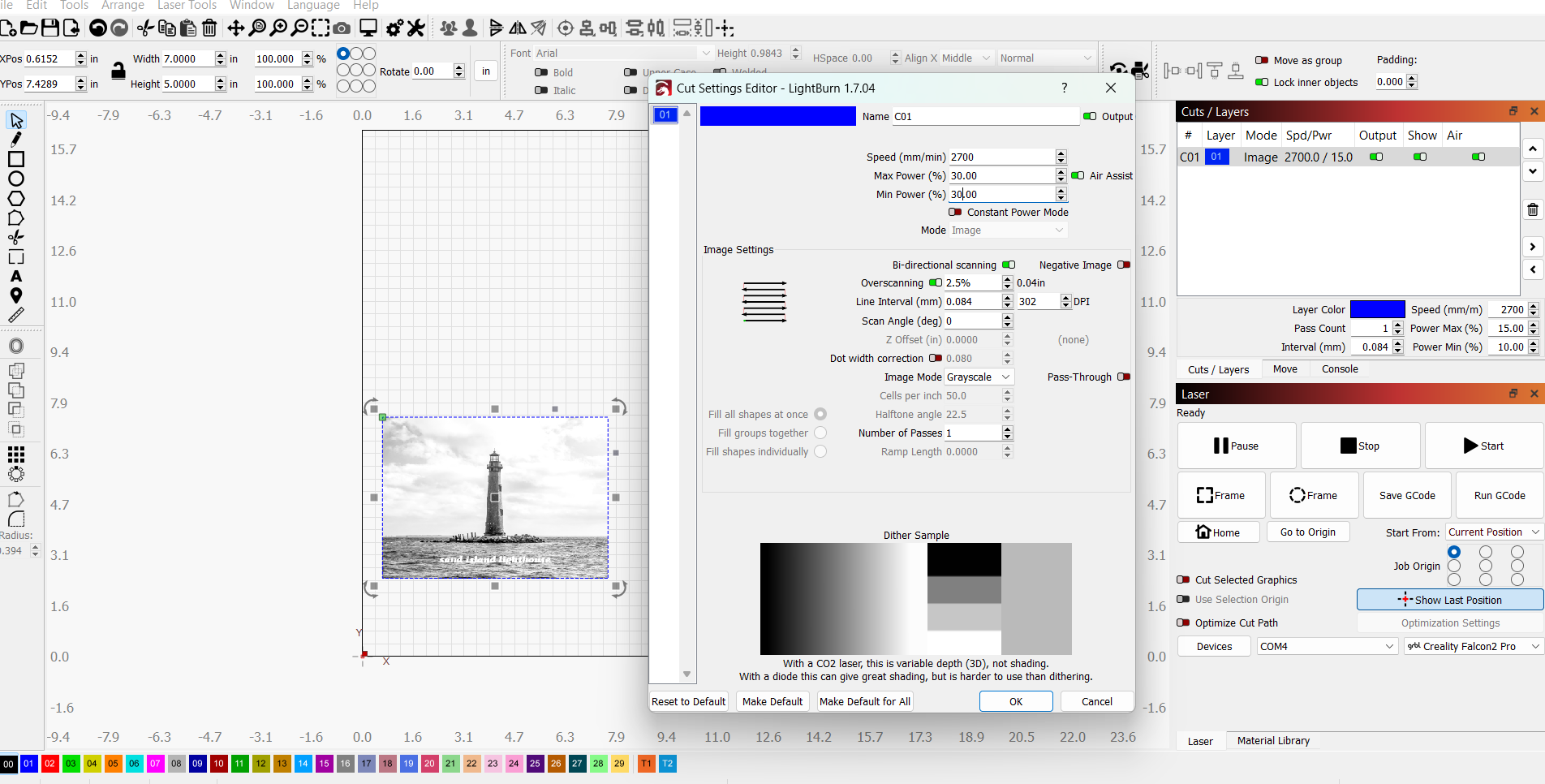

Will do. I just went back and put in my Middle Bay Lighthouse photo (as shown above). It printed perfectly with saved settings. The Sand Island lighthouse photo is so very similar in all aspects so I closed out of everything again just now, reloaded SIL image with same settings, preview is perfect, but then get nothing but a 5x7 rectangle of lines again. I’ve tried changing speed, power, dpi, but nothing makes any difference. The lines get darker and lighter depending on what I do, but there’s just no image. Tried another image with same result.
Will try the screen shot. Thank you.
the above settings are the same as the ones I started with for the photo below as they are very similar in tone, contrast, etc. I tried adjusting different settings from there. In the screen shot above, you’ll see that I had taken the power down to 15% to see if that made a difference. The only difference was the 5x7 rectangle is filled with lighter lines but still no image.

Well, I THOUGHT I had finally figured out the problem but not really… After looking and looking and looking at all my settings trying to find anything different, the only thing I had never tried was the passthrough button which was turned off. I turned it on, and tried one more time, and the image is now printing. I have no idea why as, if I understand correctly, that button is to be used for photos that have had all settings applied outside of Lightburn. I did convert this photo to a black and white image in Photoshop and adjust brightness/contrast, just as I did with the Middle Bay Lighthouse photo, but that’s all. Passthrough is turned off in the Middle Bay Lighthouse photo, and it printed fine, so I’m not sure what made the difference with this photo. However, with Passthrough turned on, my setting options are also limited. Guess I’ll just try doing all conversions in LB so I can choose my settings.
Well, I brought a full color image into LB, and made all adjustments there. (I did some minor adjustments in Photoshop to color, and saved as a BMP). Unchecked passthrough in LB. Checked preview, and everything looked good. Started the engraver, and I’m back to solid lines again.
Well, no matter what I do, the only way an image will print is with passthrough turned on. I tried saving image in different formats such as jpeg, bmp, png,etc. , and nothing will print without passthrough turned on, then my only option is threshold which grays out other adjustment options. I don’t know what else to do.
