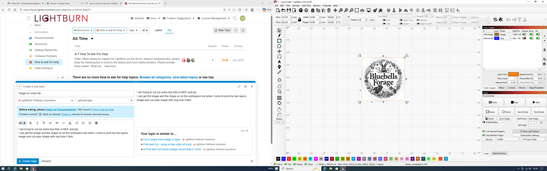

I am trying to cut out some key fobs in MDF and ply.
I can get the image and the shape on on the workspace but when I come to print my two layers, image and cut outer shape with ring hole it fails.
The image prints fine on layer one, but when it moves to print layer two for the shape and little hole at the top to cut out it only marks it. Layer one is speed 1800 power 40% and layer two is speed 400 and 100% power.
I know it is something I have missed and tried to source info but all with simple text no image.
It appears to be when I attach the image it takes over and will not allow the cut at full temp speed, a bit like it is using the image settings to cut the shape, even though the layers state different.
Thank you in anticipation.
Robert

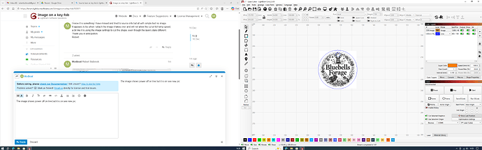

You have output on the blue layer turned off.

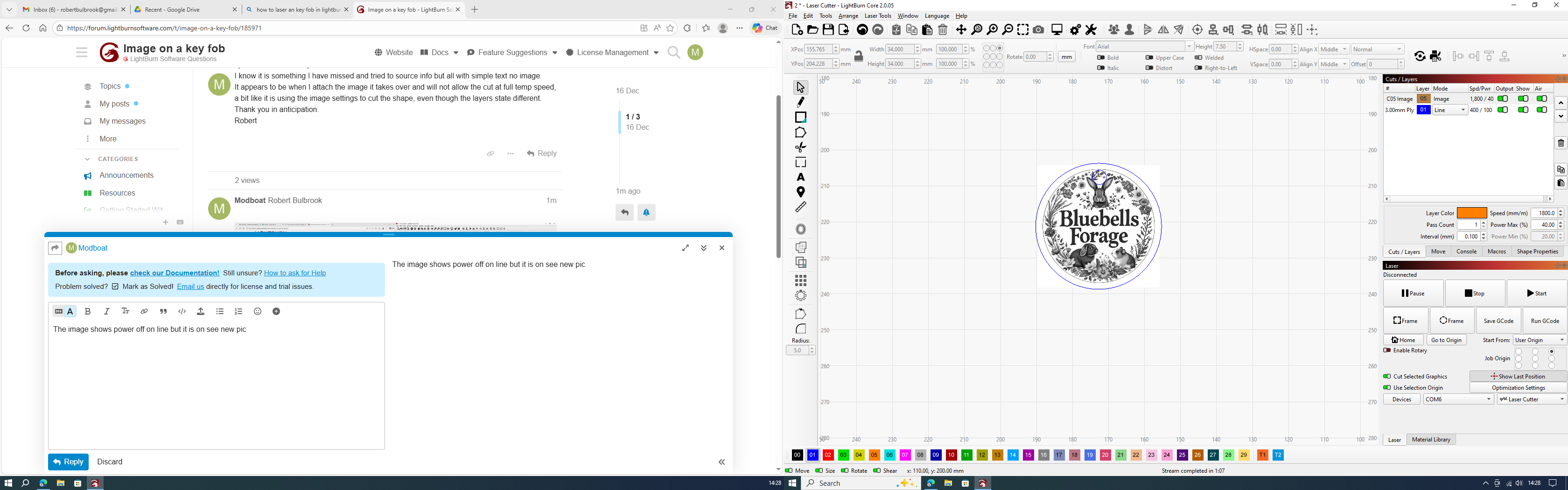

The image
shows power off on line but it is on see new pic
attached wrong picture first time last image is what I have been using

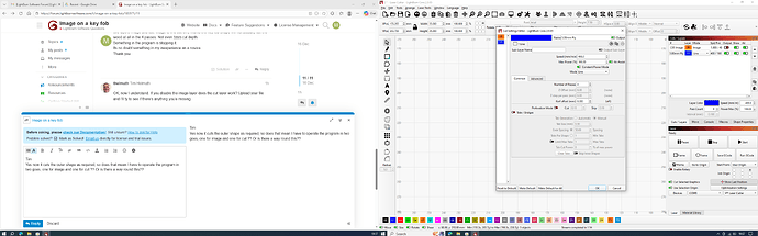

OK, now I understand. If you disable the image layer does the cut layer work? Upload your file and I’ll ty to see if there’s anything you’e missing.
Tim
Yes now it cuts the outer shape as required, so does that mean I have to operate the program in two goes, one for image and one for cut ?? Or is there a way round this??
You didn’t change any settings other than to disable the image layer? Something is not adding up. It shouldn’t make a difference if the image layer is on or not. Unless… the engraving is somehow overheating your laser module and it isn’t able to output enough power for the cut.

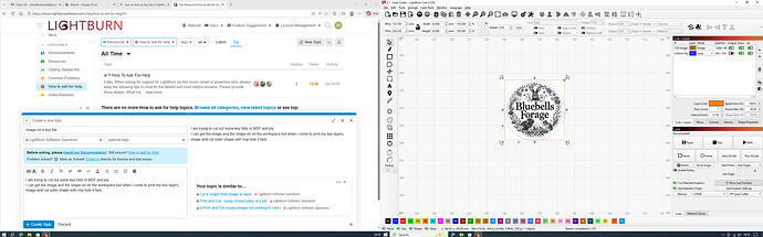

You have “Cut selected graphics” on. That means that your laser cuts only the parts/ layers you have selected. Turn that off and it will process all layers and cut as intended.
On my work, Cut selected Graphics never gets turnrd off.
Is it possible only the image is selected and not the cut-it-out layer?
You have to turn it off yourself. When it’s on, what ever you select on the canvas is what is sent to laser, everything else is ignored. Try deselect everything by clicking outside the drawing and you will get an error message saying you have it on, but you haven’t selected anything when you try to run the job.
Here is the explanation what the option does and how to turn it on and off:
How are you selecting the thing to engrave? Are you using a right to left drag box (green outline)?
If you are just point and clicking, you are not getting the results you want because you are missing the selection. Try using the lasso and let us know how it goes for ya.
