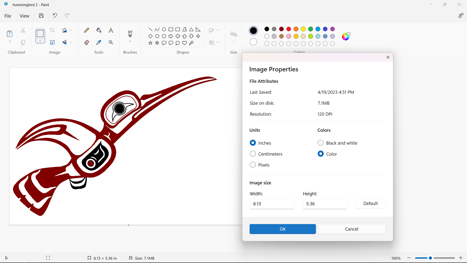

In Paint, with one of the images you’re trying to copy, can you go to File->Image Properties and take a screenshot?
There may be something going on there.
I’ve copied from W11 Paint without an issue.

I got the same results as before by changing from pixels to inches

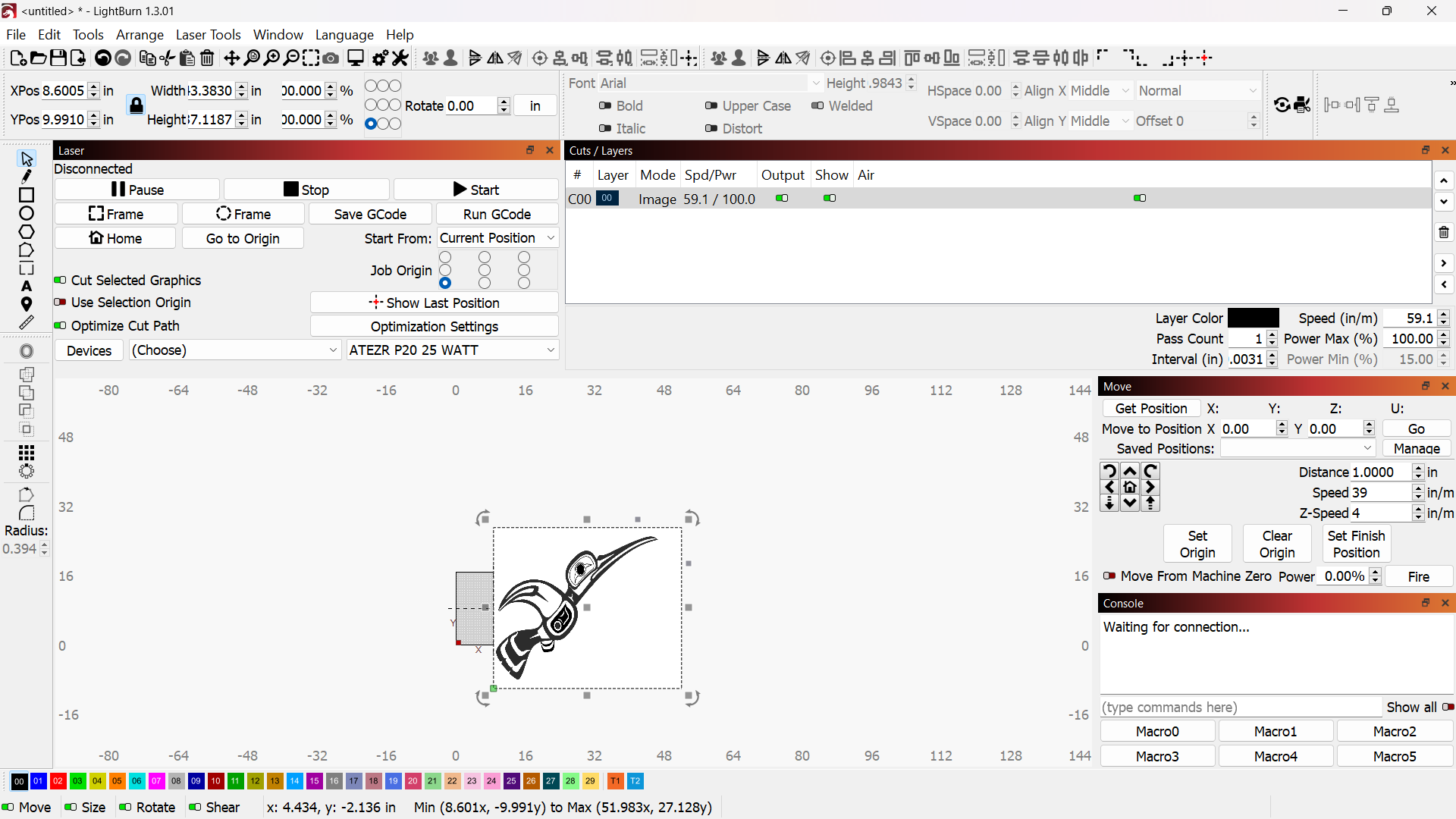

The second screenshot is after I sweep the screen to capture the image by lightburn before I expand it.

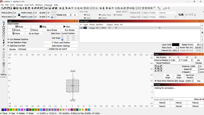

and then after expanding it in the 3rd.
I even cropped out the extra background to eliminate white space but got the same.
The height does not change…
