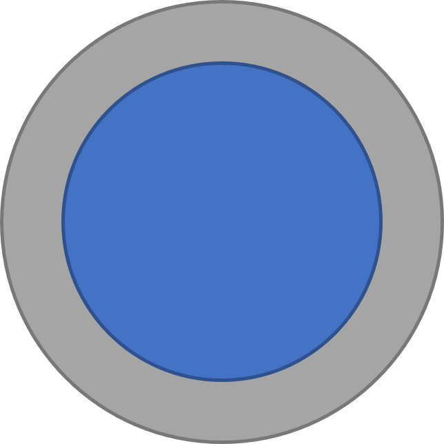

Having an issue with my workflow. I set up a template to engrave metal lids. The template is perfectly centered.
However, when I engrave a lid, the logo is off center. It is perfectly engraved, but off center. I was able to tinker with it a bit, but I ruined 3 lids in the process.

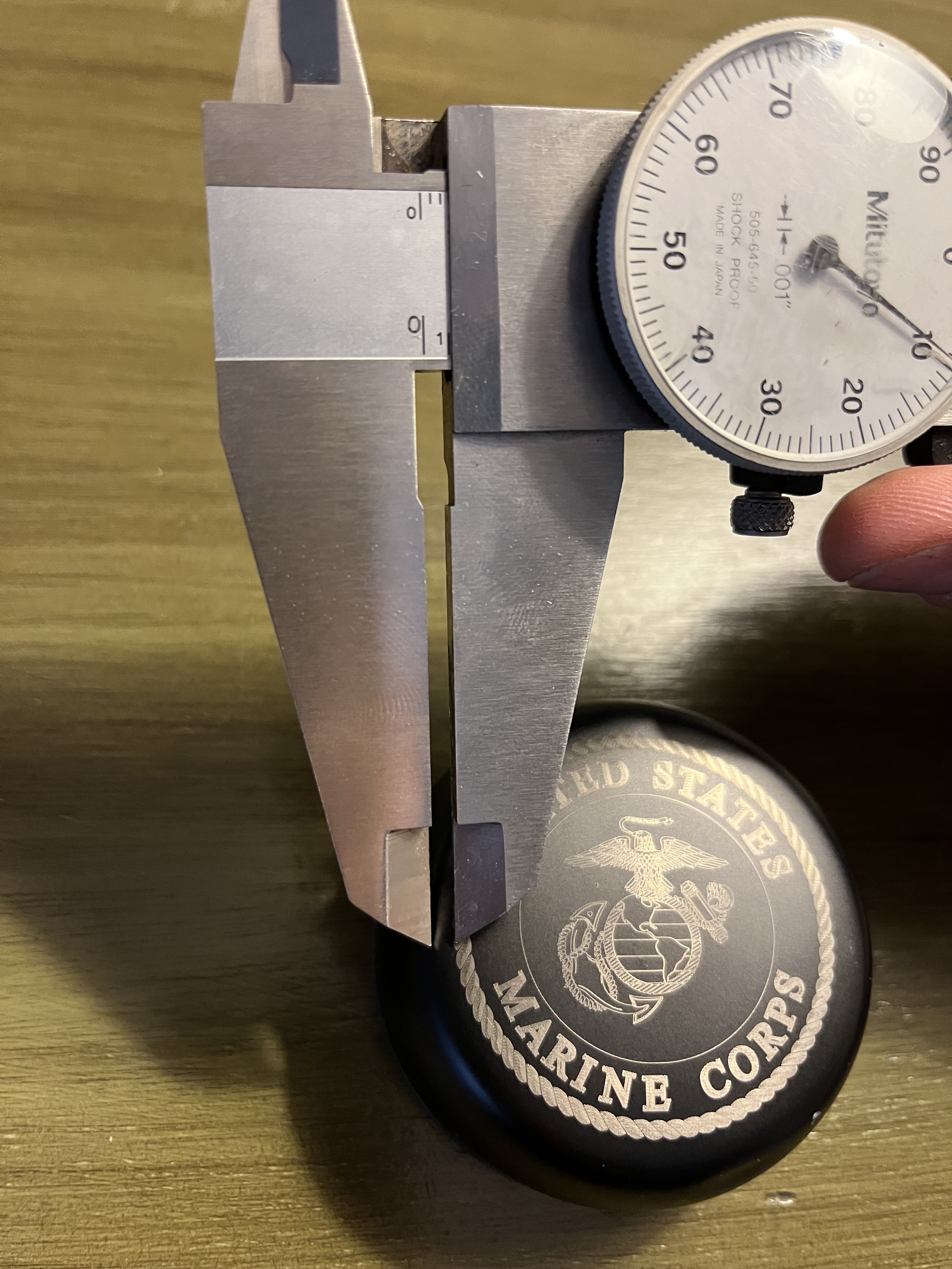

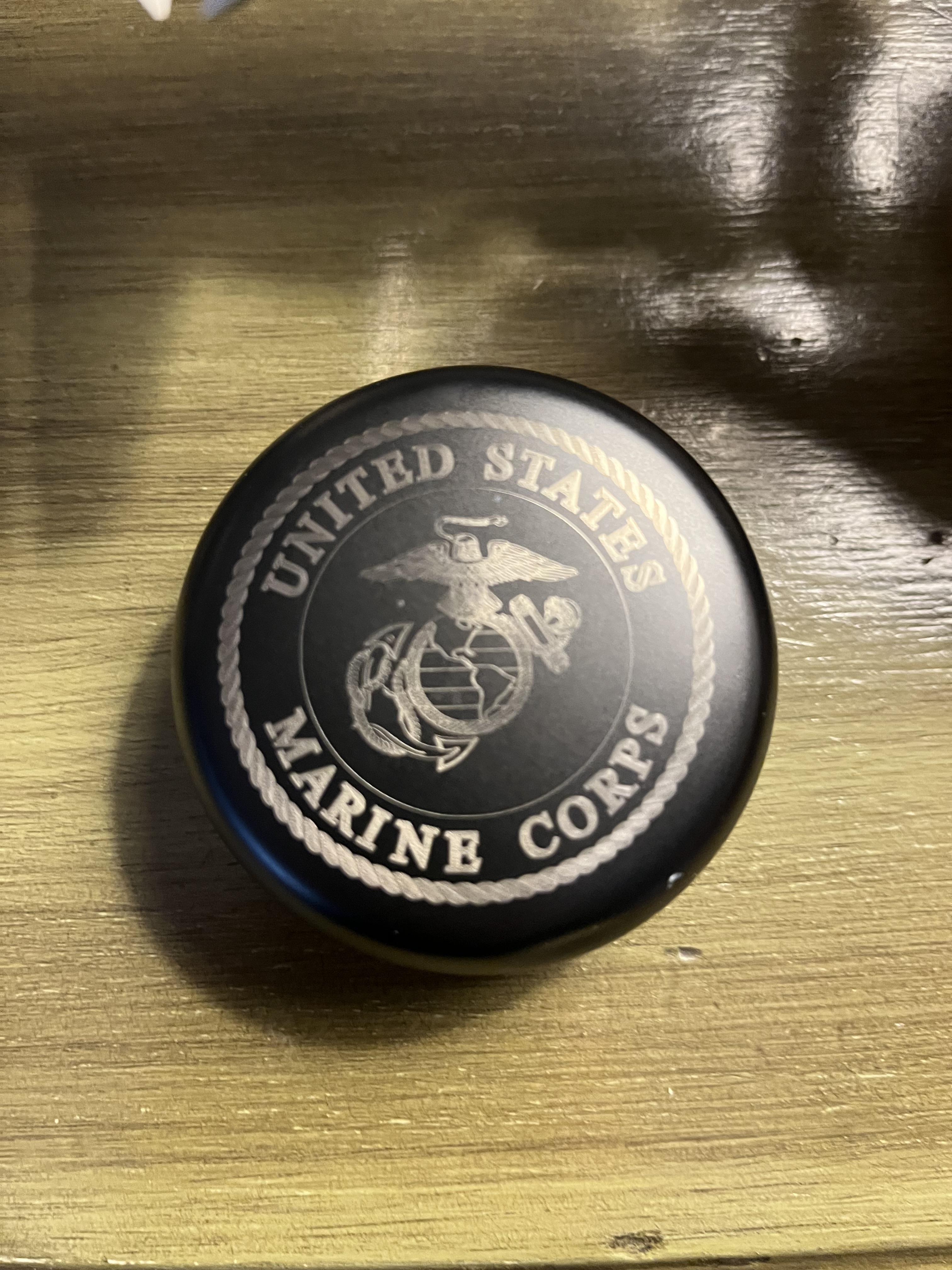

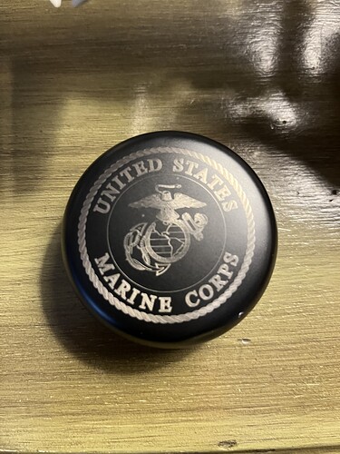

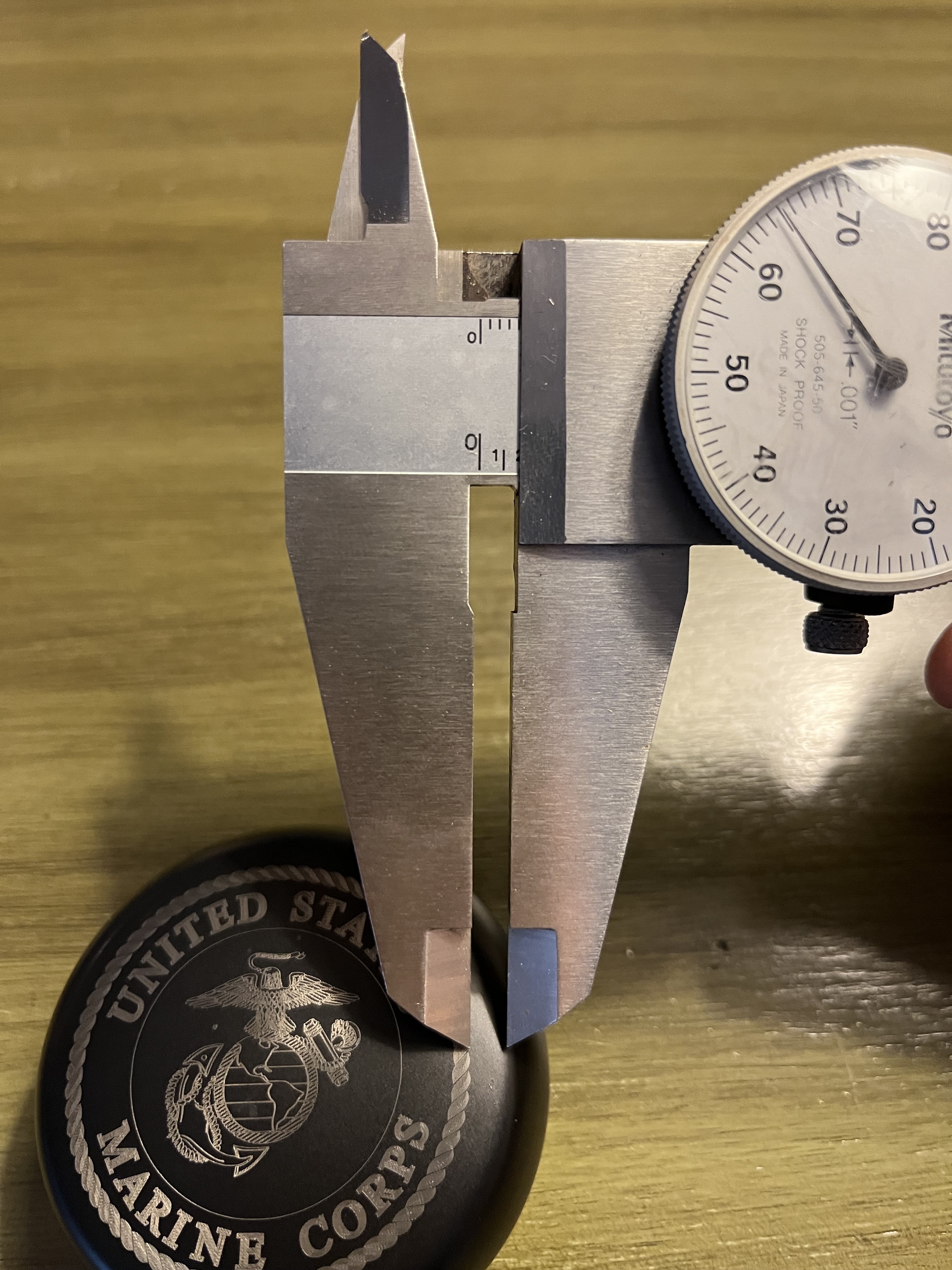

Here is what I am talking about. I tightened all the bolts and belts. Still off center. Is is better though.
How are you locating the cap? I would run in absolute coord, home properly, and burn a pocket in a waste board jig to hold the cap. Framing something like that cap will be tough.
Beautiful work, btw.
