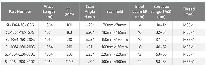

You didn’t mention any specific lens… but most lenses spot sizes are in um or microns.
The smallest spot size for the F100mm F-Theta lens is between 10um and 12um or 0.010mm to 0.012mm according to this Cloud Ray chart of Omega lenses. The coverage is the number before the F number… An F100mm has the coverage of 70x70mm… Shorter focal length, smaller dot (spot size) shorter depth of field.
The value you want for an interval is 1/10th the size of the lasers kerf.
I can’t see how, you are making ~10 passes over the same area…?
It is also smaller than can be reasonably expected for applications such Lightburn to operate, so an issue like this wouldn’t surprise me.
Been down this road myself… trying to fatten lines using a very small offset…
Have you watched the Laser Everything video on photo engraving? It very good and show how to pick the right interval for any laser with any material…
I commonly use an interval of 0.0254, unless I’m trying to do something specific.
Good luck

I have 4 lenses, including an F420mm, for 300mmX300mm coverage… The spot size is roughly 0.05 - 0.08mm, so it’s about 5 to 6 times the size of a shorter lens…
Keep this stuff in the back of your mind and when things don’t work out, it might become more clear to you… :wink:
