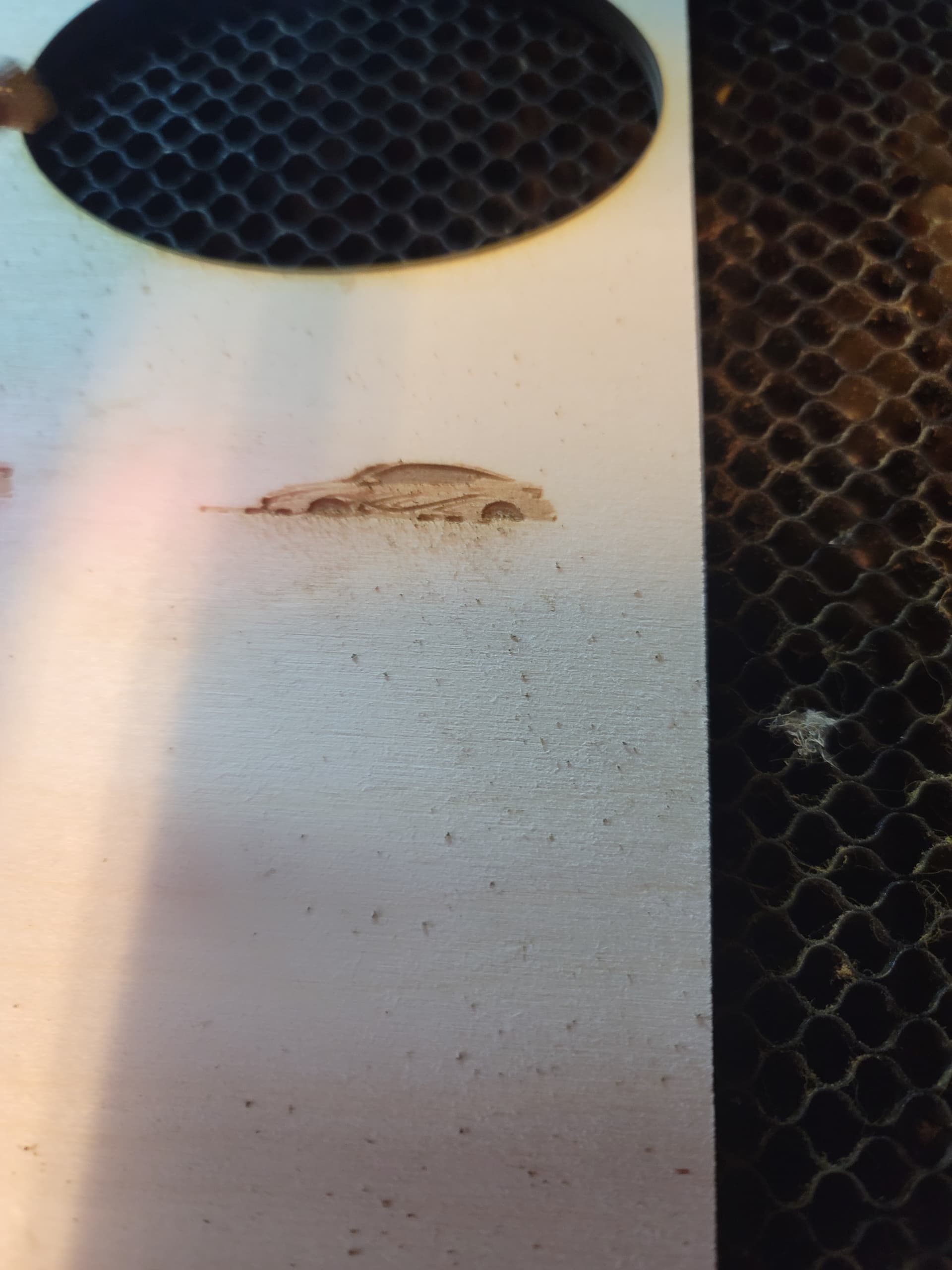

My first post. I have been having issues for a while with images. I’ll run the file and everything will look good until it reaches a certain point and the engraving will start going sideways, not in the intended area. It’s very random, I don’t know why this occurs and oftentimes I’ll restart the same file with the same settings and it will come out perfectly. Any ideas or suggestions would be appreciated. Thanks!

I’ve had it for 6 months. Started doing this randomly within my first few attempts at doing images and it’s never stopped. It’s not often enough for it to be a big problem but it is often enough for me to get annoyed with it. I’d say it’s 1 out of every 20 engravings has this issue. Talked to the guy who built it for me, he seems to think it’s a signal issue. I removed any magnets or devices from around the controller except the laptop. It could be the laptop I suppose. Guess I’ll try moving it somewhere else and see if that makes it stop.

It appears almost like it’s loosing steps, but it recovers, as it appears in the first shot. General rule, they loose steps, they can’t recover, requiring a homing cycle…

Once the job has been sent to the controller LightBurn is mostly out of the picture for DSP controllers. Do you get a job preview on-screen? If it looks correct then it’s unlikely anything to do with USB.
You could try transferring through usb thumb drive or ethernet to rule it out.
It might be that your stepper drivers are overheating and skipping steps. Try slowing down and see if it improves.
Pretty sure it was signal issues from devices near the controller. I moved my laptop after i made this post (its in a stand right next to the controller where I set it up when i first got the machine.) Haven’t had it happen since except the one time i accidentally put my phone on top of the controller. Weird but it seems to be solving the issue.
