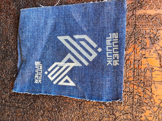

Immagine specchiata
Are you marking denim with your laser?
Please tell us more about your process.
Ho cambiato PC, entrambi hanno Windows 11
E stessi parametri e aggiornamento lightburn.
In test vedo la lavorazione corretta in effettivo l’immagine risulta specchiata in verticale mentre il testo è specchiato in verticale, inoltre la potenza è più bassa.
I changed PCs, both have Windows 11
And same parameters and lightburn update.
In testing I see the correct processing in reality the image is mirrored vertically while the text is mirrored vertically, furthermore the power is lower.
That looks crisp
On each Windows 11 computer, open identical project files and select File, Save GCode and select different file names for the output but the same .txt suffix.
These files could be huge so please just attach the files by ‘drag and drop’ into your next reply.
If you post both GCode files here I can confirm the parameters are identical or offer an explanation of why they are not.
Often ‘mirror images’ or ‘images reversed’ along an axis are caused by the Origin in LightBurn being selected opposite (along that axis) to what the laser engraver needs.
Switching units of time (like mm/min to mm/sec) is the largest contributor to unintended changes in power output.
