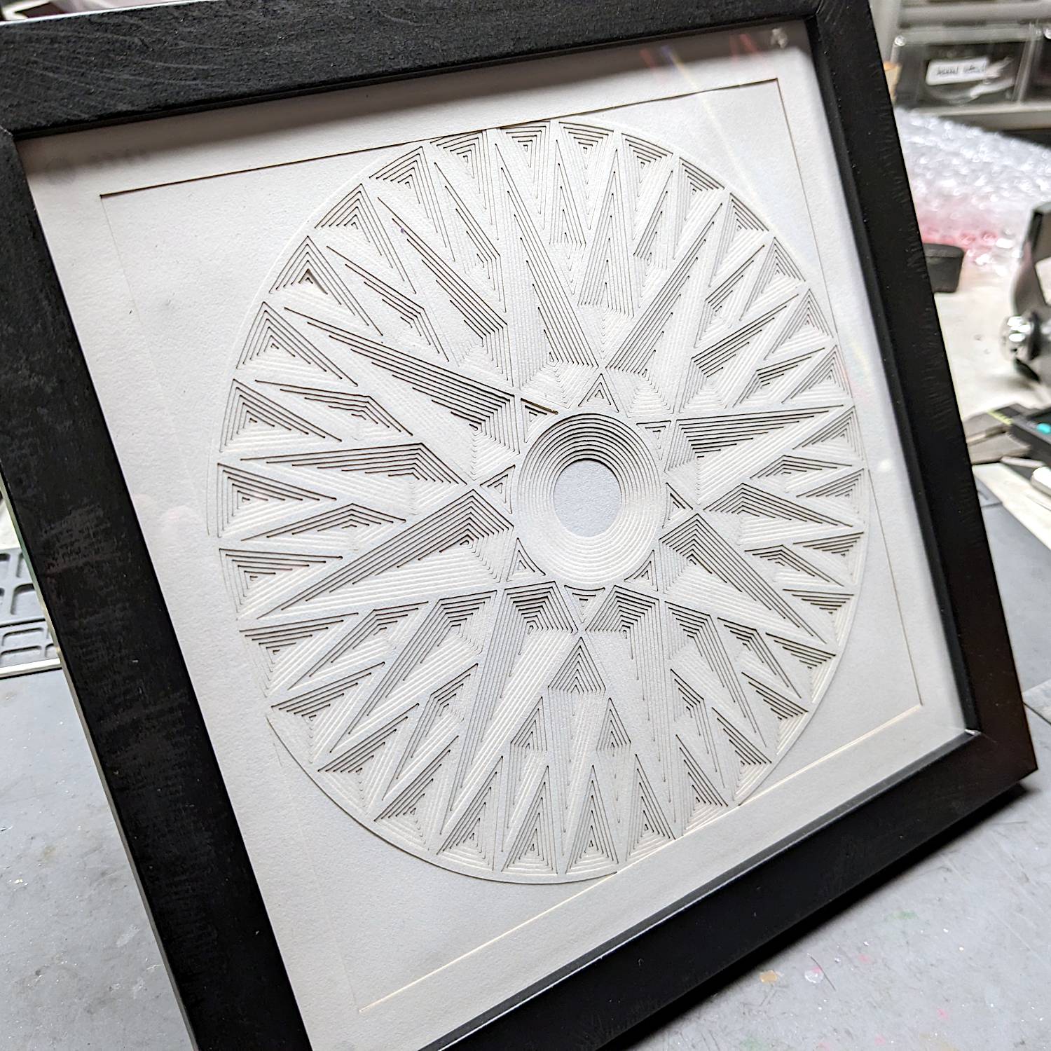

I (re)built some of Beyer’s classic designs in layered paper with LightBurn …
Mariner’s Compass :
Pyrotechnics:
Chimney Swallows:
Deriving related patterns is straightforward:
Inset Mariner’s Compass:
A ghostly version:
Once you (well, I) get the hang of working with the pattern’s symmetry, each of those uses a surprisingly few simple shapes and LightBurn tools. :grin:
Thanks for the inspiration!
