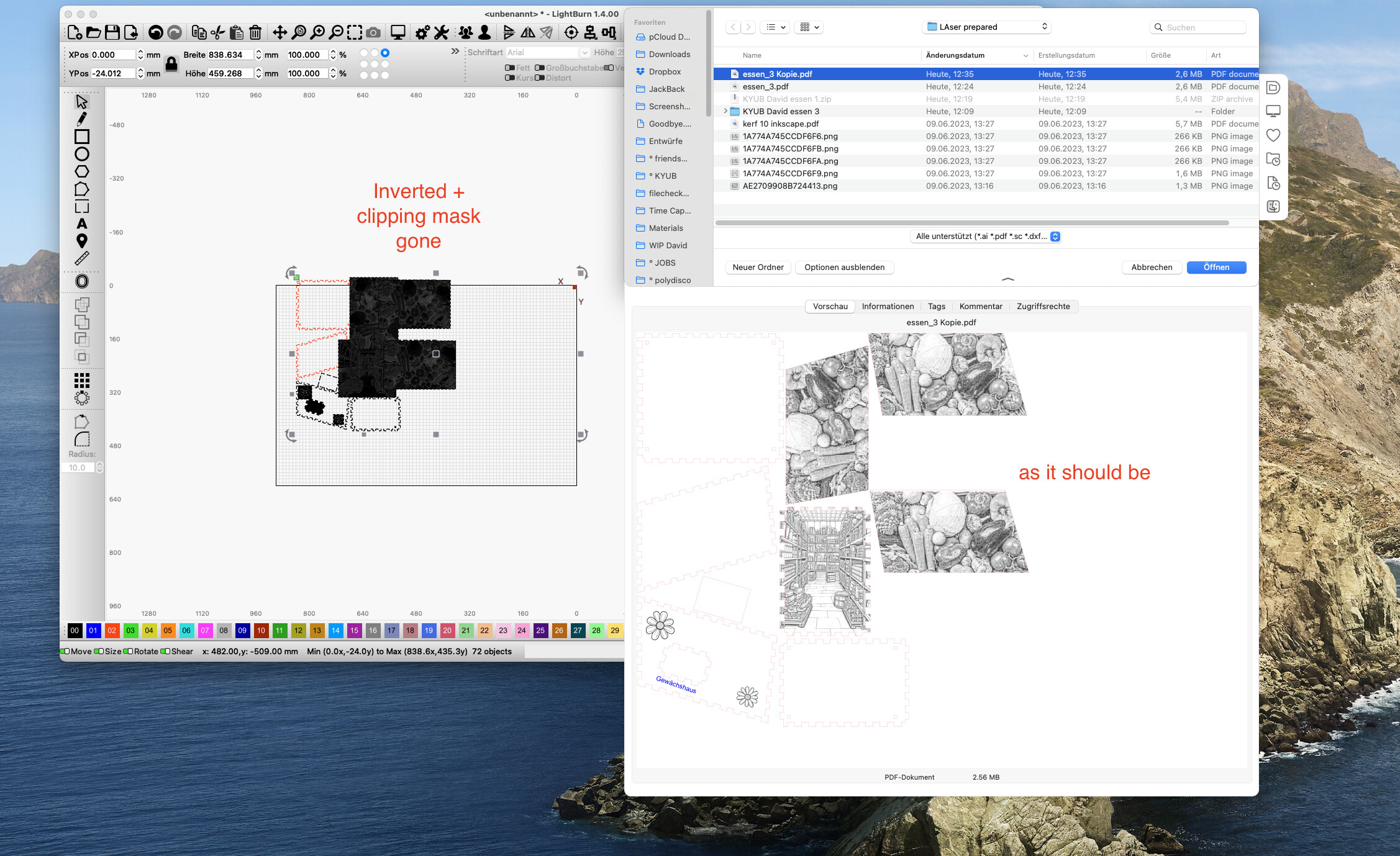

I have a problem that all PDFs get imported with inverted images,
I found out in the forum that I can hit a checkbox in the engraving settings to invert again,
unfortunately with no preview in the editor.
That’s not practical in daily work if you don’t want to waste material on a regular basis.
I have been really happy with lightburn due to it’s useful editing tools that avoid going forth and back to Illustrator in many cases but since I had the first job with engravings I always run into problems.
SVG clipping masks are not recognized, neither are those in PDFs.
If the image is just cut by a rectangle, it’s not to bad to make the fix by cutting it in lighburn, but for irregular shapes it’s very annoying.
Will file compatibility be added in the future?
the other question: how can I prepare a PDF in a way images are not getting inverted.
I found a post that said re-save it with mac-preview. Unfortunately that didn’t do the job for me.
Any further information on how I can make sure PDFs get recognized in a way they are showing up in any other program?

With this I mean that the “invert” setting in the engrave settings is not represented in the editor.
This is basically true for any file and probably a behaviour which was decided upon.
I guess it would make more sense to show the invert setting in the editor.
My workaround for the clipping mask problem was to export my whole work area as one huge bitmap instead of several images inside clipping masks, which means a lot of white in the image.
forgetting to uncheck the invert setting the laser will just start to engrave the whole area black, potentially ruining a complete sheet.

Open it anyhwere outside lightburn and it will display the way it should.
I wont deny that, it works pretty well. However Illustrator is the most common software for vector graphic design, it can handle bitmaps and it would make sense if layouts prepared in Illustrator would just work in Lightburn. I really like lightburn a lot, but clipping masks worked in any other laser software I have used before (like Jobcontrol, Visicut, Universal laser print driver) based on that I guess it’s possible to just implement them.

Would you be willing to test importing your .ai file into LightBurn instead of the PDF?
The original file was a SVG.
I tried to convert it in Illustrator to PDF to see if clipping masks would be accepted that way.
If I save it as AI the pictures do not get inverted
The Devs are looking at this. Are you also willing to share the .ai and .svg files?
