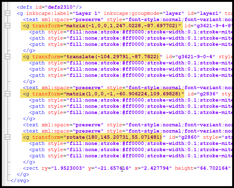

I have uploaded a Inkscape SVG file that shows the problem. Note that the H objects shift with respect to the bar objects when opened in Lightburn. In Inkscape all the objects have the same stroke width and there no double objects. However, when I upload the file to the forum the H objects appear to have a thicker stroke (?).
I am assuming that LB doesn’t like the transforms in the SVG file.
If you select everything in Inkscape, and then Path>Object to Path - and then export another SVG, it imports correctly into LB

Selecting all and turning objects into paths worked. I am still scratching my head trying to figure out how I formed the Inkscape file so that happened. Thank you for your help and time!
Apparently Inkscape and LightBurn disagree on how some scale factors work, as I found out while making Old School punched cards by generating SVG files with a Python program.
The only way I could get the same layout to work in both programs was to switch the offending scale factors according to the SVG’s destination.
Perhaps the Inkscape files include a transform / scale / group that LightBurn interprets differently.
