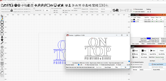

First timer here. Sorry if this has been asked many times before. I can’t figure out how to fill this imported text and lines. I’ve searching for over two hours and I’m not any closer. I already have it as fill and already determined is not my machine settings. ny help would be great.

It is actually doing what you asking
Notice you have 2 lines per “wall” of the text
So is filling in between
Ungroup, remove the inner lines and you get
All of the objects are duplicated, so LightBurn can’t figure out what to do.
Ungrouping the whole thing, then clicking & dragging on various parts:
They’re not exact duplicates, so Delete Duplicates doesn’t help; it looks like it will require some tedious manual rework.
As @gilaraujo has discovered there are actually two outlines to each letter/shape. They’re not exactly the same so ‘Delete Duplicates’ doesn’t work. As mentioned you’ll need to ungroup and delete the unwanted duplicates.

Thank you all for your quick assistance. On my end I didn’t notice any lines and that’s why I didn’t think of that. But now that I’ve ungroup, at least I’m getting somewhere. Not being able to do it as well as @Marcus_Wakefield, but getting there.
I made a small mistake with the one I screen-captured above. I missed outthe horizontal bar below the word “TOP”. I’ve attached a version with the two outlines separated and placed on different layers so you can see them better.
OnTop - Separated.lbrn2 (97.5 KB)
Once again… I can’t thank you guys enough. I was able to delete the extras that were causing the issue and was able to send it to my machine.
