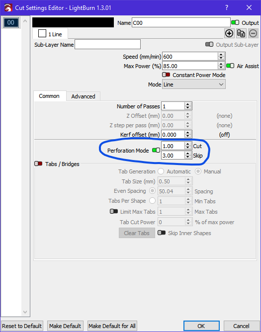

When I import a pdf or svg, designed in AI, the design gets changed. The punching holes for my leather change into a line instead of a cirkel of holes. I have tried svg, pdf, all the same. When I first look at it in Acrobat reader, it looks correct.
I don’t think the linetype information is used by LightBurn but there is a way around it. If you make your stitch lines in AI a different colour, LB will put them on a different layer to the other vectors. You can then set the ‘Perforation Mode’ to on.

Hi Marcus. I got in contact with the designer, and she knew what was happening. In Illustrator, when you make changes, before exporting the file, you need to select “Expand Appearance”. Effects that haven’t been expanded look weird in other software. It is solved. Thanks for trying to help Marcus !
