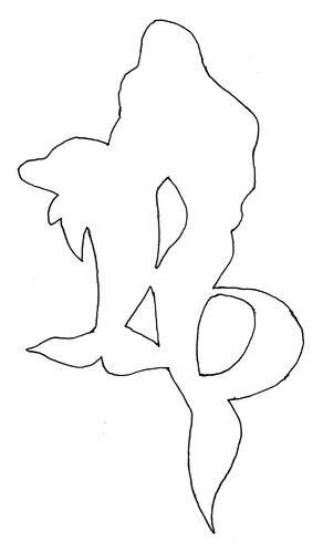

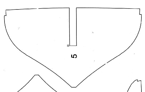

I imported this outline scanned from a plan,see picture 1. When I trace the image I get a double line as seen in the picture 2. The breaks in the line mean I have several shapes. I can cut the shapes so the inner line is loose, as picture 3, then delete it and patch up the joins but I wonder am I missing a trick that would make this easier?

Zoomed in at a break
Use the offset tool to scale up (closes gaps) then use the offset tool to scale back down.
That’s due to LightBurn not having a “center line trace” function. A previous discussion covers some alternatives:
Because the image started as a scan, tweaking the Threshold level may improve the Trace results. However, it will also increase the number of random speckles, which will eventually drive you crazy.
I use GIMP to pre-process scanned images: clean them up, blow out the contrast, and generally simplify things for the Trace operation.
For closed shapes like the ones in your images, you can use GIMP to fill the interior with black so LightBurn can Trace a single line around the perimeter.

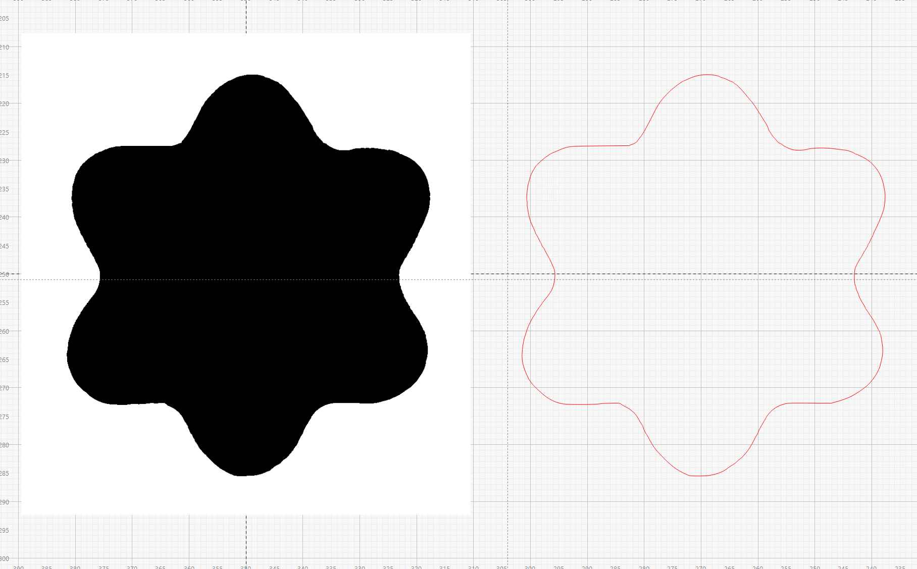

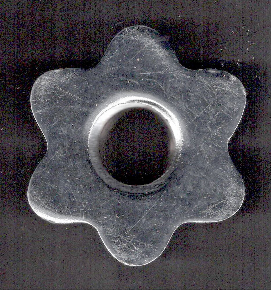

For example, start with a scanned image of a dumbbell nut:
Blow out the contrast, then use GIMP’s Scissor Select tool and some manual cleanup to convert it into this filled mask:
Your images start with much higher contrast and will be much easier to process!
Although I used it to get a solid model for 3D printing, LightBurn will do what you want:
For me, using an image editor to process images works better than trying to force LightBurn into doing the entire job.
Those gaps in the original are easy to see, and fix. Use MS Paint to fill in the gaps with the Pencil Tool. You will then get a nice separation between the inner and outer loops. Delete the inner loop. You can then use the Offset Tool @JimNM mantioned to smooth it out. Do an ouside offset like 1mm, move it to another layer, then do an inner offset 1mm to get back to the original dimensions. This will be your working path.
Why don’t you just rebuild the shape from scratch. It took me about 10 minutes to make it symmetrical.
