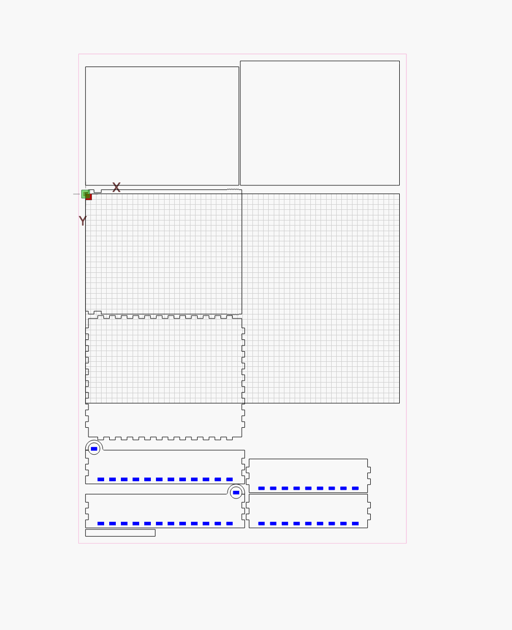

“Technical drawings” must be saved “specially” if pdf is used as the file type. Can you post an example here? (change the pdf extension to txt to post it.
You can try to import my file and see if it is a different / usable pdf format to be read by LB.
Puzzlebox.txt (13.4 KB)
I’ve unsuccessfully attempted to post my file here as you suggested. What do you mean by saving a pdf “specially”? What I’ve done is scan a pattern into my computer and saved as a pdf. Is this wrong?
Your file opens up as total gibberish.
ok, the txt ending must of course be changed to pdf again to work, I thought it was known, sorry.
the result should look like the picture, I downloaded it myself and changed the ending and imported it into LB
