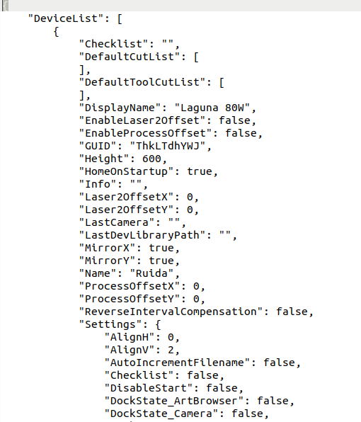

Look at them with a text editor… they are just flat files in an XML format…
Yours seem to be ok… I copied this out of my editor…
It looks like it’s transferring OK…
