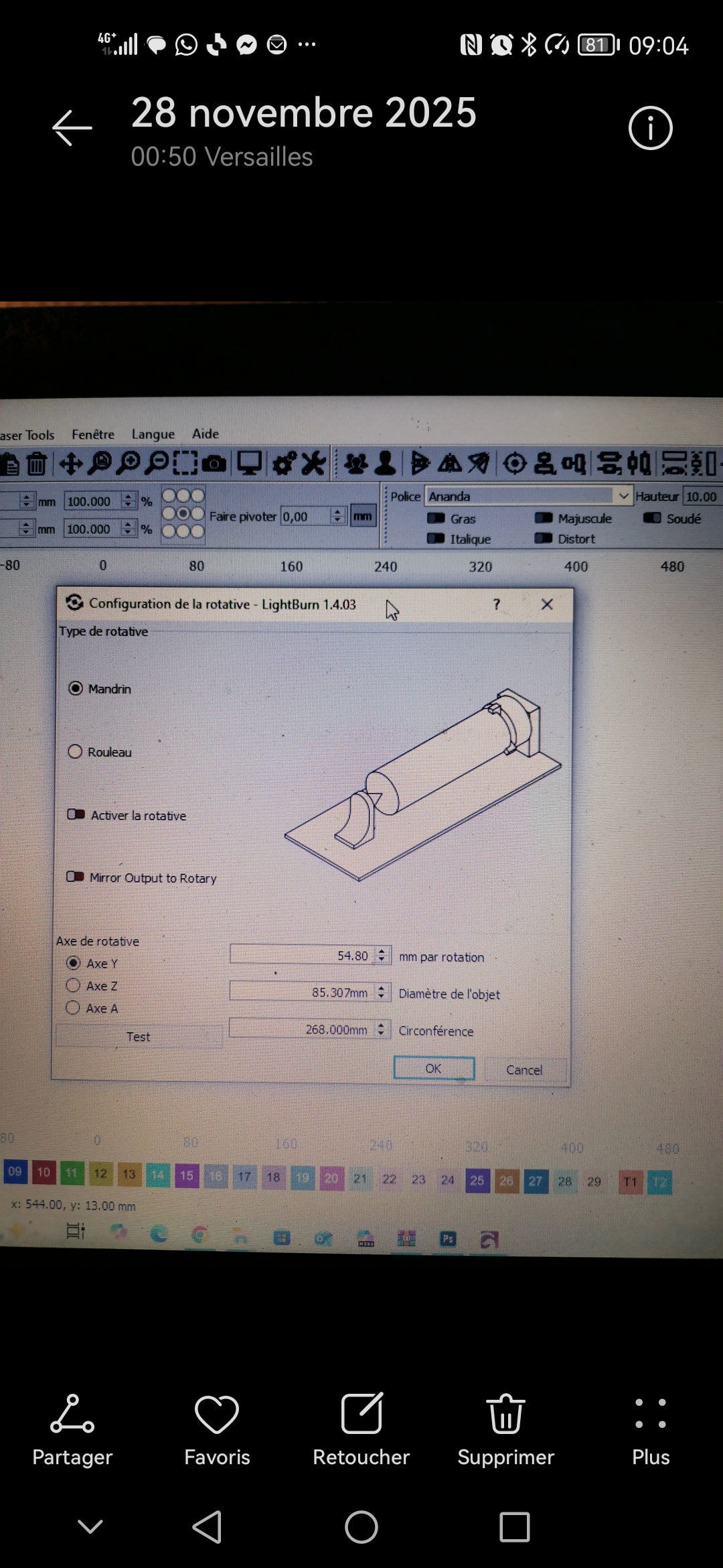

Sur lightburn, j’ai sélectionné “mandrin”, “active”, “360 mm/tour”, “80 de diamètre”.

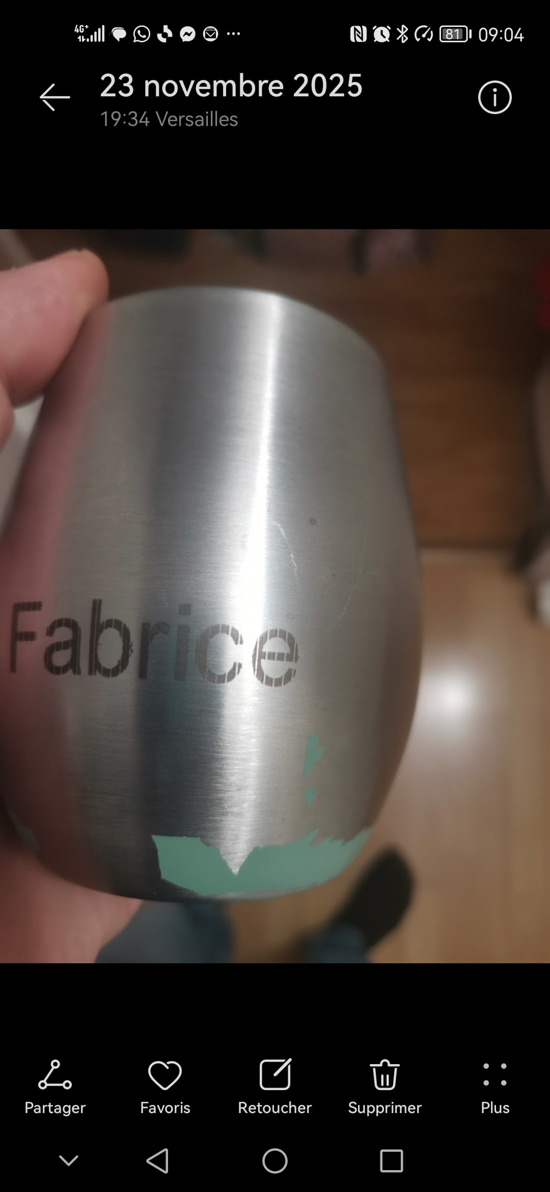

Par contre j’ai un trait régulier non gravé comme si le moteur pas à pas allait plus vite à un moment.

Trying to provide a solution without seeing the problem at hand is a shot in the dark. However, just recently someone complained about an identical problem, and it was due to excessive speed.
If possible, posting an image of the problem and a screenshot of the recording settings always helps to understand the cause of the problem.

Je te mets mes réglages et ce que donne la gravure, la gravure est hachuré régulièrement.
Les paramètres de la rotative sont bons je pense. Quand je lance le test le verre fait bien 360 degrés, si je diminue les mm par rotation je ne fais plus le tour complet.

If I understand correctly, the number of rotations per mm will have to be a fixed value for the part you are working on and only changed when you change the diameter of the part you are working on.
The settings to be changed after that step will all be in the “cuts/layers” window.

C’est tout à fait ça, j’ai essayé tout ce week end même en changeant des paramètres rien ne change. j’ai toujours cet intervalle régulier sans gravure.
On dirai que la rotative tourne un peu plus vite par moment.

In your previous picture you didn’t have the rotary enabled:
Well,… although I don’t see how it could interfere with the problem, it’s a great observation!

La rotative était bien activé

Sorry to step in, but this is not correct.
The mm per rotation settings depend on the motor and stepper driver combination, and the firmware settings for steps per mm.
LightBurn uses this value to tell the rotary to rotate 360 degrees.
We don’t know yet how far this one rotation moves the surface with one rotation.
The actual distance (size of the slices) is defined with the Object Diameter (or circumference).
Let me explain: If the rotary is not enabled, LightBurn thinks it’s controlling the Y axis of the laser, even when you attached the rotary to the Y-Axis motor.
