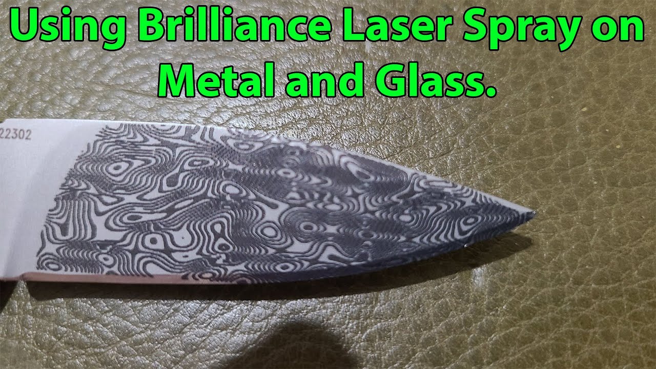

A less durable alternative for your existing machine would be to use a marking medium such as Cermark or Brilliance Laser Ink.

This is an excellent video that shows what can be REALISTICALLY accomplished with a machine like yours.
Same gentleman doing some testing.
Outside of this, things get iffy real fast for diode users. With current hobby grade machines, metal work is really best suited for fiber machines which start around $3000 and go WAAY up from there.
