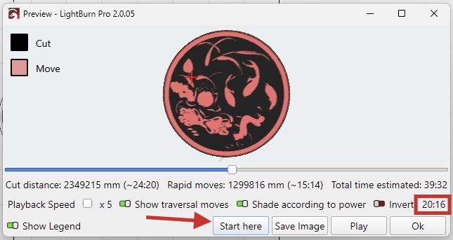

That’s correct. LightBurn is streaming those jobs to the Galvo controllers over USB on the fly. Unlike RuiDa controllers, we can’t store the entire job on the board.
Thing is, if you pause a job and power-cycle the laser, LightBurn needs to reconnect, and this only works if you stop the job first.
This here also works for Galvo lasers:
There’s no “automated” feature for this, but if you note the exact time when you press stop, you can move the slider in the Preview and start from there.
