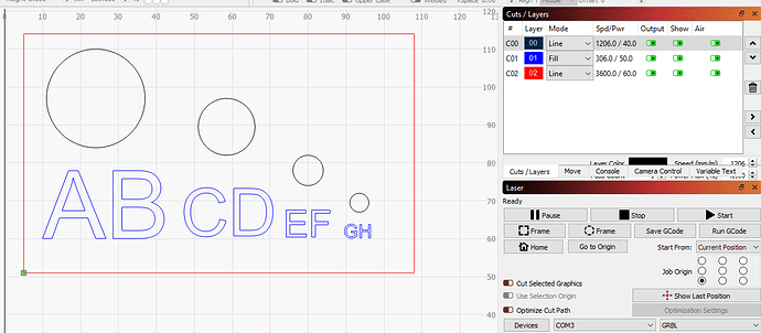

Here is my “project” as you can see, time to time outwork is fine and for example the last one, “lorem” is perfect, however circle looks like I did them mysel as 3y old. Plus check some text how is “flat” on the begging…
The laser was on sale, should I look for issue on the motherboard, is there something I could setup to avoid this occurances?

Seems to me a belt issue on the Y Axis. Tighten your Y belts and make sure your machine axis are square to the frame
Thank you for speedlight answer! I thighten Y on the maximum, seems taht it help but still experiecning more oval as circle. Could you be more spicify/share yt video what you mean by machine axis squrate to the frame?

This si significant result! Hwever you can see some inacurracy on the lastone, what do you recomment, tight all belts little bit more? The Y is on max.

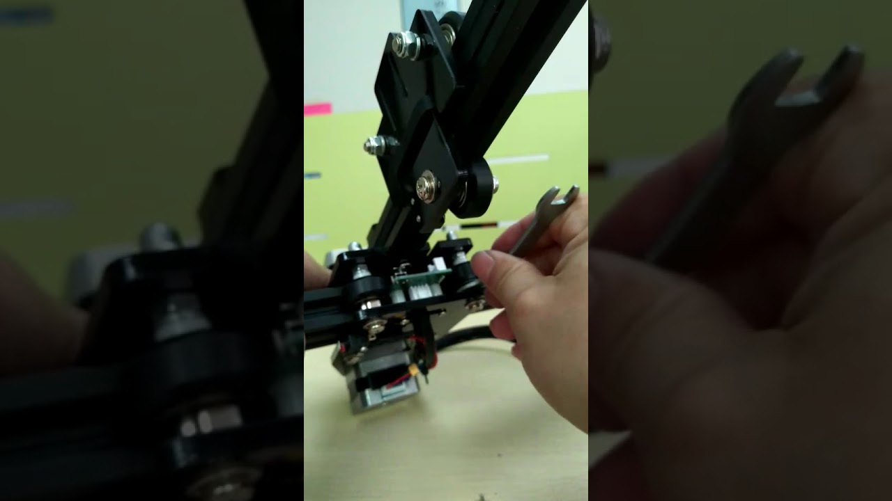

The Ortur LM2 has eccentric nuts (behind the wheels) these move the wheels closer or further from the gantry.
On the LM 2 the laser will move freely if the unit is tipped more than 45 degrees in any direction, if there is binding it could be Belts too tight or not tight enough, some wate material under the belt causing the wheel to skid, or eccentric nuts causing the wheel to bind.
Thank you, I give a try!
// I tired to… what do you think guys? :slight_smile:
Looks good. Hope you’ve got it all sorted now.
You right, I got a chance to play with with wheels and now its seem serious. Im not sure if its not tight now (it need a pressure when I move it manually) but when I turn LightBurn its work perfectly… Thank you guy for help!
