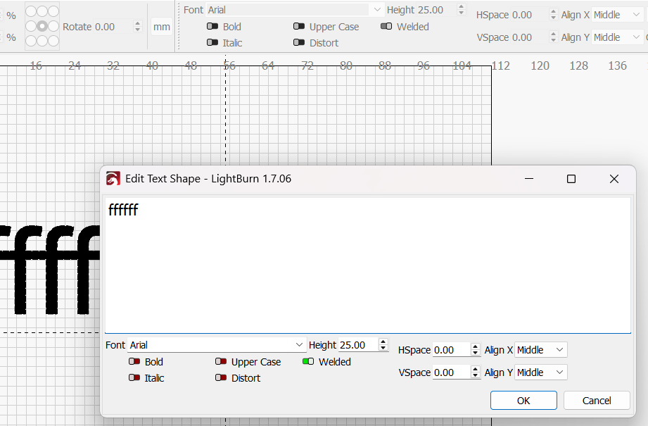

When I have MM selected, the Edit Text Shape window appears to be reporting inches. The font was supposed to show 10mm instead.
Also, when using the measuring tool, it seems to default to inches even though MM is selected in the MM button at the top.
Do I have something set somewhere else that is forcing inches to display?

The workspace grid is set to Inch mode and I think the workspace-related windows track that setting so the units match.
You can change the Numeric Edits and Measure tools to use / display millimeters while tinkering with a specific object, but those don’t affect the workspace.
I think it’s like that, anyway.
Can you post a screenshot like the above but also including the size boxes?

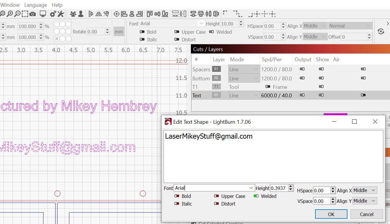

Yes, I see the workspace scale is in inches, although I have MM selected. I need to go back and figure out why my scale is not in MM. :flushed:
I am using “mm” scale, and if I change to Inches the text box changes too.
Win 10 Lightburn V1.7.03
I just opened the same file that had the scale wrong, and it showed MM for the scale markings.
I switch between MM and IN a LOT, so this may be difficult to repeat. However, I am now aware it can happen, so I will be watching for it. :nerd_face:
The Workspace grid units are different from the Numeric Edits units, so you can mix-n-match if your head is less prone to exploding than mine. :grin:
The grid units come from Edit → Settings and are pretty much set-n-forget (in millimeters for me, anyway).
The Numeric Edits units come from that pushbutton, but switching affects only the fields in that tool. It starts out matching the grid.
The Measure tool units are independent of both of those, although the units starts out matching the Workspace grid.
So (I think) what you see is what you should see, given the Workspace grid setting.
