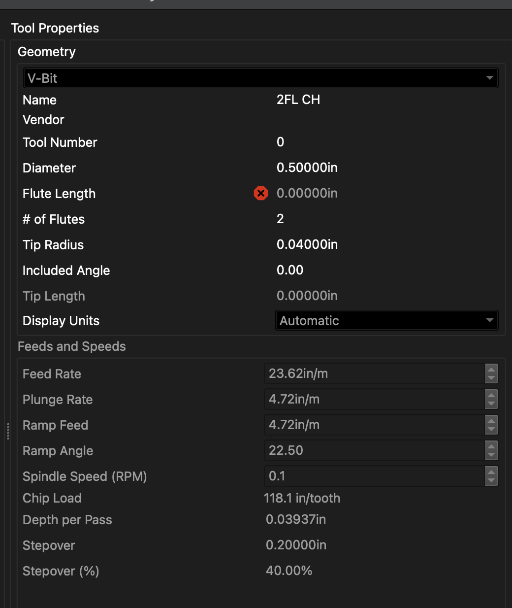

I failed to set an included angle for my chamfer mill (V-bit). It generated some g-code that had a very bad failure mode. The tool path generated sent it to Z- which would have been catastrophic. I wasn’t running anything (just checking the generated g-code, so maybe it would have not sent it to the machine.

It gave me a few weird error dialogs, but the one that made me check the tool definition was something about having zero tool length. Made sense once I saw the included angle was 0. Perhaps a more appropriate default, like 90.

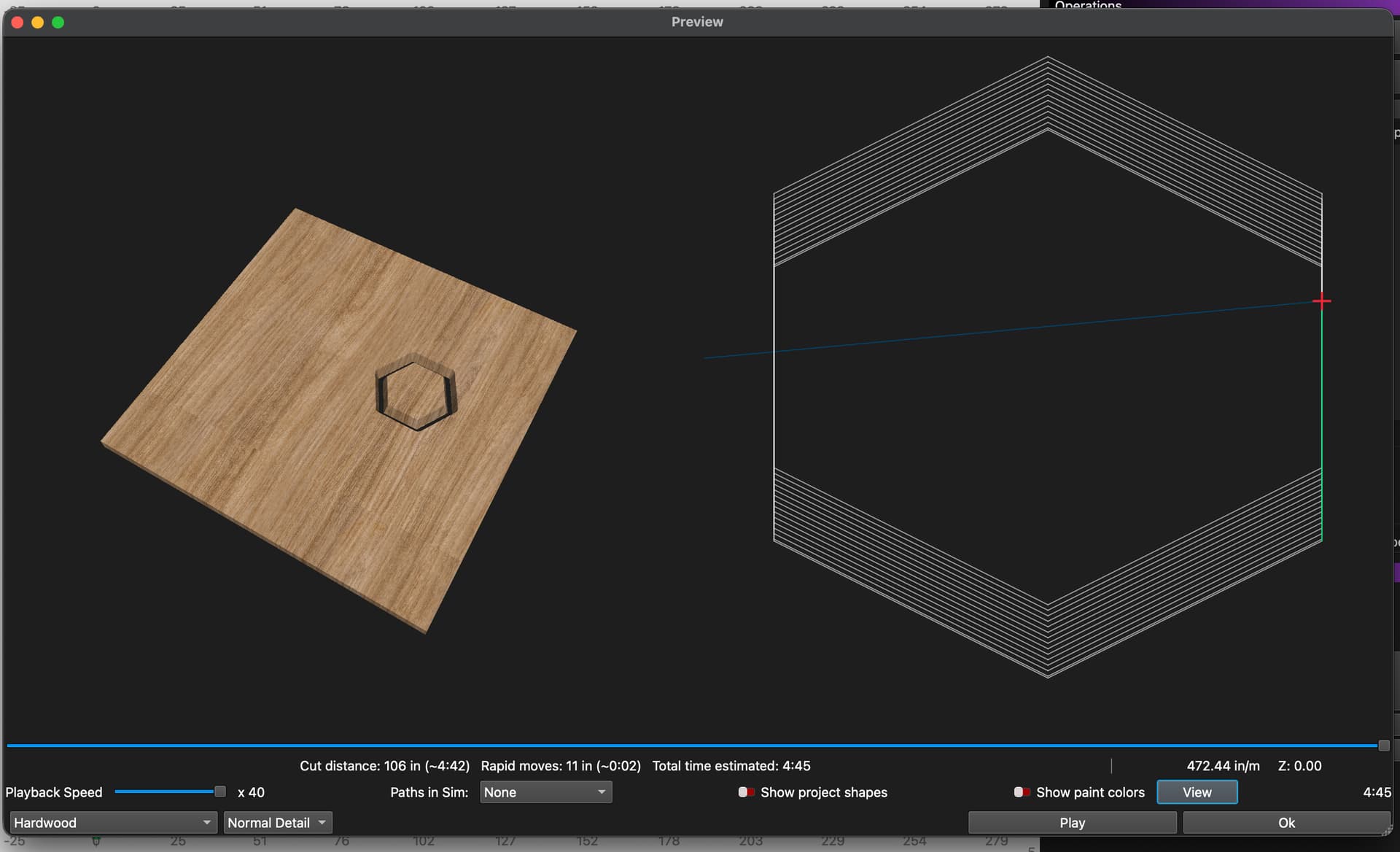

After creating that file I tried to Preview and it froze MailMage. I had to Force Quit the app. Once I fixed the included angle on the chamfer mill, it previewed without issue.

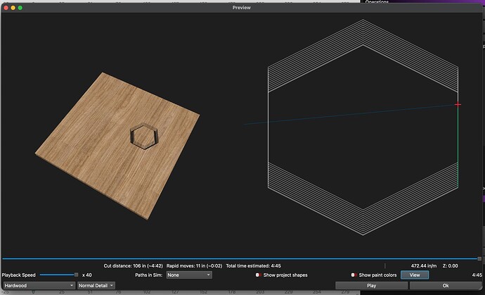

The tool that is defined for the chamfer op has 0 set for included angle.
Which produces the spurious gcode.
If you change this to say, 30 degrees, the code previews beautifully.
To edit this, go to CNC Tools > Tool Library > Select the tool, then click the Edit pencil, and enter an included angle on the tool.
This should be a warning when generating the GCode, I would think, so I’ll poke into that detail, but if you’re getting a bad or no preview, check that your tools are defined fully in the Tool Library.
